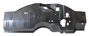

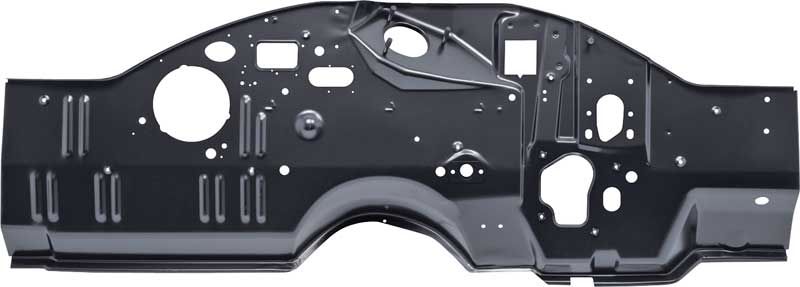

As far as I know, a non A/C heater box will not fit an A/C car, the firewall is different. The non A/C heater core will not work in an A/C box either.

Some of the fastening holes along with the heater core holes are in different locations between an a/c heater box and a standard heater box. Plus you'll have a bunch of extra holes in the firewall should you go that route.
Bottom line is that it's not a simple swap at all.

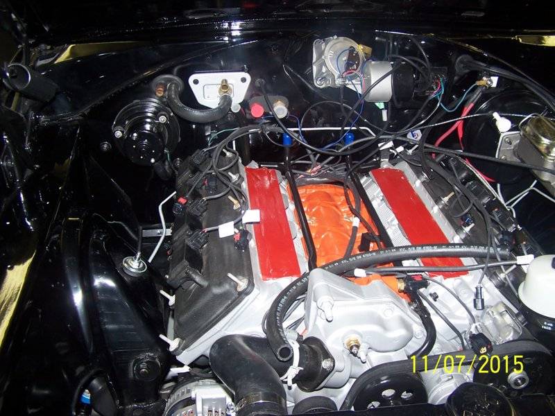

If you only want heat and will not be using the A/C you can eliminate running the water through the A/C heater valve but you will need to install some sort of water shut off or you will have heat all the time. The heater core itself really don't care which way the water flows. If you will be using the factory A/C water valve, you should hook the hose from the water pump source to the top nipple on the water valve and the bottom nipple to the heater core nipple on the right. The left nipple would then be routed back to the engine. Here is a pic of the way mine is routed although my engine has a different set-up than yours.
