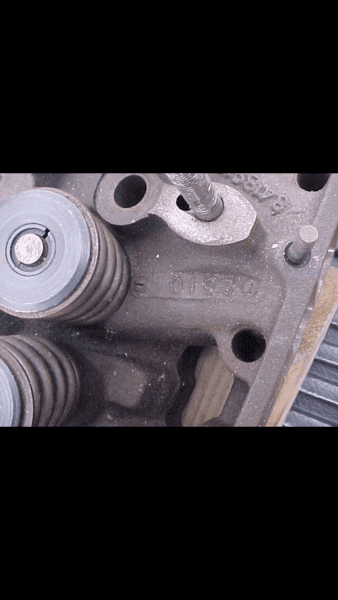

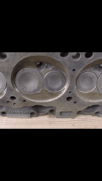

I haven't run small blocks in YEARS, so maybe ask Rumblefish on this site. MAKE SURE TO CHECK THE CASTING NUMBERS to make sure you know what you're buying.
"J" heads refer to some very good small block heads used on 70 340 six-pack, 71 340 & I believe 71 360 motors too? They have larger valves and are very desirable. "915" heads refer to closed-chamber BIG BLOCK heads made in 1967...so be sure what you're buying. Check head casting numbers.

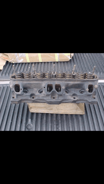

A few pics:
Don't get carried away with J or any other small block mopar head
you have 318 style and 340 360 style ports and a couple of valve size choices- all obsolete
are the guides bronze or just knurled?
new seats? what materiel- it does make a difference
springs have dampners- that's a clue

Well. I see 2.02/1.60 J heads.
The ‘78-360 will noticeably wake up from the 318 heads you have now. I’d do it. $400 isn’t so bad. They will flow around the 190/200 cfm area.
They will lower the compression ratio of the 318 some. But the good news is you will gain power due to better flow over the 318 head even with larger valves. Fully ported 318 heads (expensive) work better.
