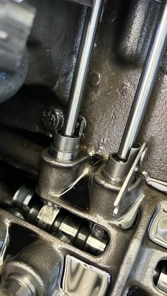

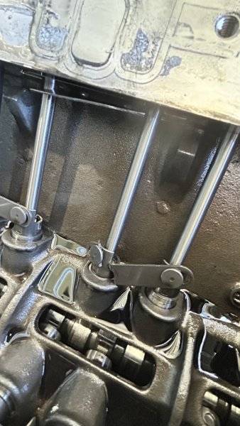

Well the passenger side wasn’t good either and I’m missing a piece of metal. Cams junk and who knows what else. Drivers first with pics and then passenger side. I knew it sounded loud on both sides. Would a lifter bore issue cause this or are these hydraulic rollers just junk in these big blocks?
Holy crap sorry to see that. That the trickflow cam? Do you wind it up pretty good?
Crap, did you do a 100 foot burn out at 8 grand? Sorry time to pull and tear down.
