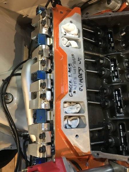

We pulled rocker covers off and inspected and noticed one of the lifters was not pumped up even though engine builder had primed it before giving it back to me.
After re installing the engine back into the car, re priming to pump lifter back up and following his run in instructions of 2000rpm for 4 mins, there was a fair bit of valve train noise, we re adjusted lash/preload and motor ran fairly quietly.
We drained oil and cut open filter and there was nothing nasty in there.
The engine had excellent oil pressure the whole time at around 80psi at 2000rpm and 70psi at a 900rpm idle.
The next day, started car up again and was running on 7 cylinders again so I pulled covers again and noticed 2 lifters were now no longer pumped up.

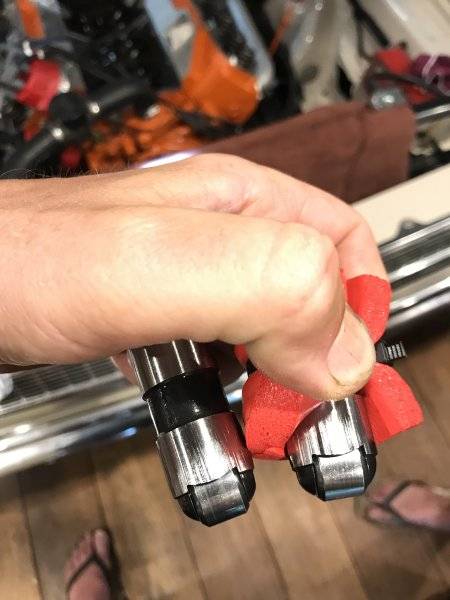

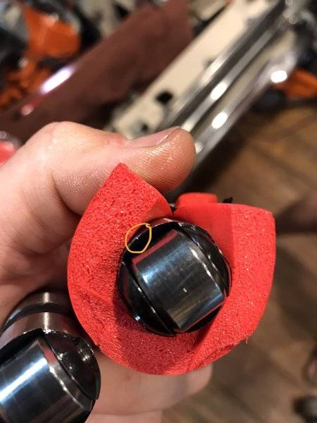

After pulling the intake, rockers, push rods and lifters, it seems that the problem is that the lifters are travelling too high out of the bores at full lift and getting caught. There is light scoring on the bottom 1/4 of most of the lifters consistent with their travel in the bores and some of the rollers now have rough spots when rolling. All lifter bores are fine, non have been re-sleeved.
Is there something that is being missed here? I can’t get onto Comp as they are closed but is there a lifter that has more meat further down that comes down over the roller a bit more like a Howard’s that will give more support in bore at full lift?
