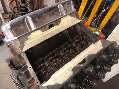

I have a FT hydraulic in Jigsaw:
...I have one in a 360 Dart, a 440 Power Wagon, a 72 Duster with a 360 that has a repro 340 cam....
All of them run strong but most are stock compression, iron head, soft valve spring medium performance engines.
