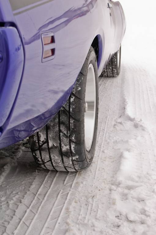

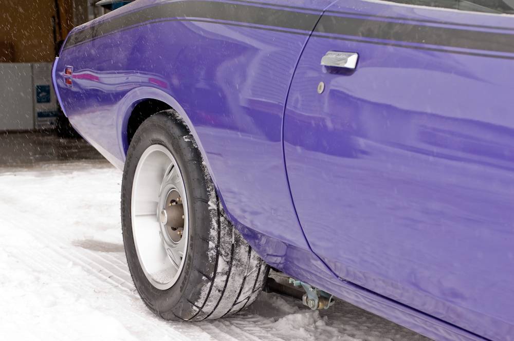

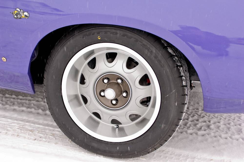

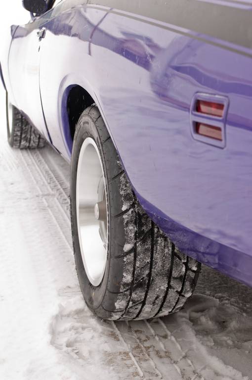

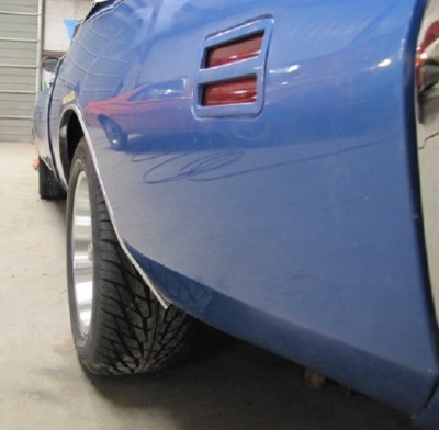

Yes. Nitto 450
I looked for a long time for a Ramcharger or an R/T hood but could not find one before the paint went on. I am still looking though!
Again...tires were just bolted on to check for clearance and how they looked. So tread pattern is not facing the correct direction.

Told you the 275 would fit in the back with room to spare. Looks perfect! Well almost. 295/45 would be more impressive!!!!!! ;)
Yes, you were right! I actually wanted 235/55/17 and 275/55/17 but did not want "suv tires". So once Larry gets the car done I may look it over and play with the ride height a bit before I have the alignment done.

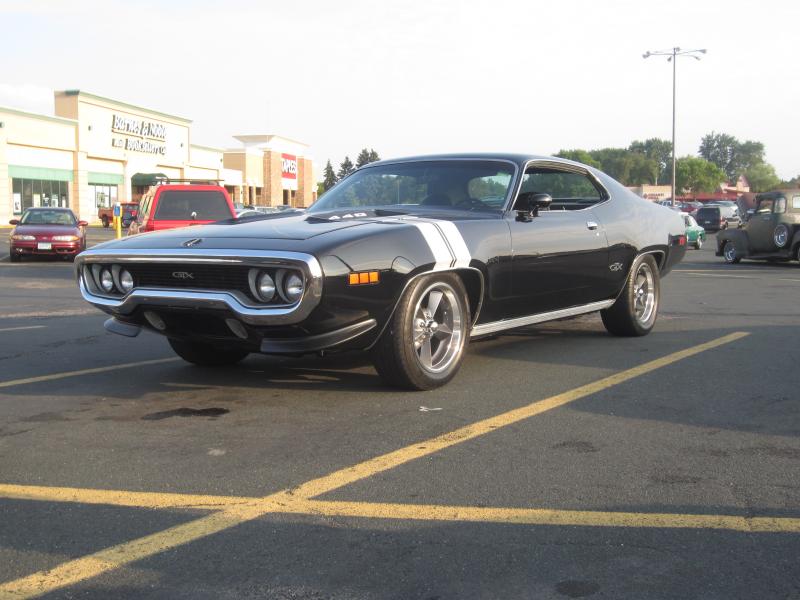

Wow...carcrazy I'm a big fan of your new YO Rallye's - they look killer! I'd definitely buy a set if I didn't just buy 17's for mine (or if I wasn't broke).
Like you, I have 50 series Nitto 450's out back on mine - fills up the wheel wells nicely.
My wheels are 17x8 MB Old School's with '0' offset on all corners
Rear tires are Nitto 450 275/50R17's (27.9" diameter)
Fronts are 235/55R17's (27.1" diameter) aka "SUV tires" lol

Thanks
The 235/55/17's are not the issue! I wanted matching brand and tread pattern tires on both the front and rear. So looking at 275/55/17...they were all listed as "SUV". The only pattern I could find that I liked was in the General Grabber line but they did not offer them in a 235/55/17 for the front. So back to square one I went. Heck 235/55/17 is a stock late model Mustang tire so there is a lot of options in that size. But the 275/55...almost nothing.
Haha I hear ya bud. I was nervous about the sidewall being too tall on mine (both fronts and rears) when I bought them, but they worked out well.
Again, your wheels and tires look awesome...I can't wait to see a '71-'74 Plymouth with the new Rallyes.

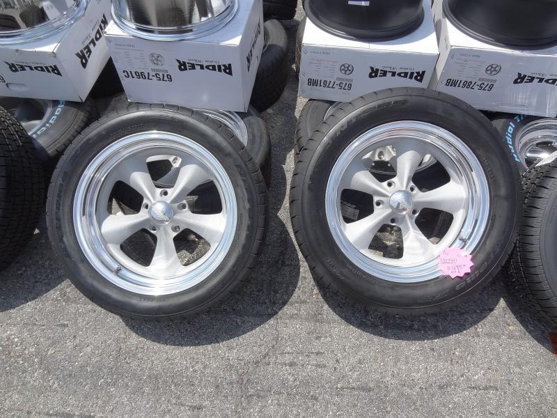

GTXplicity, I personally think your wheels look GREAT on your car! It gives it both modern and retro appeal. I actually was going to go with a similar wheel as you have. I just did not think it would look right on my car with blue/black top and light grey centers. If my car did not have a vinyl top I would have bought them.

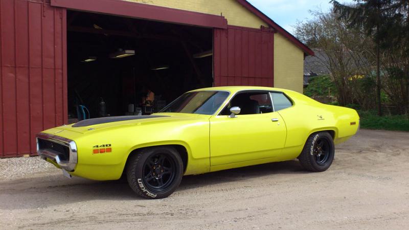

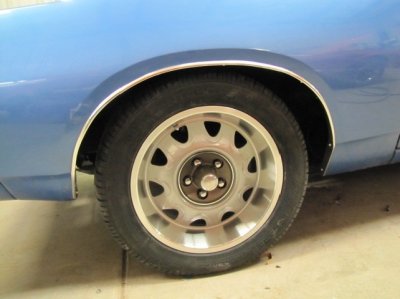

I have 17" Wheels on my RR too. I wanted something a bit more can-am road race looking and went for Black Wheels. They are 17x9 - 4" backspace on all corners. Tires are 225/50-17 and 255/50-17 Falken "performance SUV" tires :)
Wow, they sure look better than I'd expected, those Y.O. Rallies. Your car looks awesome, Carcrazyguy!
I have...... 17x9 - 4" backspace on all corners. Tires are 225/50-17 and 255/50-17 Falken "performance SUV" tires :)
Thanks for the compliment! Your car looks great as well! :yes:

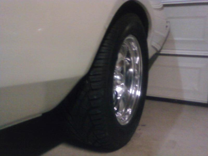

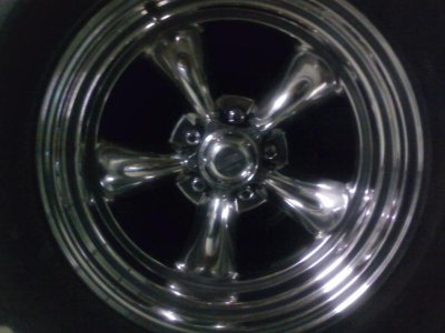

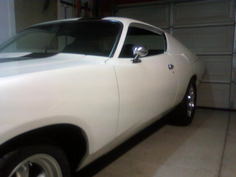

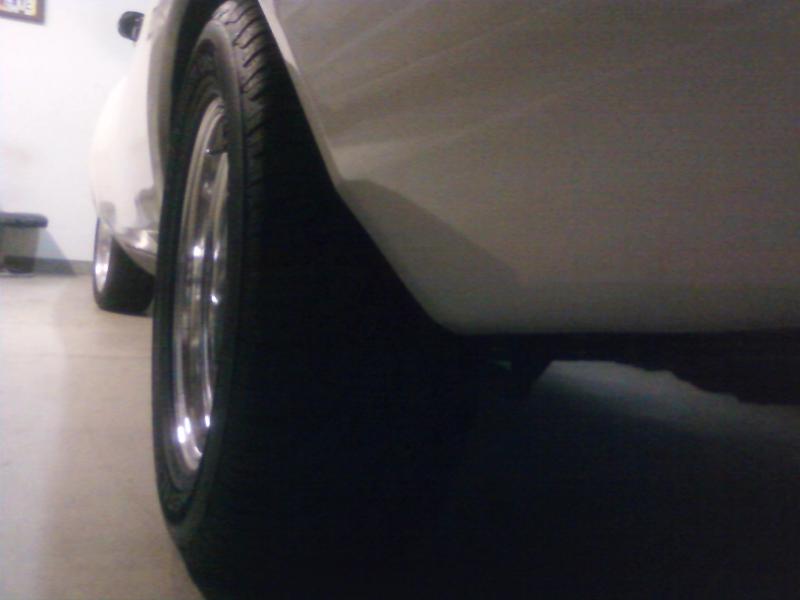

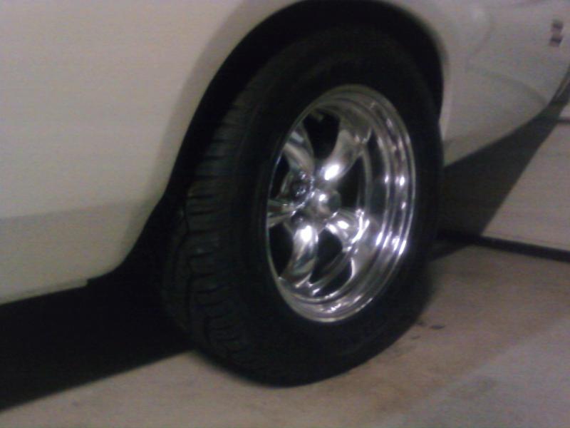

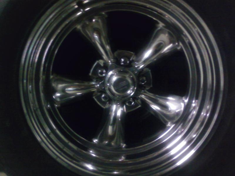

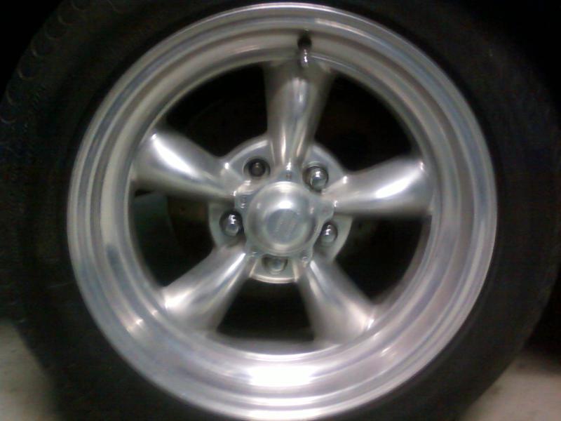

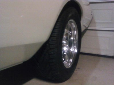

Mounted new rear tires today. General Grabber UHP (SUV tires) 275/55/17. Best looking tire I could find in that size. They fill up the wheel well niclely and fit inside the top fender lip. I went with these because they were the biggest tires I could fit on the rims that came with the car and can't afford new rims right now. Rims are 17x8 with 4 in backspacing. I wish the previous owner woulda got 17x9 with 5in of backspacing because I've got 2 inches of clearance on the inside to the leaf spring. Then I would have went with 295's. Also polished up the rims today. There were badly oxidized and dull. The results we're not too hard to achieve. I started out with just rubbing compound and my drill and that proved to be too much work and was wearing out buffer wheels too quickly. Step 1 was giving a good wash with Turtle Wax aluminum rim cleaner. It was the only thing I could find at Pep Boys with phosphoric acid in it. This got rid of most of the oxidation. Step 2 was a wipe down with Never Dull to get rid of remaining oxidation. Step 3 was applying a liberal amount of Blue Magic Metal Polish cream also bought from pep boys. Didn't really rub it in, just allowed it cake up and dry up on the rim. Step 4 was polishing with a cone shaped buffer on my drill. My cell pics are crappy but in person they do look chrome now instead of just aluminum.
View attachment 104120View attachment 104119View attachment 104121View attachment 104122View attachment 104123View attachment 104124
Holy smokes! They do look chrome! They look great - I might have to do that to my wheels...
That is the exact tire I really, really wanted for the rear. I just could not get a matched tire size for the front. I decided (my OCD) that I wanted to stay the same brand and tread on front and rear. But I think the 275/55's look great and are a perfect size for the 71-74 wheel opening!! Looks great!!!!

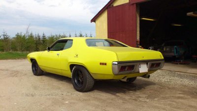

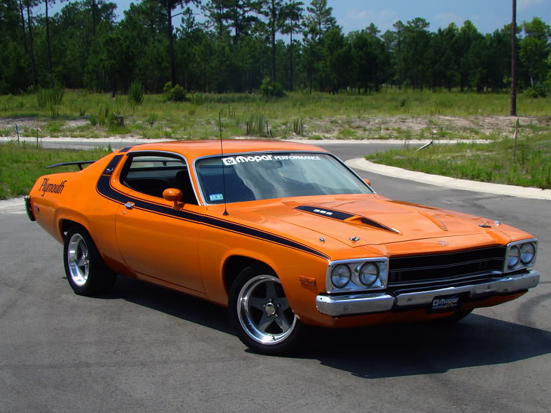

This orange car has got to be my favorite 70's RR on here. Perfect tire wheel combo and stance. Can we get some more photos from side and rear? What year is that car?
This is tattooedblue's car , hope he doesn't mind me adding his car and wheel specs :
Wheel are Torquelite, Aluminum 17 in. x 8 in., 5 x 4.5 in. Bolt Circle, with a 4.50 in. Backspace..
Tires are 255-45-17 and 275-40-17
I asked him for the specs last year as I plan on 17's as well - there are a few others here that run them and I'm sure they'll add info when they see the thread.
