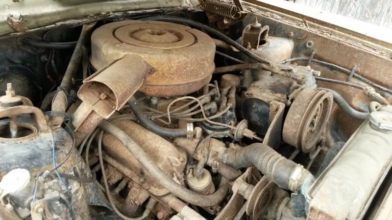

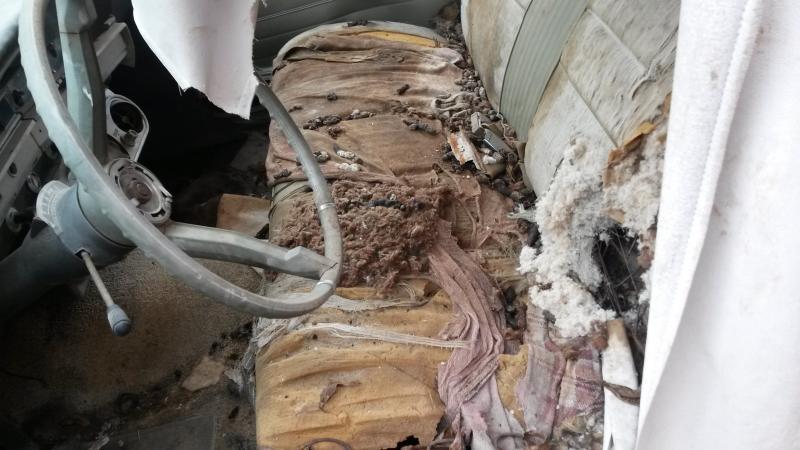

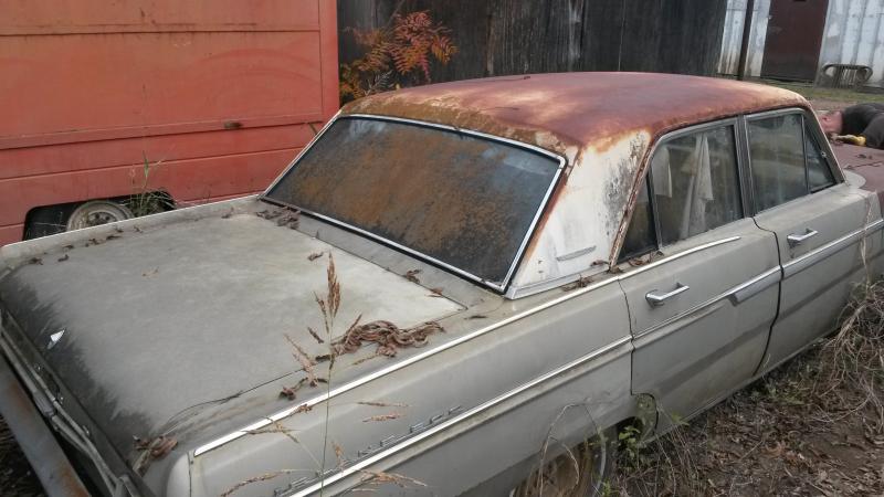

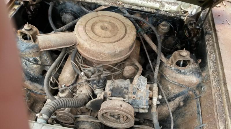

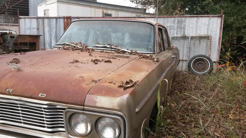

20131212_140203.jpg20131212_140247.jpg20131212_140349.jpg20131212_140521.jpg20131212_141519.jpg
What's that a Canadian Ford? The four headlights has me confused and I can't make out that long name above the quarter trim.
Will the engine, 260ci, 289ci?, turn over by hand? It sure has seen a lot of moisture sitting there...
65 Fairlane 500. From what I understand it was the only year of the front end. Its got a 289.
Yea south texas weather. Plenty of coon **** too. lol
I decided to pass on it. More then I want to take on without a shop.
I think you made the right choice ;-)
