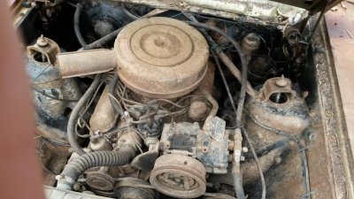

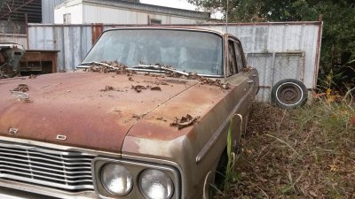

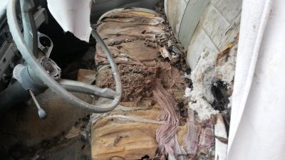

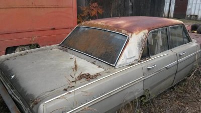

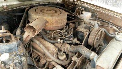

20131212_140203.jpg20131212_140247.jpg20131212_140349.jpg20131212_140521.jpg20131212_141519.jpg
What's that a Canadian Ford? The four headlights has me confused and I can't make out that long name above the quarter trim.
Will the engine, 260ci, 289ci?, turn over by hand? It sure has seen a lot of moisture sitting there...
65 Fairlane 500. From what I understand it was the only year of the front end. Its got a 289.
Yea south texas weather. Plenty of coon **** too. lol

Not sure I wouldn't pull the heads...depending on where it was sitting for so long....like in Galveston Texas. I've pulled 8 3/4 chucks out of cars and trucks that were in a junk yard just near Galveston and saw the effects of sitting for long periods of time. My place is 9 miles from Galveston Bay and have lived here since 63 and have seen the effects of cars that have sat around for many years. Some were not pretty. At least pulling the valve covers may tell me how I'd go about it....
I hear ya Cranky. The way I look at it is if you have to pull the heads you might as well figure on rebuilding the whole engine. If it turns over by hand without any resistance it might be fun to see if it will fire off, providing you have all of the elements. The thing that always concerns me is why did the previous owner stop driving it. Used too much oil? Rod knocking? Water consumption? When it was parked was there ample antifreeze? Might have a cracked block if not. There's lots of things to consider even buying a bare block...
