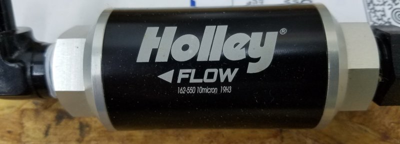

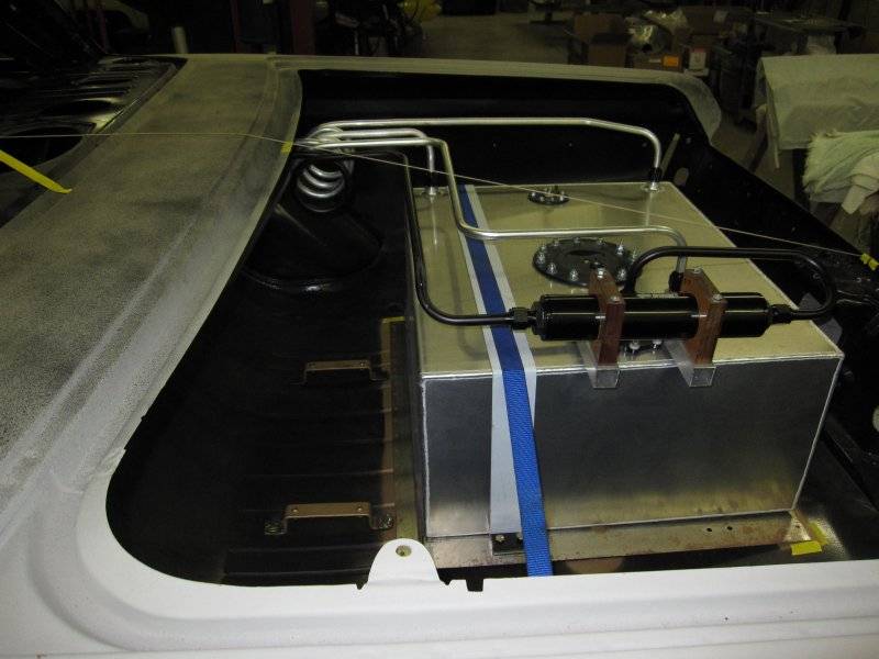

What is everyone using for the after pump 10 micron fuel filter? Part numbers, photo's of installation ?
I'm running a Jegs filter.

I use that Holley cartridge filter with a mechanical fuel pump. Works great and easy to change the filter element.
Thanks for the suggestions, I went with the Tanks filter.
