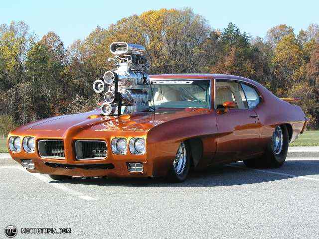

I talked to this guy at Capital Dragway during a car show one year. He said it was a high milage, stock engine (I'm thinking a 400) but he has the blowers way under driven. Funny thing, he got a ticket in OC Maryland for impeded vision.
