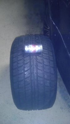

Mean! Thanks SilverTBM. I just copied and pasted your tyre specs into google. I quite like the look of the Mickey T radial. So the tread width is 13" and the section width is 15". Using my tape measure (it's in MM), I had a quick look at my wheel housings and man, the 390mm tyre fills the gap nicely. So by the looks of it the Jegs website says the tyre will fit any wheel form 10 to 13". Handy to know. What would the back space be with your wheel? Dropping the car for the pro stock look I'm looking for is going to be a challenge as far as the wheel well narrowing at the top goes by the look of it. :3gears:

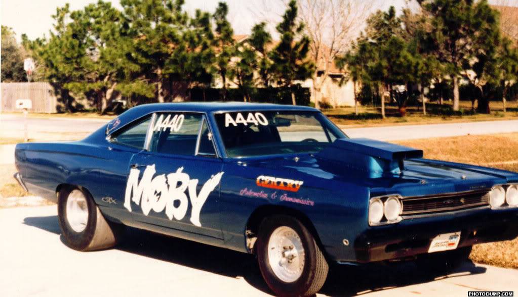

I haven't got my rear end in yet to measure for the wheels. All (3) tires are pretty identical in size. I don't plan to run the back end jacked up. I took rough measurements and I want the ride to look like my mock up pic, very close to the blue RR (which looks killer btw). If you need to go really low in the back, get a wheel tub kit and just go to the rails. They are square top to sides. I am sure I will have this thing rolling before you start cutting so I can work out all the ground work for you.

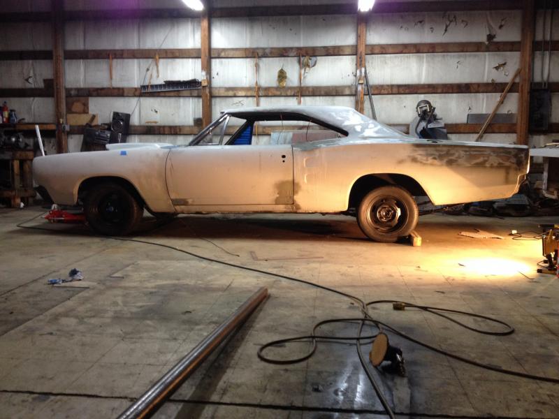

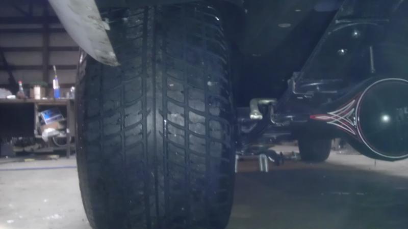

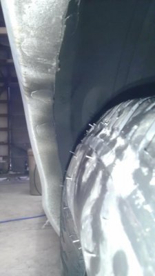

Car is on its wheels. Going to order 15x12 cop wheels with and 8 in backspacing for a stock length 8-3/4 w wildwood kit. Tires will be Hoosier 19200 29x15.5x15 pro street radials. How the car sits w 440/hemi springs the tires aren't event close to the top tapered section for the wheel well. planning on running lowering blocks to get the stance right..if anyone is still interested. Thanks

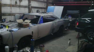

thanks for sharing the link and that's some fine body work you have done there :) can't wait to see the car with wheels on. What tire size you planning on running?

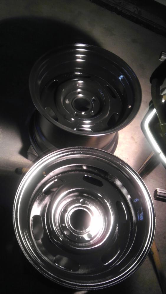

Got the 15x12 "cop" wheels in last week and just picked up the Hoosier 19200 29x15.5x15 pro street radials today. Ill paint them and get the tires mounted next week. Ill have pics on the car next weekend

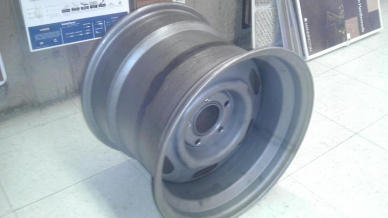

Oh I looked at the stock cop wheels I have and they are the 15x8" for the fronts. I got them with 80% BFG radials for $80 on craigslist, I don't even need to paint them

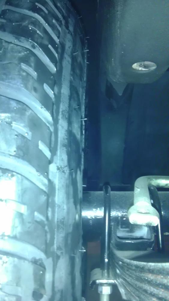

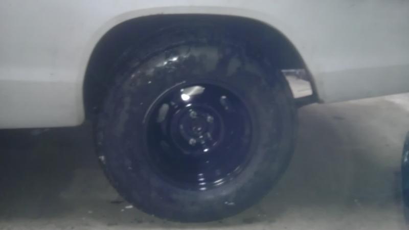

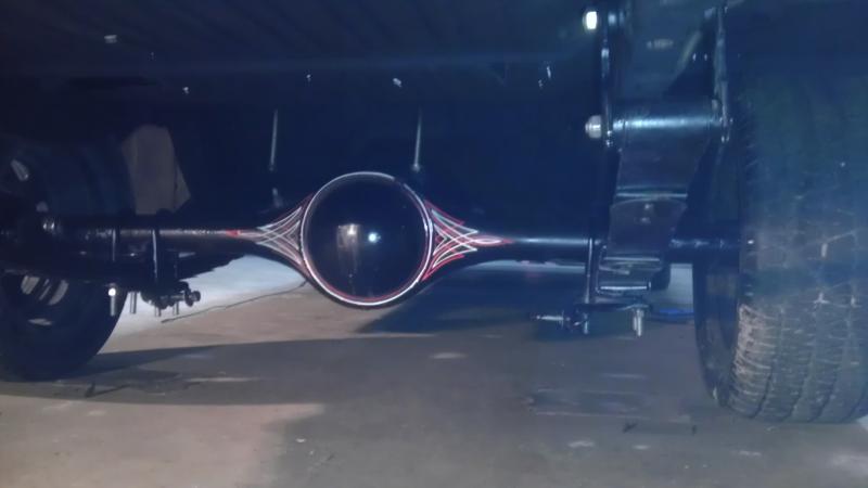

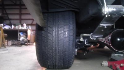

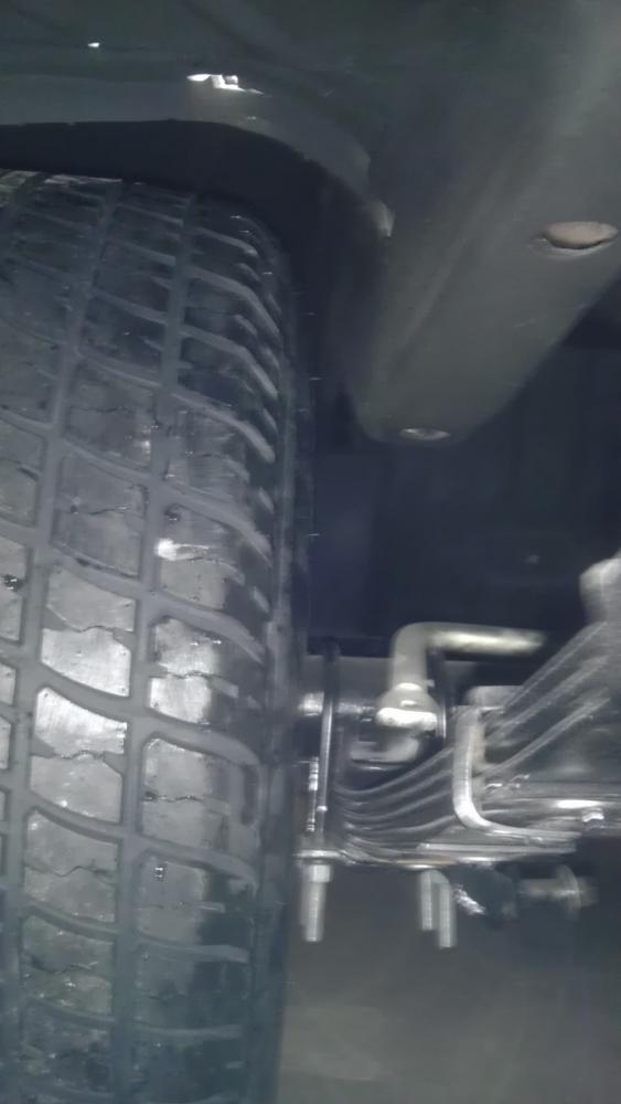

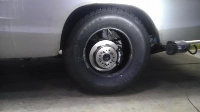

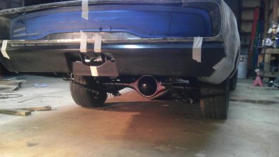

IMAG0596.jpgIMAG0597.jpgIMAG0598.jpgIMAG0599.jpgIMAG0600.jpgIMAG0595.jpg I got the wheels mounted today. Needs about 2.5"-3" lowering blocks
