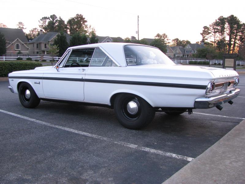

I run 255/70/15 on the rear of my 65 and the wheel wells full

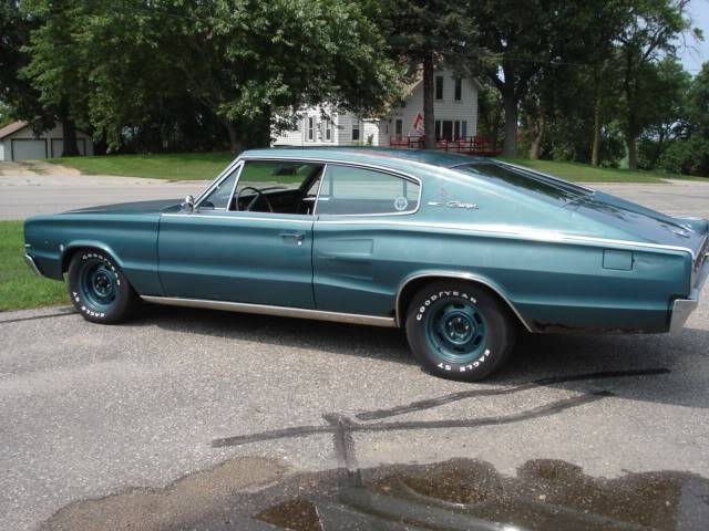

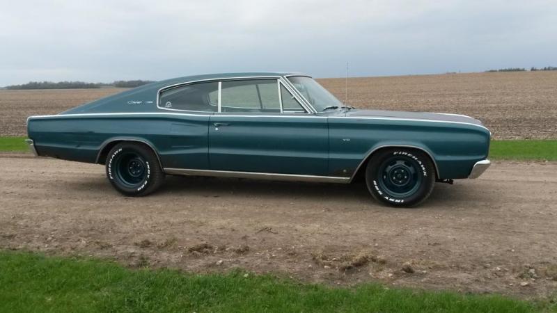

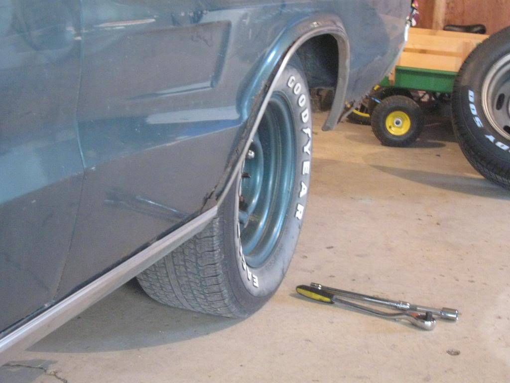

I used to have stock cop wheels on all 4 corners of my '66. 245/60's on the front and the rears were 255's. The stock cop wheels could use a little more offset in the rear.

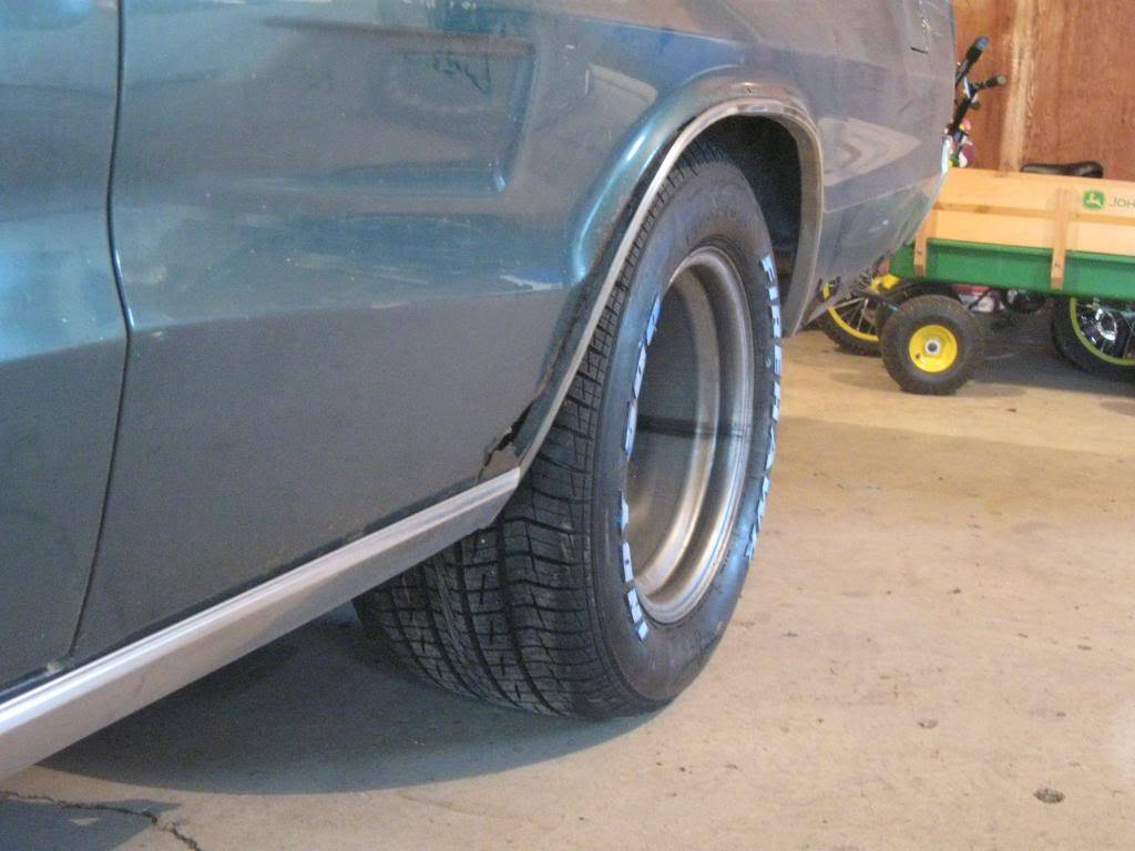

Now I have 15x10 cop wheels on the rear with 295/50's, fronts are stock cop wheels with 235/60 in front.
With the stock cop wheels.
With 15x10's
