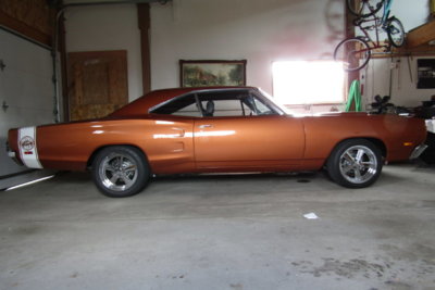

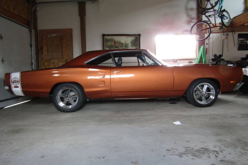

I have 17x9 "0" offset on my Bee with tons of room.Just put Nitto 255 50 on rear and 255 45 on front and corners/drives nice .Tire size is getting limited in 17's and was considering 18x10 with 275 40's all around, but cheeped out and stayed 17,s.I like the US wheel models in this size.Prior to the NITTO tires I had Federal SS595 for 10 years and they drove real nice Too for a budget tire.The Federals didn't seam to tramline as bad as the NITTO.
