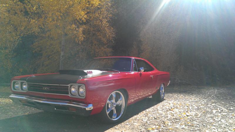

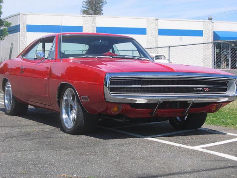

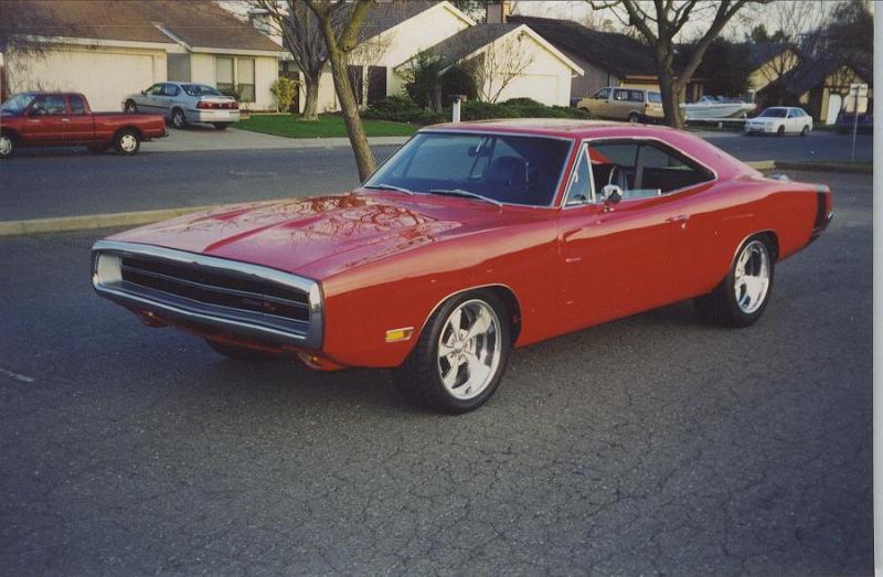

i got 18x8.5 in front on mine with 4.5 inch backspacing. hope this helps you out.

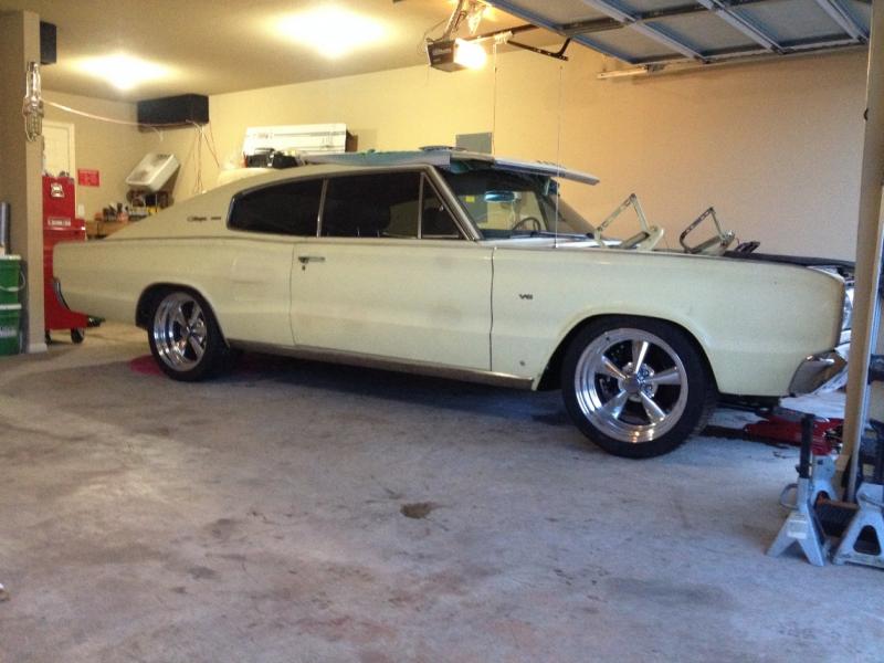

i got 18x8.5s on mine as well with 4.5 back space and they fit well no issues.

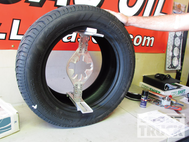

Well first thing i would do is to buy this tool...it helps you measure you tire and wheels combo !

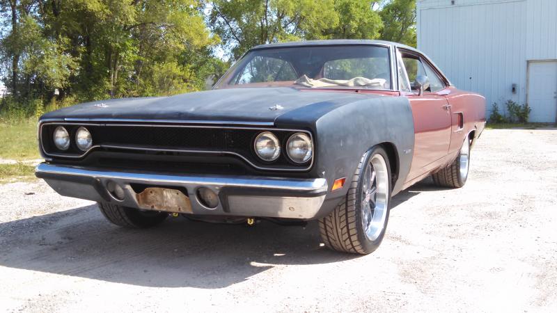

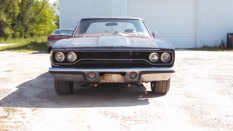

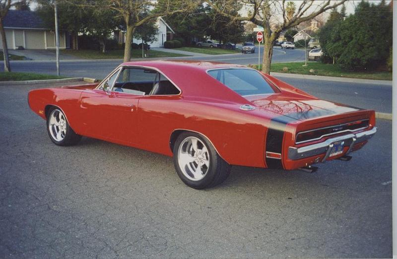

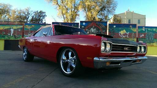

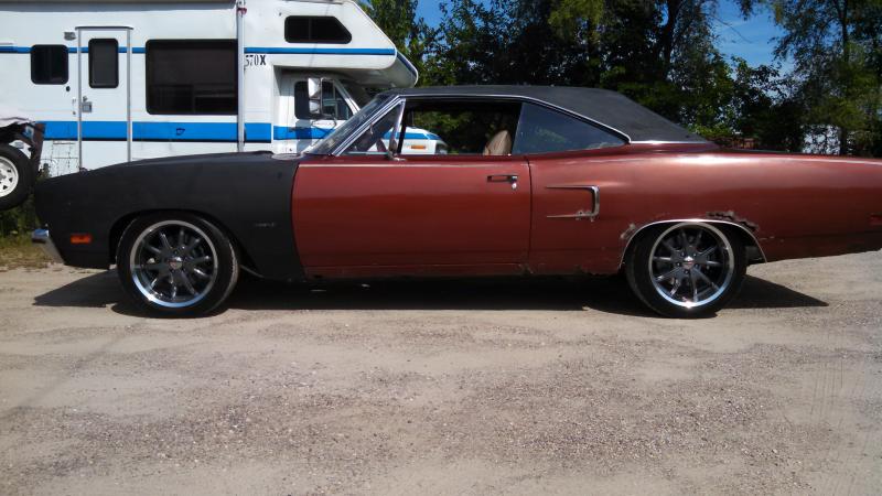

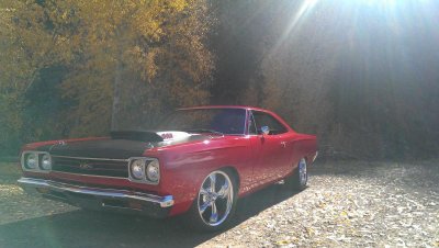

Mine are 18x9 with 4 5/8" backspacing. I ordered the wheels and was able to have the backspace almost anywhere I wanted it. 275/40/18 up front.
18x10 out back with 4 5/8" Backspace on an axle 1 1/2" narrower than stock. 295/45/18 rear tires.
