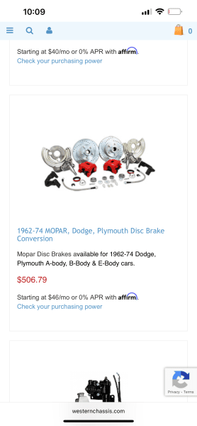

I usually use western chassis for the spindles and source the rest of the brake parts via rock auto. But it looks like they have a kit available now
