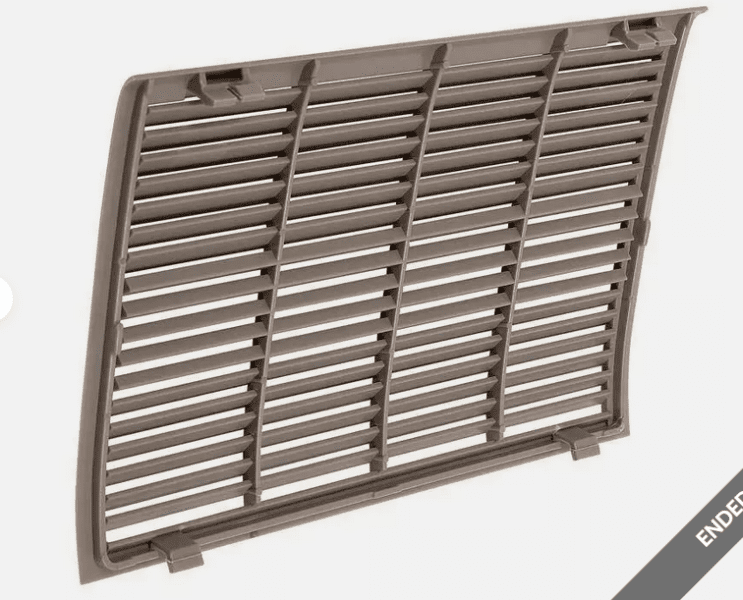

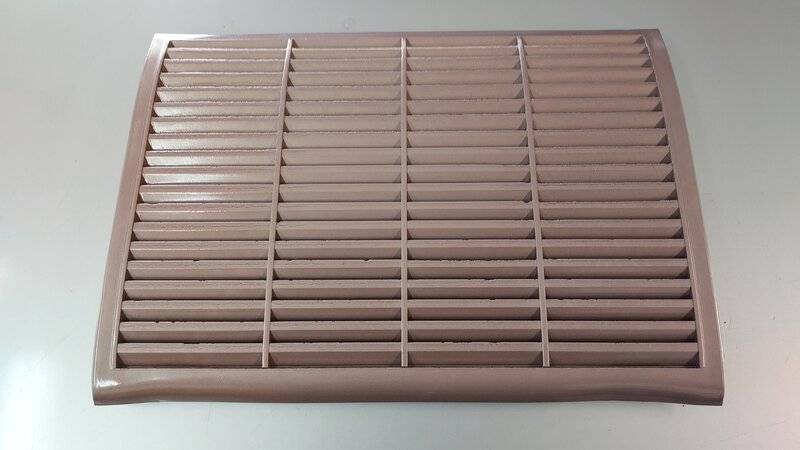

If it's an original grille i believe they are just held in with clips.. BUT they are insanely fragile.. the odds of getting it out without breaking it are well... very low..
ahh yup.. a clip on each top corner... New ones aren't as expensive as i expected.. need to find one in gray..

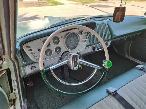

Oh nice, how do you get the clips out of bottom first? Can you reach behind or something?
I used a plastic trim removal tool to wedge in under the bottom edge of the grill. (On the outside of the dash) If you can reach in from under the dash you can feel the tabs. Apply a small amount of Vaseline on the tabs before prying them out. They are rather dry from all the years in seclusion.

I fitted my grill upside down and I ended having to snap the top tabs as i couldn’t get the grille out with gentle persuasion. I think the only colours they do the new grilles in are red, tan & blue. I needed a black one, so bought a red and sprayed it….easy enough to do.
