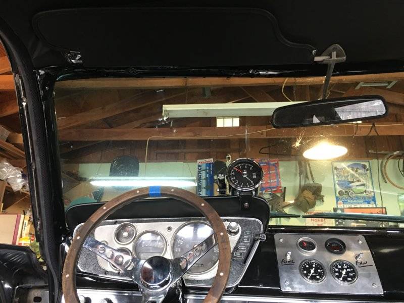

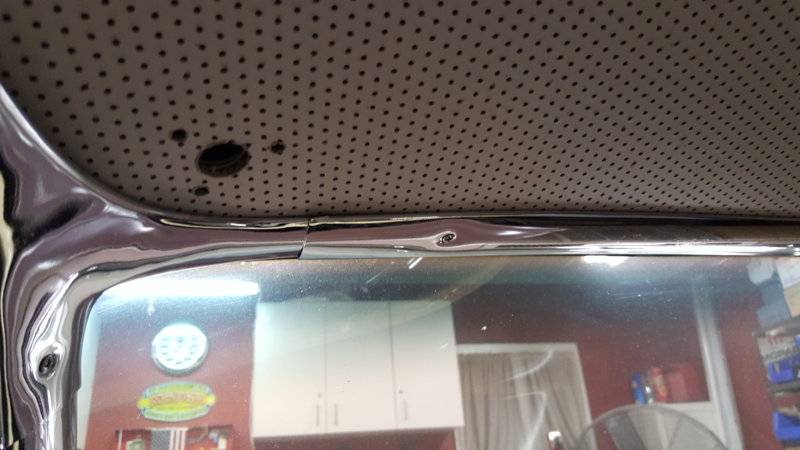

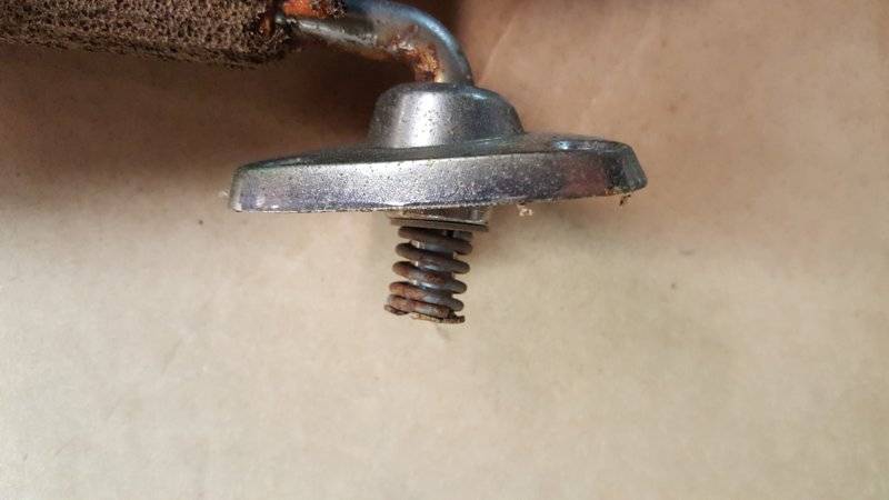

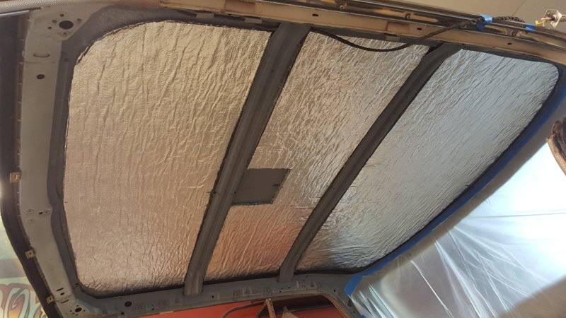

any body have any pics of the mounting holes on there '63 Plymouth sun visors and the actual mounts themselves? I installed the headliner today,without looking at the mounts...I "assumed"(I hate that word)that the sun visors I bought 2 years ago were correct..
my visors have a 3 bolt mount,,but I can find 4 holes thru the headliner with a probe?....thanks..

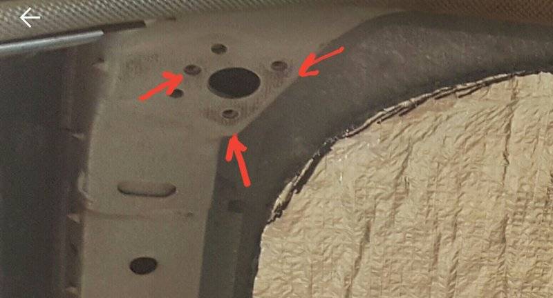

Are you sure the fourth hole isn't the one for the swivel spring arm? Would be in the center of the three screw mount holes.
the large hole was easy...even a google search did not turn up a pic of either the mount or an actual '63 visor..and my shop manual does not show it..I would leave it off except now theres a hole cut for the spring swivel....
The '62 should be the same, but don't hold me to it.

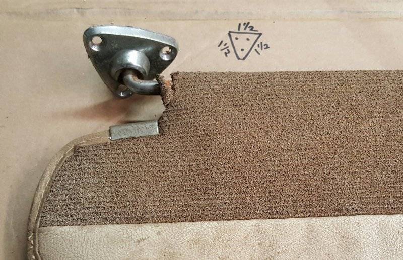

Here's the '62 ...
In the pic it shows 1-1/2" but it's closer to 1-3/8" center to center of each hole.
Hope this helps. BTW, I'm looking for a good set.

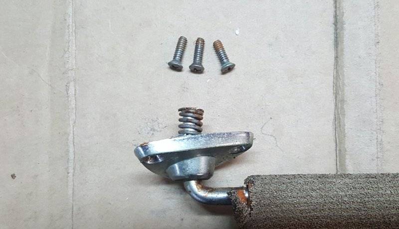

Found your extra hole. The three holes used are tapped for machine screws. (10-24 x 1/2") There are others there too that aren't tapped.

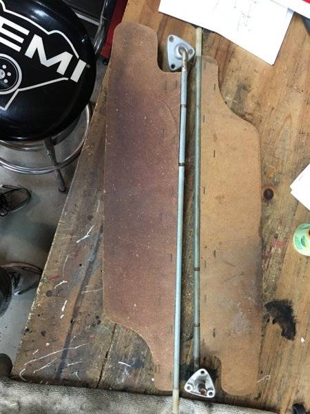

u the man!!thanks a lot..your pics made it work...if u were close I would buy u a hamburger...I may have 2 original units pictured that I wont use..there complete frames,no cloth..don't know wheter that helps or not..I bought new repro's already covered and installed new chrome mounts and new nylon mirror stubs..

I have my original ones. I might just have them recovered with vinyl material I have leftover from the seats. I see REM makes them. They advertise $134 but I don't know if that's each or by the pair. Anyway, glad you got it :thumbsup:
