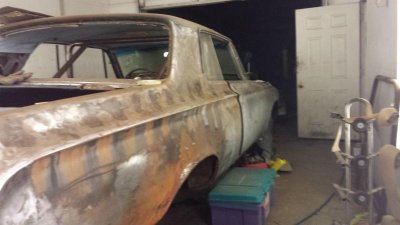

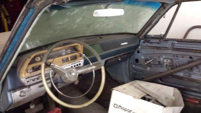

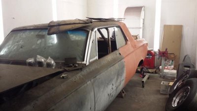

What it doesn't have is any identifying emblems to specify what model it is. The working theory is it is a Polara 500 by the vin?? The vin tag has 6432XXXXXX. Here are the starting pictures and if anyone believes it isn't a Polara 500 please let me know!! 20150203_102621.jpg20150203_102723.jpg20150203_102807.jpg20150203_102832.jpg20150203_103233.jpg20150203_103547.jpg

Welcome to the forum. Your decoding is correct. Dodge V8, Premium, built in 1963 at the Hamtramck plant. Nice car!

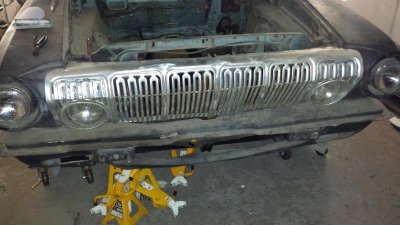

Scored a parts car for a variety of panels and trim! Truly think I am down to only missing one headlight trim ring (driver side is pretty mangled), time and money...20150220_091206.jpg20150220_091242.jpg20150220_091815.jpg
Nice to see another '63 Dodge guy on board! I have a single passenger side headlight ring for sale (off of my '63 330). It's not perfect but in ok shape if you need it? I think these trim rings fir on either side. PM me if you might be interested.

I dont see any lower quarter holes for the 500 panel or side moulding holes for stainless. Dash and door panels look like 500 stuff.
Is there any trim that doesnt seem to fit? if it was a 500 and the holes were filled I would be interested in the stainless

Never did see this car with trim on it. The trim holes on the rear quarters are welded on already. Did get some more history from others that knew the previous owner that sold it to my father in law. In the 80's it was hit in the rear corner and they couldn't find the correct taillight panel to put back on it so they put the panel from a 440 on it. This leaves the car with no reverse lights though. I do have a 440 trim parts car with the appropriate reverse lights that I might put into this car?
Got a couple hours in the shop today. I knew the right rear wheel opening was rusted through so I cut the rear quarter panel off the parts car. Looked really good and usable until i got a look at the back side. Hit the rust spot with a wire wheel and the only thing holding the rust together was the paint. Looks like a new panel will have to be ordered. Figuring if the right side was that bad I would remove the primer from the Left side and see what kind of shape it was in. Removed the primer and about six layers of filler to find metal. It appears whoever replaced the panel was not that good with metal working and just covered it with filler. Will definitely have to work the metal over or cut it out and start over. It also appears the same guy did some repairs on the panel between the rear window and the trunk. Curious what hides below the rest of the paint/primer.....20150404_194436.jpg20150404_194453.jpg20150404_194515.jpg
My guess would be that that isn't a Polara 500. I owned one back in 1966 and I don't see the mounting holes for several of the chrome trim pieces that mine had. Of course the holes could have been filled. I can send you some pictures of what mine looked like if you give me an e-mail address. I can't seem to attach pictures here.
Most of the trim holes have been filled in on the quarter panel when my father in law got it. I did figure out why the car has 330/440 taillights; repair job from previous accident. That is where most of my confusion came from as this is my first B body build, all my other Mopars have been A bodies. The Front fenders, which I have been told are original but don't know for certain, still have the trim holes. Not too concerned to the trim level at this point as it will end up trim delete when all done.20150404_195239.jpg
