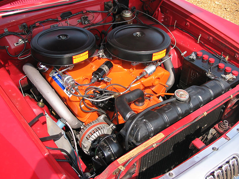

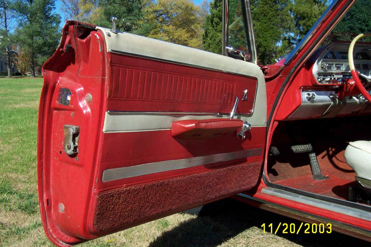

It still has some of the original paint tho, in the engine bay, trunk & door shuts. The original paint is a bit darker than the bits that have been repainted.
1st pic shows the driver's door original paint (before we got it) and the 2nd is the original piant under the hood, just after we received it (yes, the sun does shine over here sometimes! :icon_sunny:)
