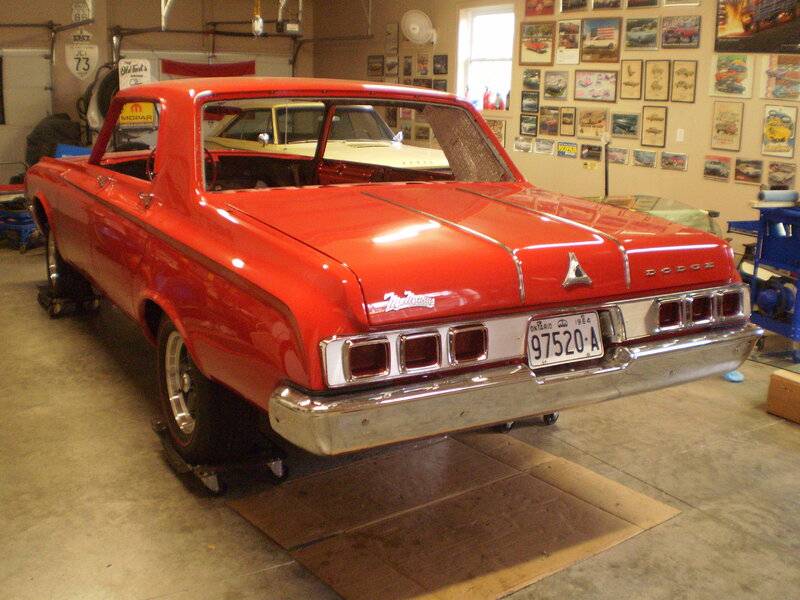

1964 Dodge 440

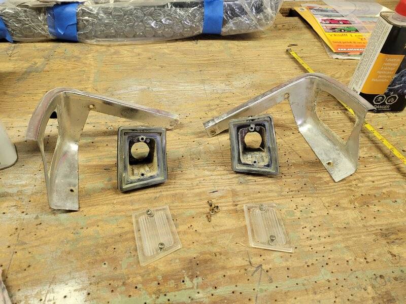

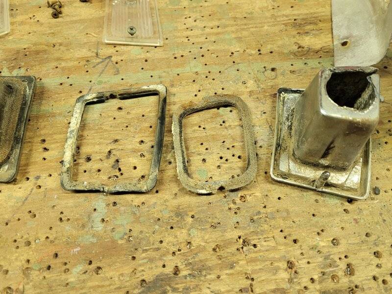

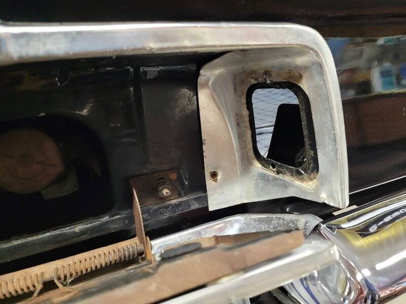

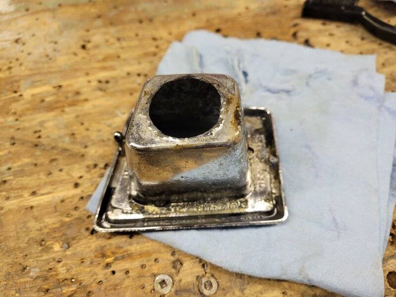

Reverse light lens and housing gaskets.

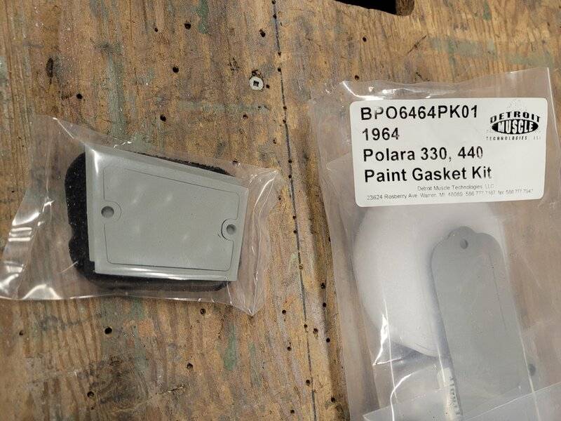

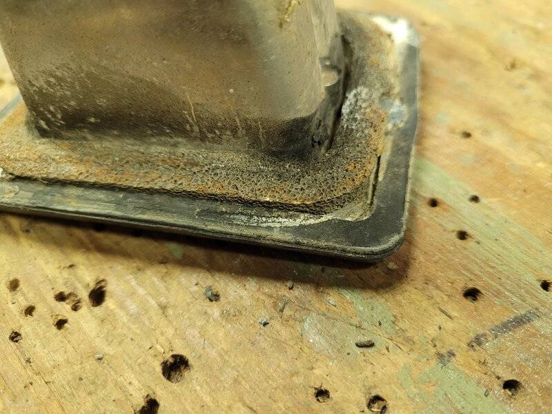

Gasket kit came with only the spongy foam outer gasket. It did not come with the hard rubber one it appears, so keep that in mind if you're doing yours.
Outer seal gaskets off. Guess I'll be cleaning up the larger hard rubber one.

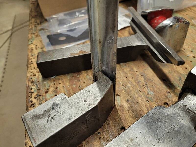

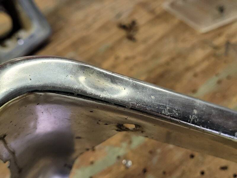

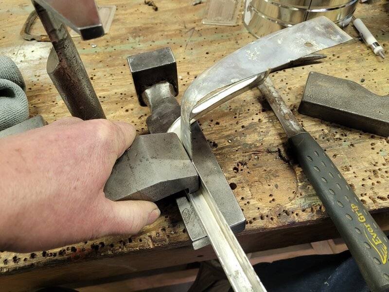

A couple hours of dent massaging.

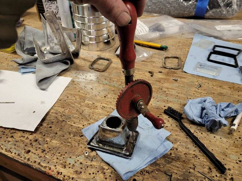

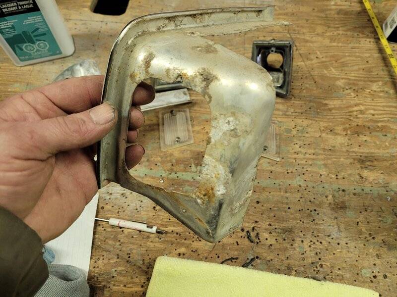

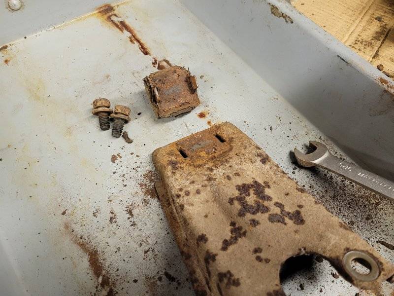

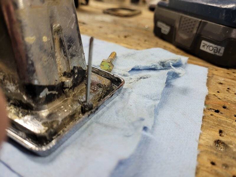

One housing has a mounting post broken off.
My cordless is in the house, I'll use Dad's cordless.
When life was simple..

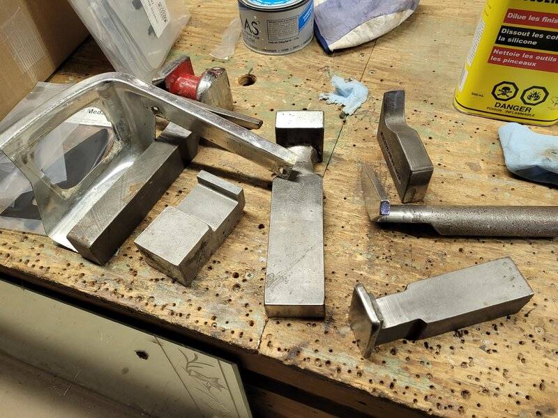

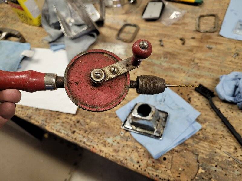

Drilled 80% of the way into the casting so I can put a "peg" in. A rivet mandrel in this case.

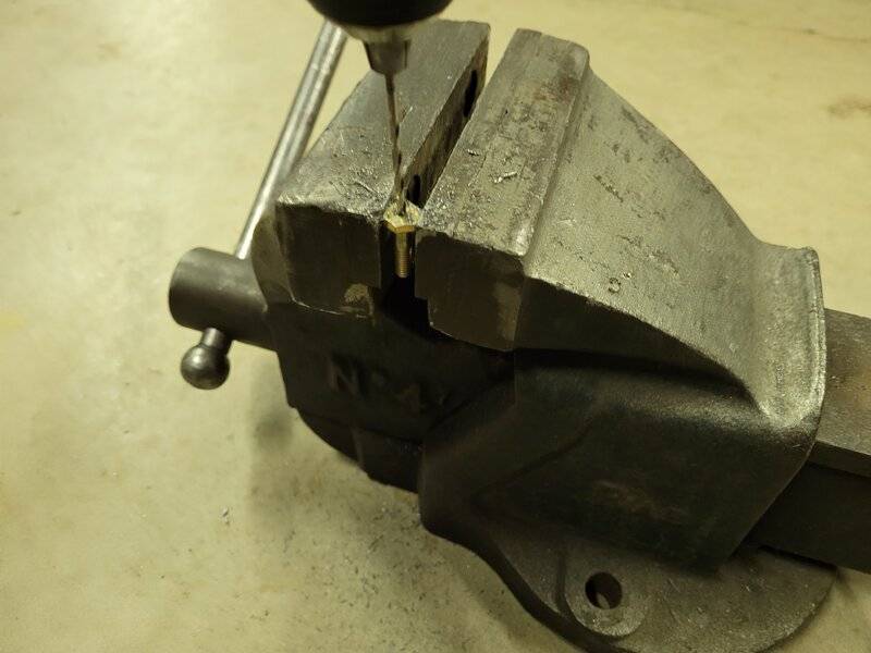

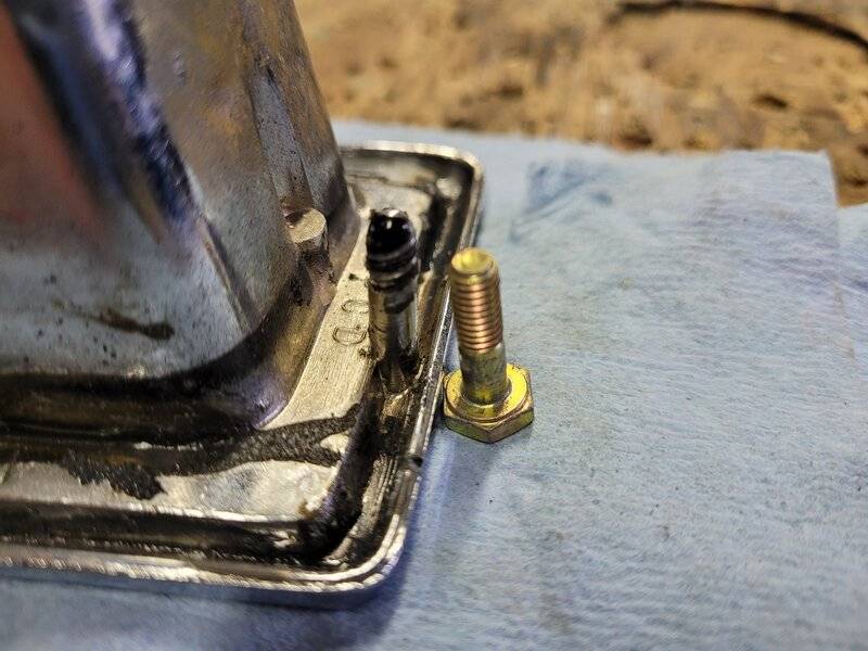

Found the correct length AN3 bolt to substitute the cast post.
Drilled a hole down the bolt shank through the head.

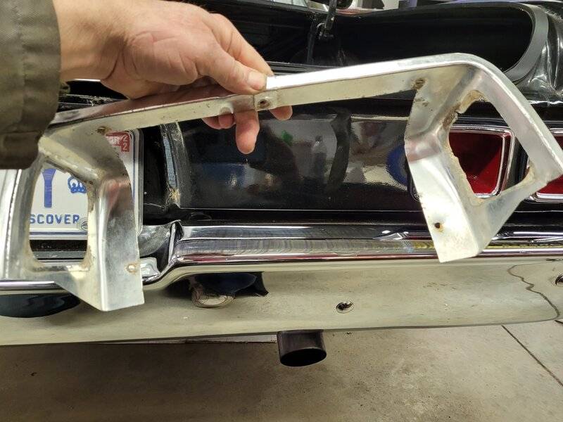

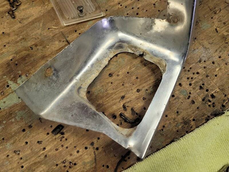

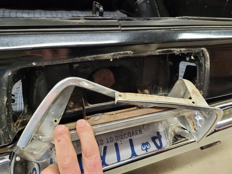

One piece at a time we'll clean this car up. Off with the pitted and "faded" chrome trim tail piece on the drivers side.
Three speed nuts on the chrome piece and removed 2 nuts on the stainless so I could lift it high enough to pull the end piece out.

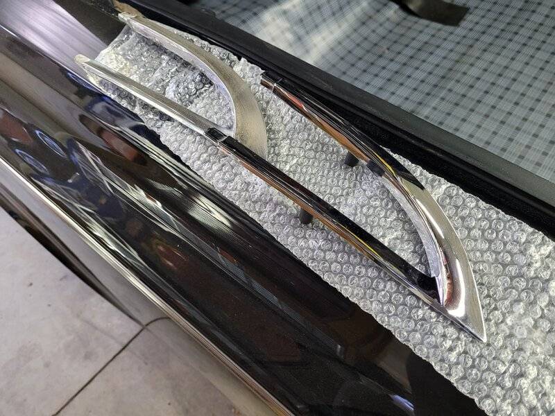

Ready for the new NOS piece I got a couple months ago from @QuickBpBp. Thanks again Brett, it sits fine even with the missing post.
Old and the new for comparison.

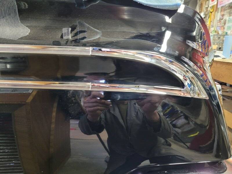

New one in place and snugged down.
Mucho better. Thankfully the passenger sides is in good shape.

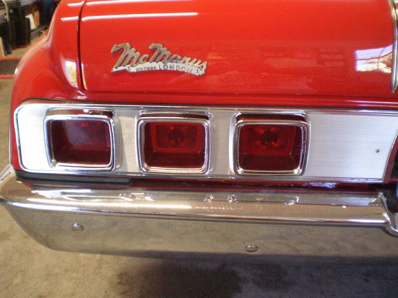

Nice work, Wayne. I took the centre back up lights out of my Polara to put red lenses in with tail light/turn signal. Then I wired in a sequencer to flash turn signals in turn. I had picked up a set of U.S. 440 reverse lights at the Indy Swap Meet one year, and had to cut into the license plate coves to mount them. It all came out fine.

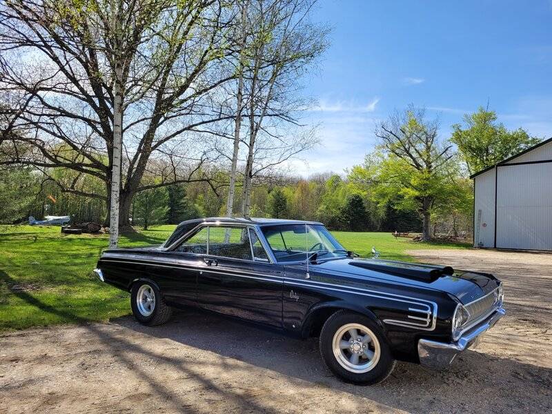

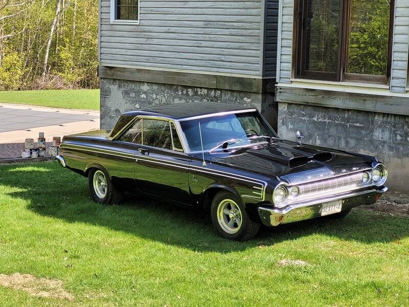

Not sure how long I can own a Black car for... but it's kinda cleaned of it's Winter storage filth. Can't go anywhere anyhow, as the town hasn't spent any of my property tax money on calcium for the road yet. We can't even leave our house windows open some 1000' from the road the dust is that bad!

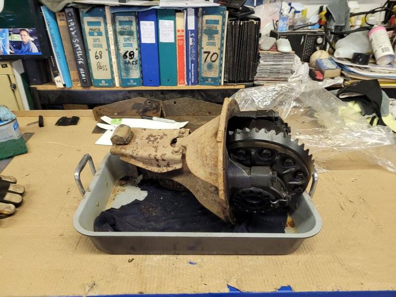

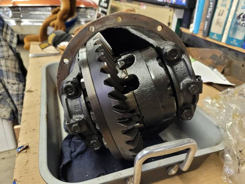

Time to put a rear axle together for the car. 742 case with a 3.23:1 SureGrip.
Suregrip clutch unit. Bearings appear to be in good condition so a clean up, new pinion shaft seal and we'll run it.

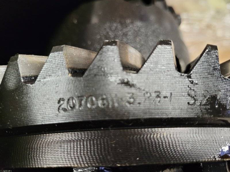

OE 3.23:1 gears. NICE wear pattern and no pinion to ring slop apparent.

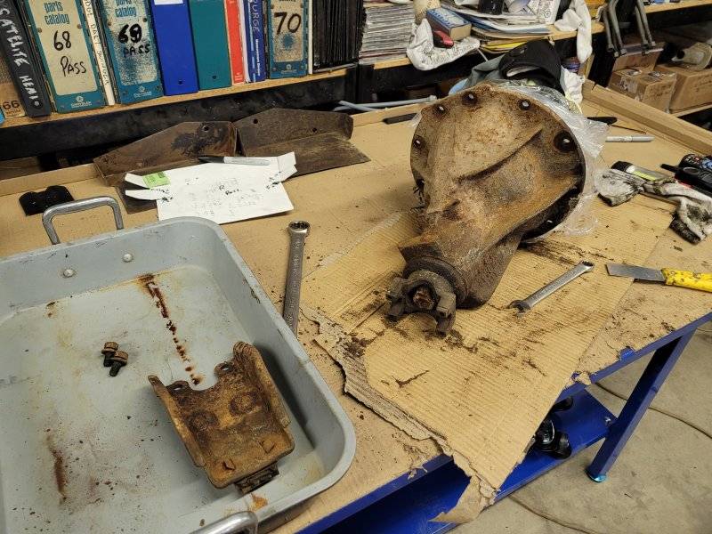

Pinion snubber plate off for media blasting.

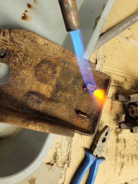

Heating up the snubber rubbers tabs to bend them straight enough to remove it from the plate.
Snubber off without breaking anything.

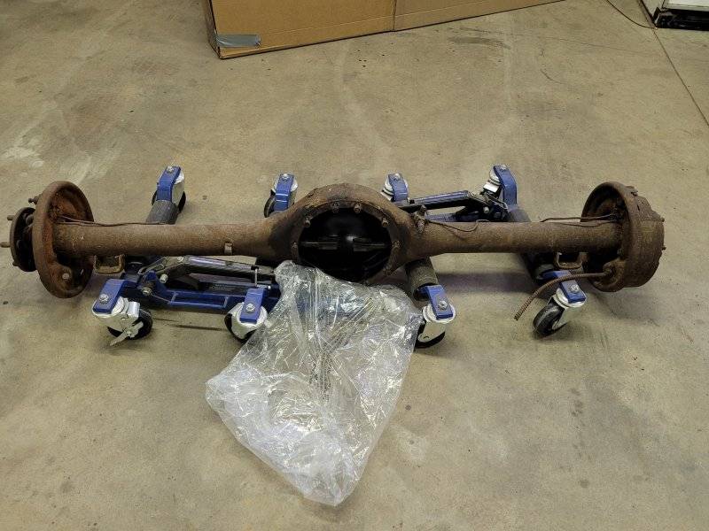

1967 rear axle housing... approximately 1.5" narrower than the tapered axle OE currently in the car. Should put the tires nicely centered in the wells. Tires currently rubbing the outer lip with a good inch gap on the spring side.

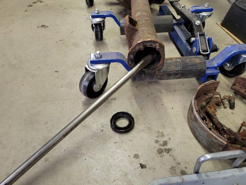

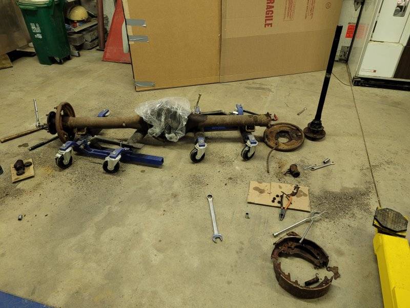

Left axle out of the housing and brake backing plate off. Kinda weird how they stole the pumpkin out of this assembly and then put the axles back in.

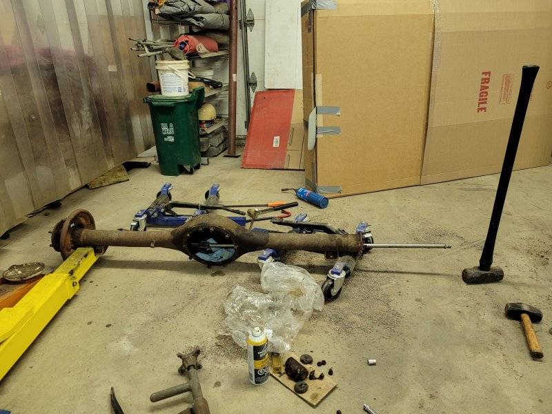

I've never had an axle that I couldn't just pull out hauling on the wheel hub. I tried a slide hammer, no go. A 5 lb hand sledge and my long "punch".. no go. Bring on the 10 lb..
Both axles out, brake backing plates off, brake lines off, ready for media blasting.

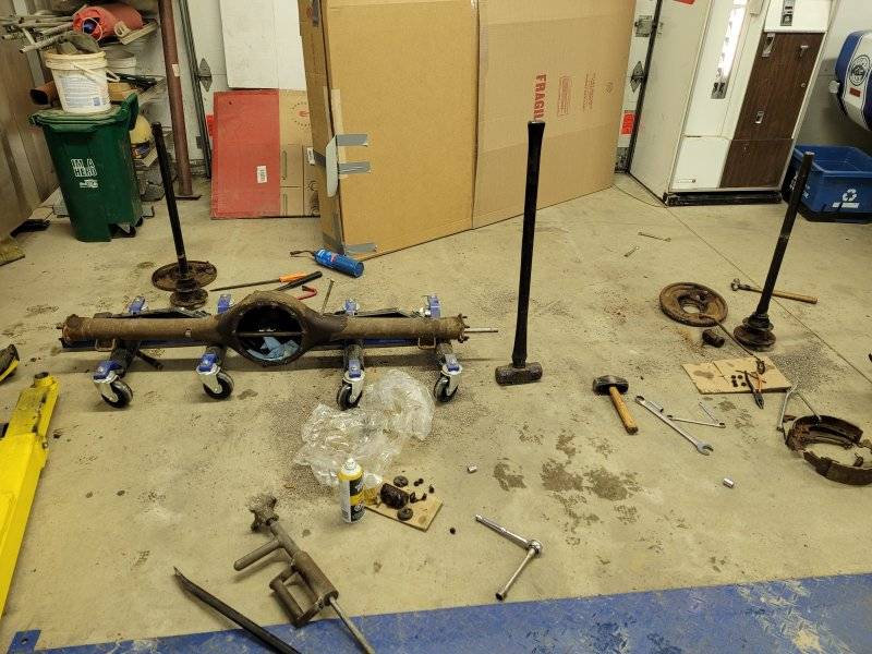

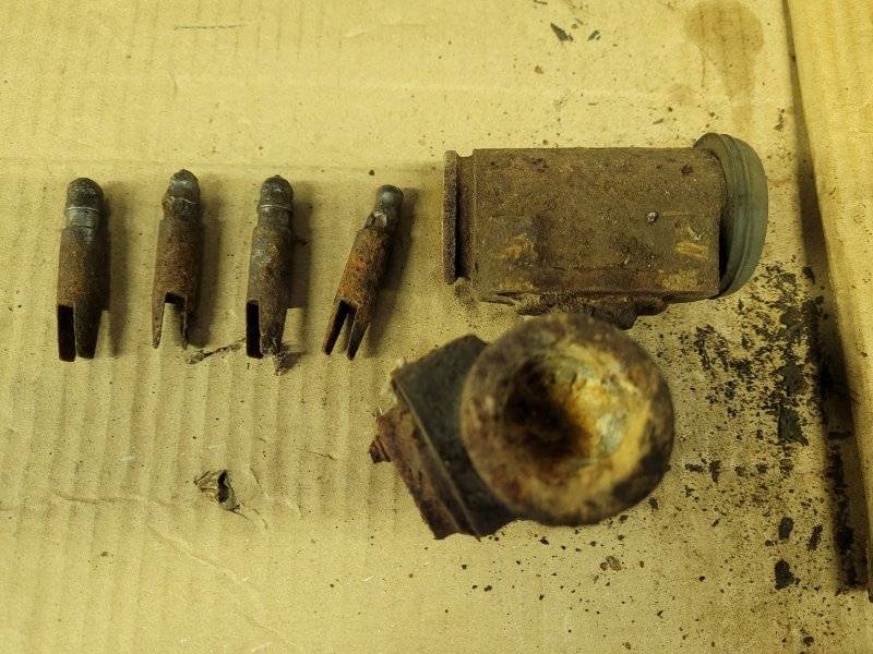

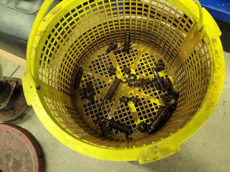

Don't think all the Evaporust in the world will bring these back to usable...
Which reminds me, I should have bought a new bucket of Evaporust when I was in Princess Auto on Sunday. Don't think this old stuff has any "umph" in it anymore.

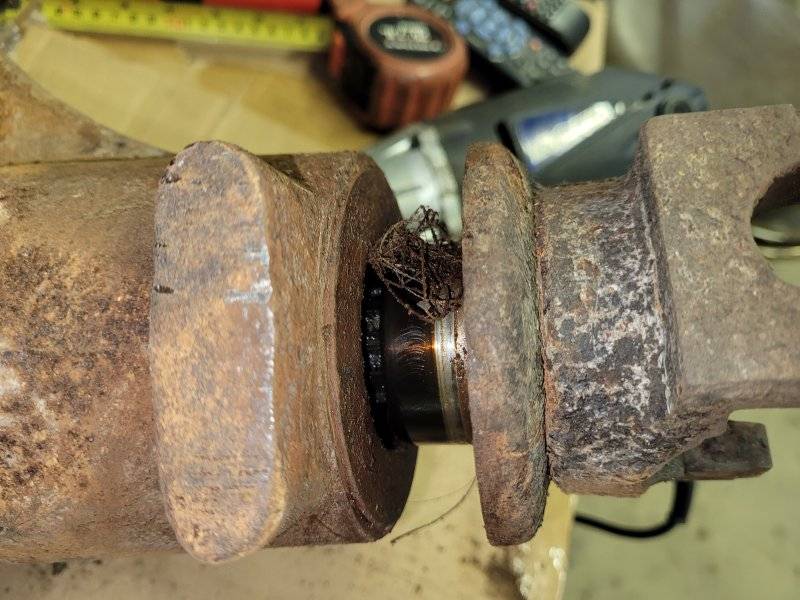

Attempt #1 to get the pinion nut off. Pipe wrench (clamped to table) on the yolk and J bar with 1 1/8" socket. No go on what's been there for 56 years and originally torqued to 220 ft-lbs.
Amazed that my old tired electric impact got the nut off.
Pretty clean under the yolk other than the weed growing that looks like pulling fishing line out from under a boats prop.

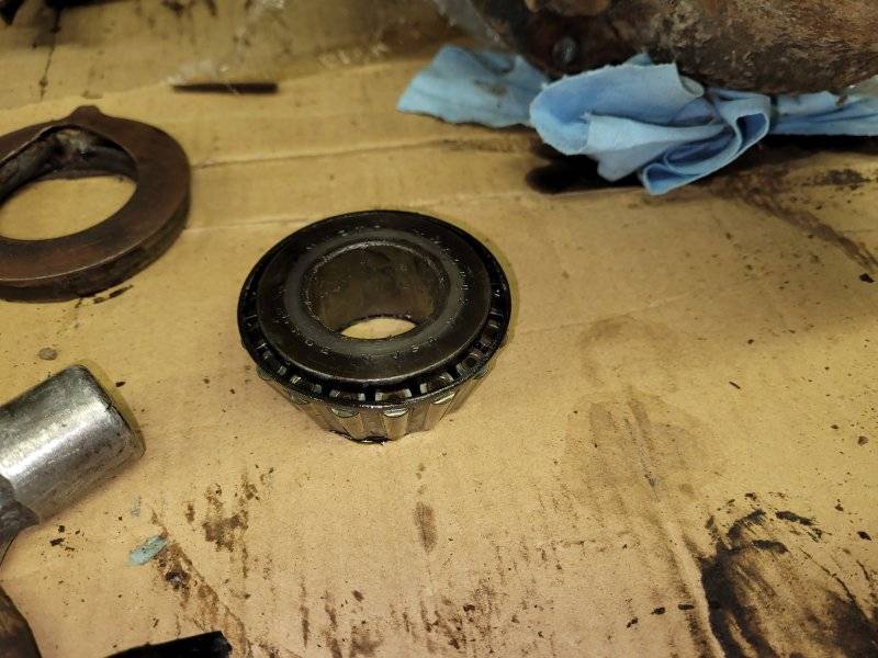

Bearing looks mint and the rear pinion bearing rollers also look good the best I can see them with a flash light.

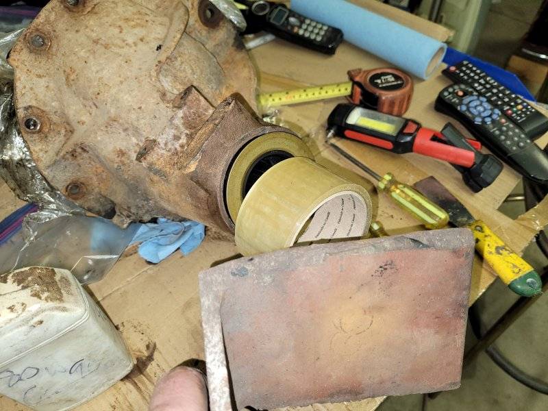

No need for fancy tools. A roll of tape the correct diameter and a steel plate to pound on.
New seal nicely in place.

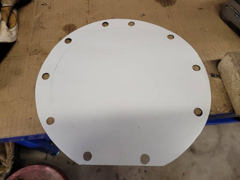

Block off plate for the pumpkin hole.

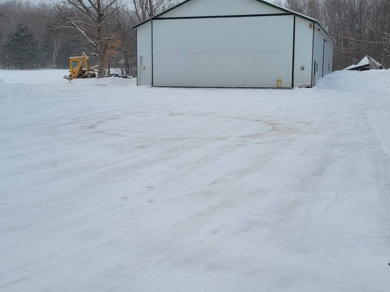

Time to go do some donuts...
Looks right at home in the snow.

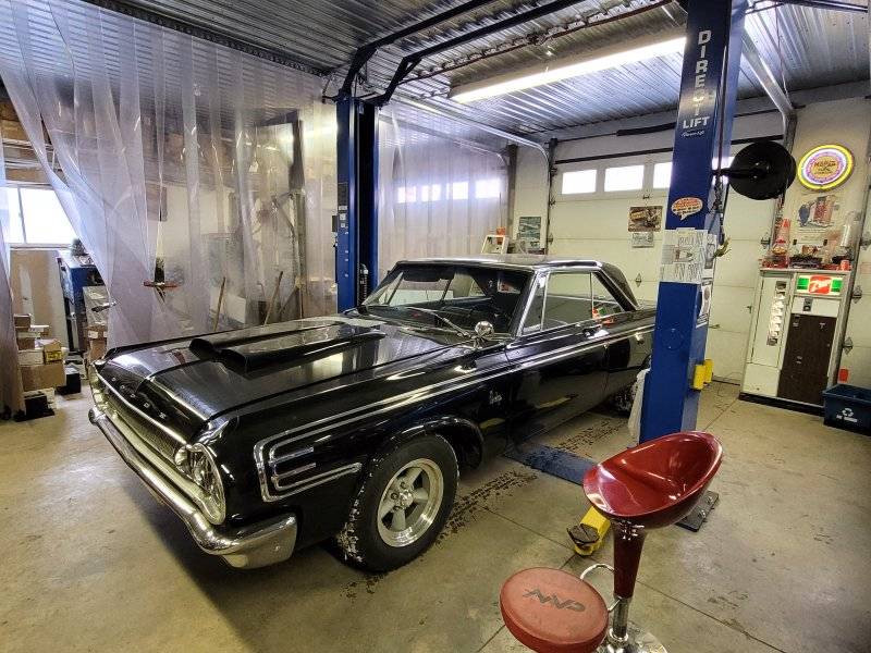

In the hoist bay so I can check out what "tabs" I need to add to the newer '67 housing for brake lines and parking brake cables. Also gives me the mill and lathe area to work on the axles without hitting a car.
