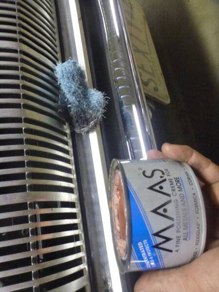

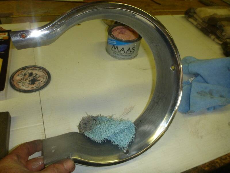

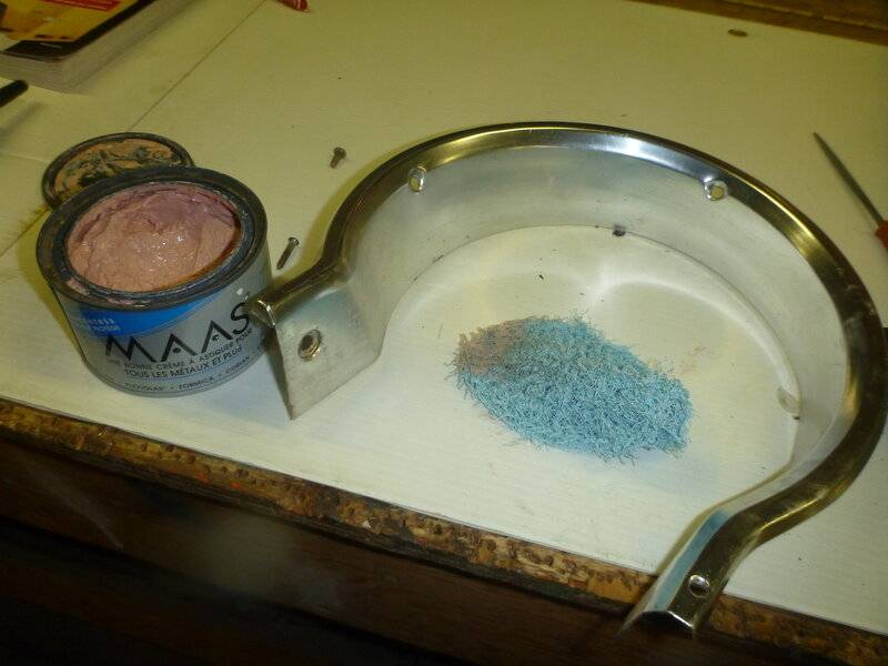

Figured I'd kill some time before everyone showed up for "Thanksgiving" dinner yesterday. Scrubber made by our old neighbour from crotchet string and some MAAS polish, worked very well to clean up the wide flat portions.

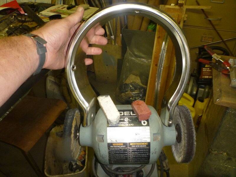

Buffer with White on the hard wheel and rouge on the soft.

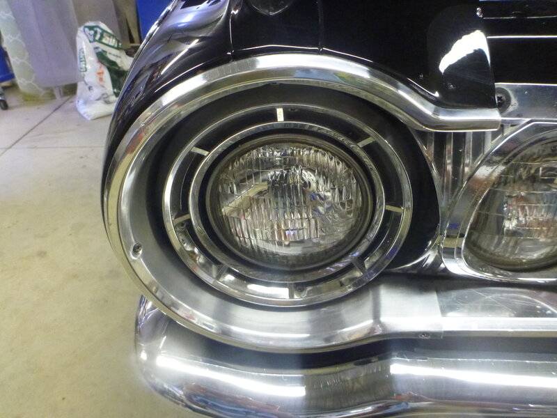

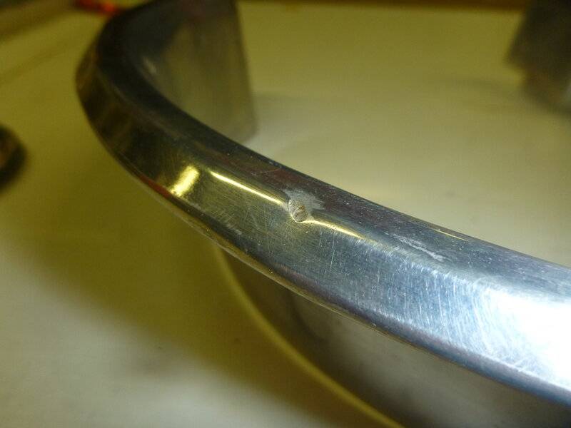

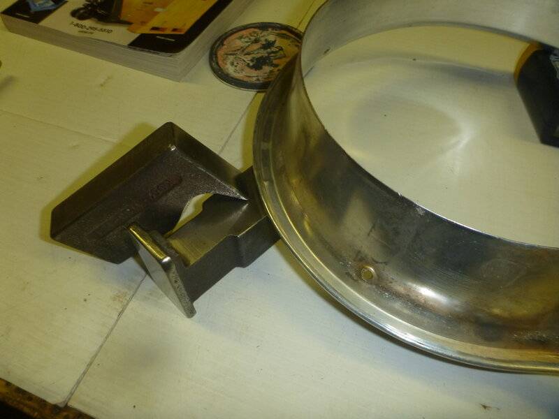

Passenger side eyebrow has a dent, we'll fix it a bit.
Hammer and dolly time..
Final polish on the passenger side eyebrow after dent reduction

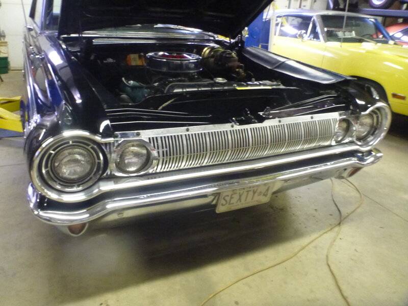

Looks good for now back in place. Want to get a few more drives in before I tear all the trim off the car to polish correctly

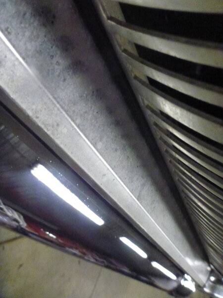

Front grill is quite tarnished along the bottom length.
MAAS and the scrubber cleaned it up a bit, need to take the grill off the car and do it properly with a power wheel this Winter.
Looks pretty good from 10 feet.

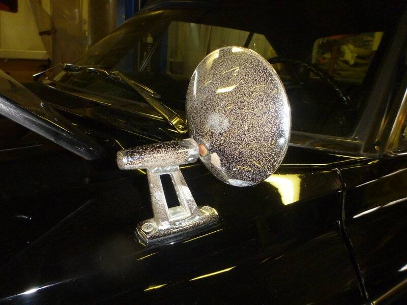

Need to find a better mirror. Thought this was some junk yard find, but it has a Chrysler part # on it of correct vintage
The mirror on my 65 looked kind of like that. I used a hard wheel with a grey compound, then slowly worked to soft buff with red rouge. It is so much better
This one is beyond revival. I've done a lot of magic on chrome and trim with the Bee and Bird, but this mirror isn't worth any effort. Found one on Ebag in nice shape, but the prick won't ship out of the USA or even change the listing so I can buy it and have him ship elsewhere..

It actually works really nice where it is... and I'm not welding up the holes! :eek:
"Door" mirror was an option in '64, maybe that's where a dealer put it... who knows.

Thanks Joel! Just gonna let it ride for now and wait for a better OE to pop up. Now that I know there's a repro made for it (no pentastar) I don't need to snap up the first one I see.

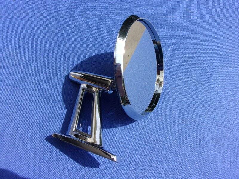

Don't they repo those mirrors?
YEP, no Pentastar on it.

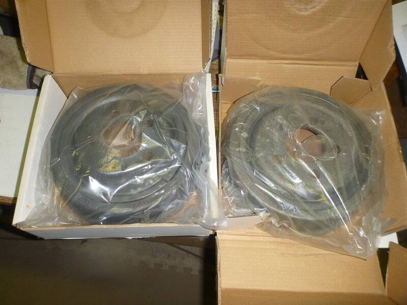

Another ffs... you'd think Nigel's shipper would send a matched set when they're 90 bucks each. Two different mfg's and the Raybestos one is 1.3 lbs heavier! Oh well, Nigel's got another one coming to me tomorrow to make a matched set at his expense!

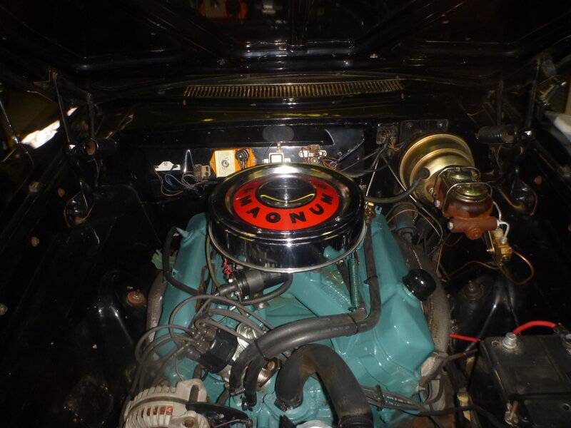

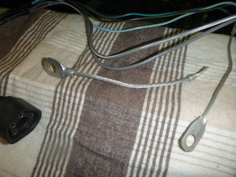

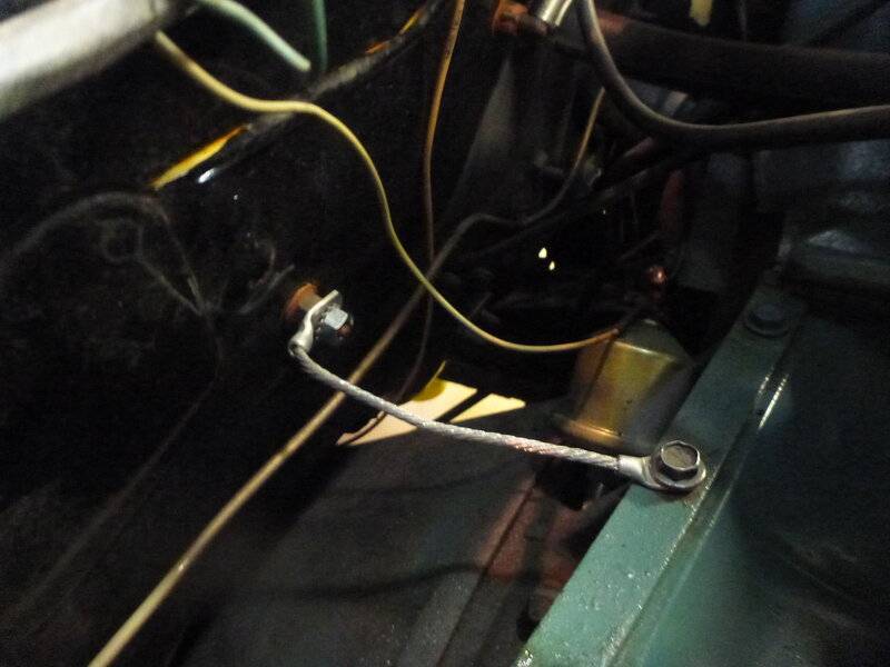

I see absolutely nowhere that the body of this car is actually grounded to the battery and engine. Must be getting it's body ground via the trans cooler lines and radiator. I have a few thousand of these around..
That'll do the trick, out of sight behind the carburetor. It has more "play" in it that it looks.

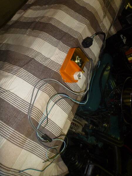

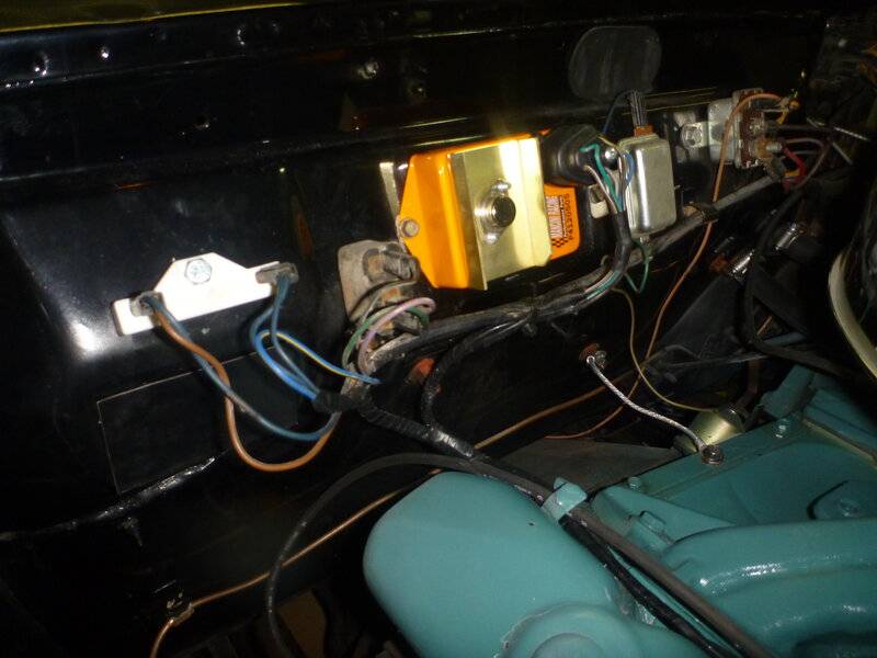

Threatened the ignition module with a new one and a new wiring harness, courteous of the car seller, and then gave the old harness one last look over first.
It may have just been loose female connectors on the harness plug, gave them a squeeze and put it back on tight. Can't kill the car, so next hot cruise will tell the tale. Spares are in the glove box so it'll never die again...

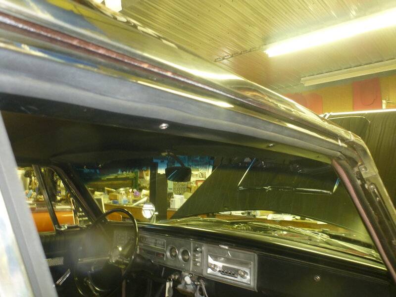

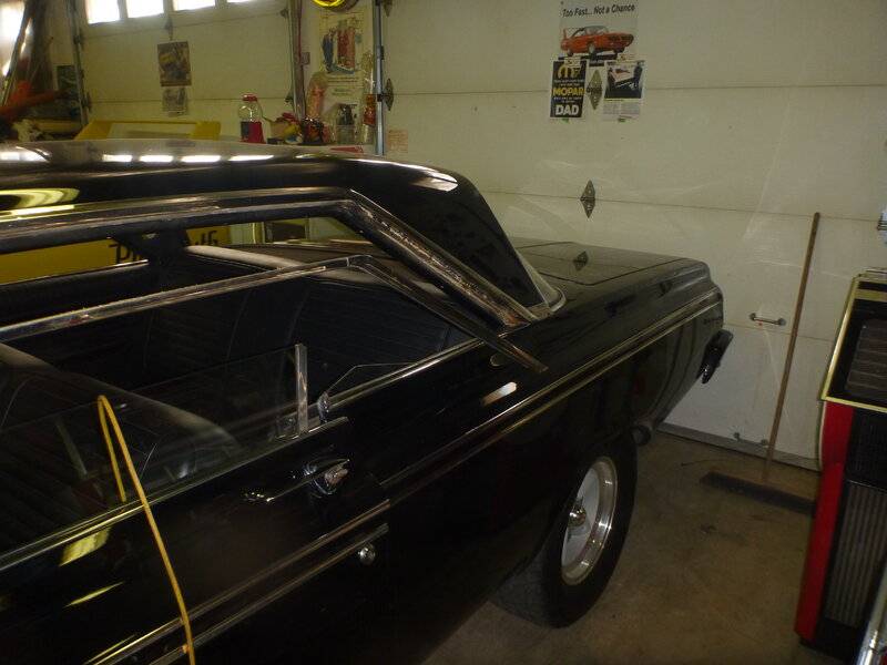

Needed to swap spots so I can open the 440's doors fully to install the window to roof rail seals. That'll come after painting and trim work in the house...:(

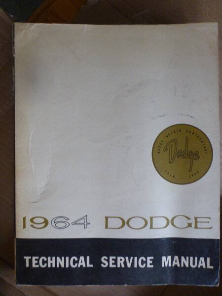

Not much of a "read the manual" kinda guy, but can't hurt on a 57 year old car. Nice clean original, not a crappy reproduction .
Now I know what the steering wheel horn ring center says after seeing the manual cover. I can make it out know that I know WHAT I'm reading

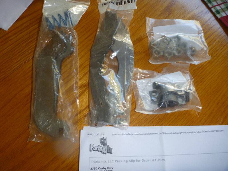

Parts to rebuild that '66 axle housing I picked up last week. Emergency brake levers and struts, new pumpkin to housing nuts and new U joint clamps and bolts!

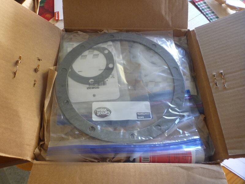

When you can smell the box even before the Fedex guy opens the delivery van door!

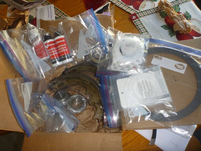

Bearings, seals, gaskets, shoes, wheel cylinders, etc and three bottles of the stinky stuff ! Everything to complete the rear axle overhaul and some spares.

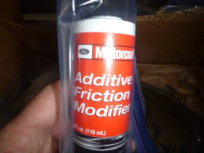

Only thing Ford is good for here is the sure trac clutch gooo.

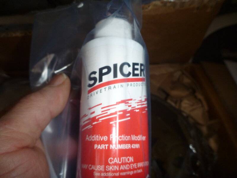

I guess Cass/DoctorDiff only had two bottles of Ford, got one from Spicer. I bought three as they were only $8US each. $32Cdn each if I walk into the Ford dealer here..

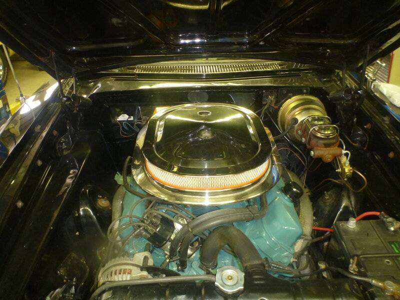

Thought my chrome ramcharger air cleaner would look neat, but unfortunately the hood won't close as the Edelbrock Torker intake has things too high up.

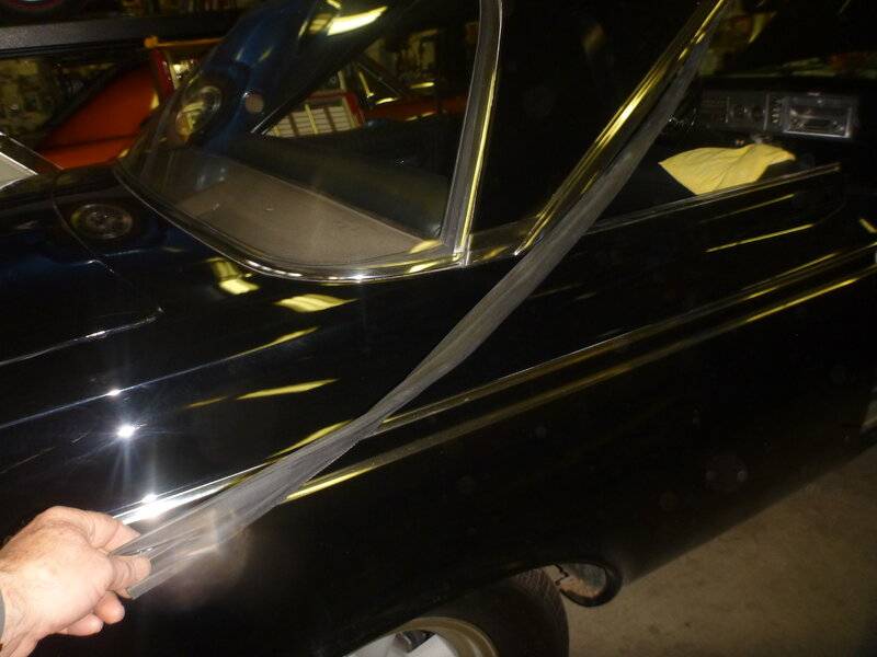

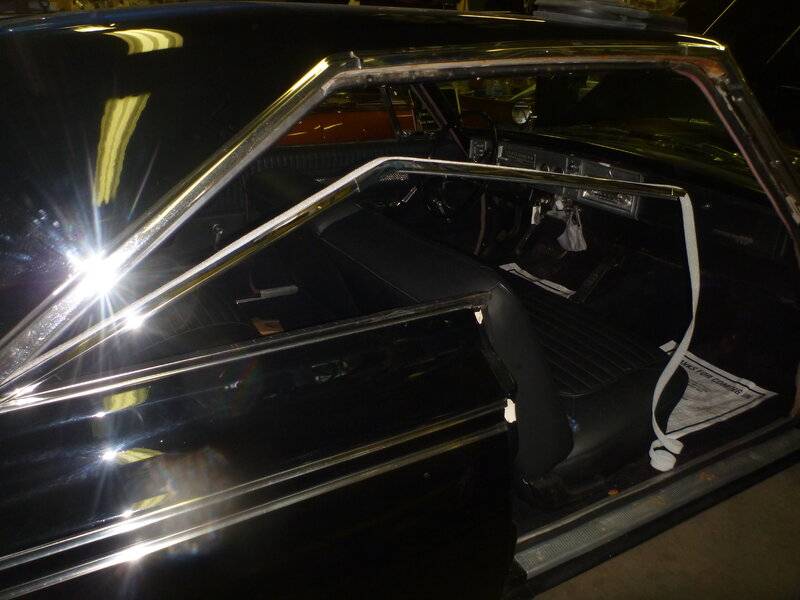

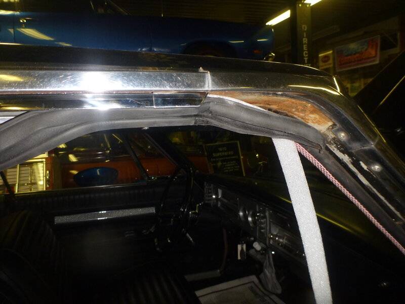

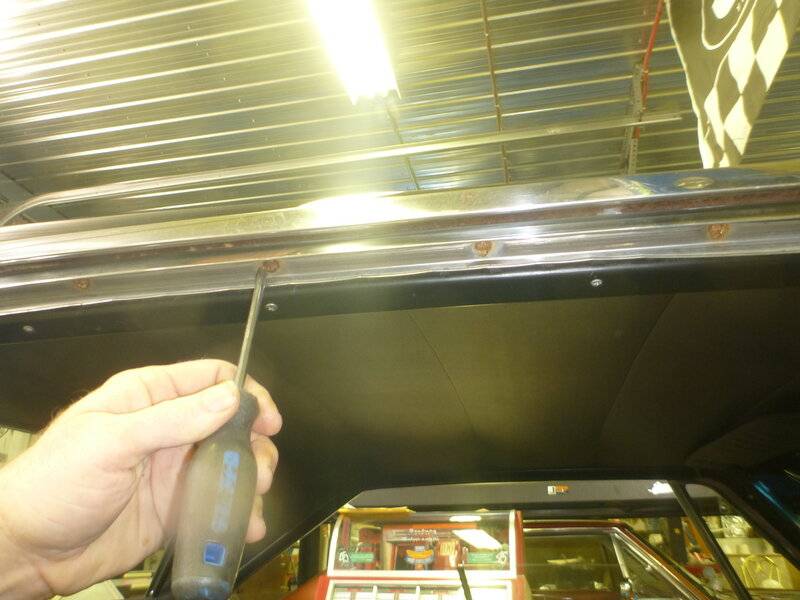

Wife said lets go for a cruise, but considering the temperature I thought some roof rail to window seals might be a good idea first. Removing the empty roof rail on the passenger side.
Stainless roof rail channel removed.

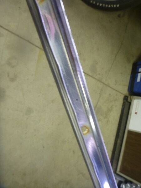

Someone beat it up with a screw driver prying, need to straighten the wows out first before new seals

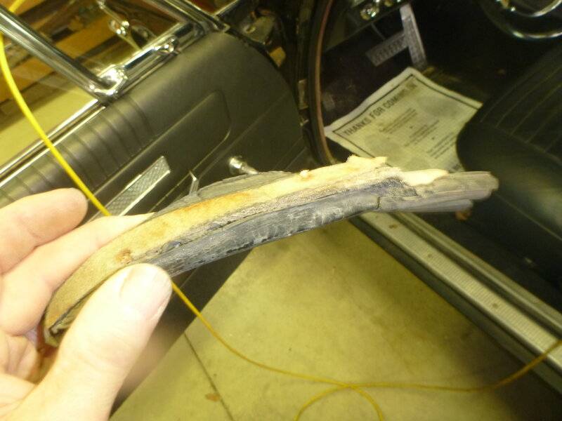

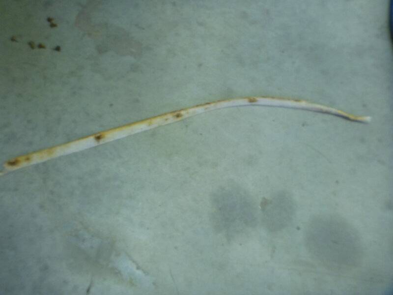

Original white foam seal strip between the stainless channel and the car body.

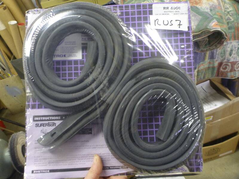

New roof rail seals. RR4006 from Soft Seal.
There is a left and a right.

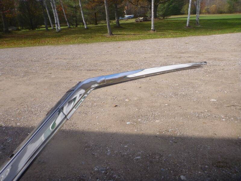

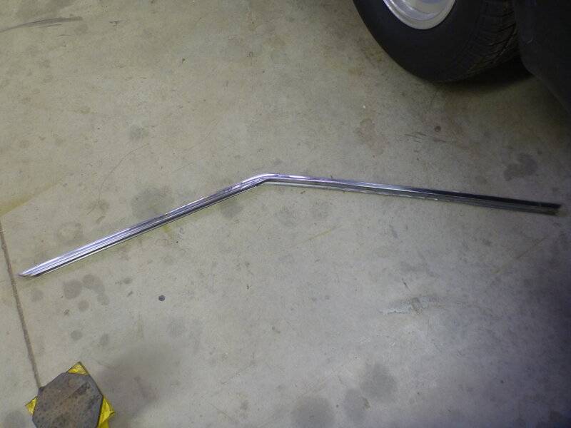

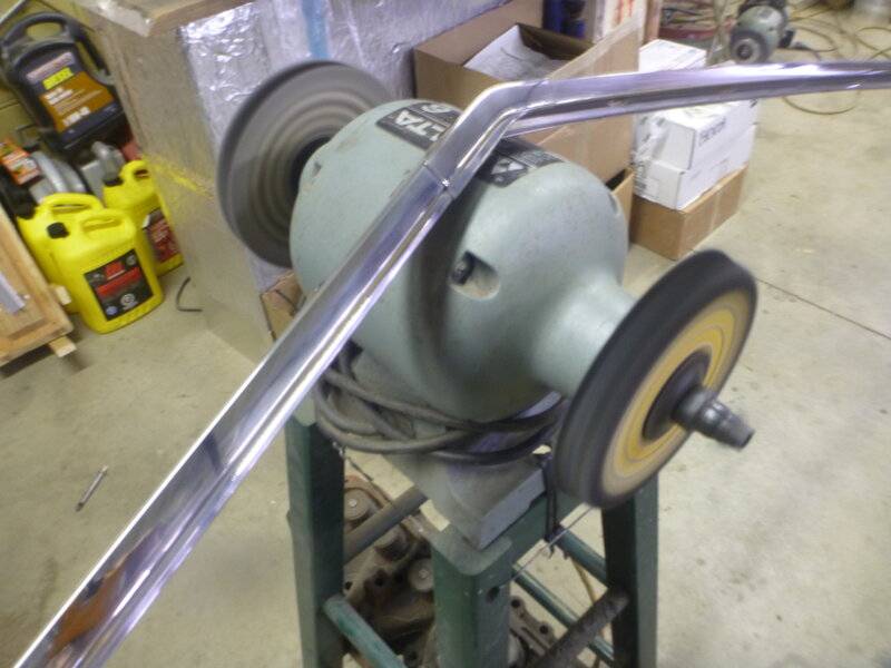

But first, since the channels are off the car they need to get polished. Black compound on the heavy wheel to get rid of scratches and then green on the soft wheel to polish.
That'll do...

New body to rail seals. 10 bucks US.
I put the new seal over the back end, set the channel into place and drapped the seal off the end. One screw hand threaded into the foam and then put the channel up into place.
Roof rail channel all screwed into place, time to install the new seal. Clipped in enough just to hold it and then put the two screws in the front end of the seal, which has a metal plate embedded in same.
Sure can't complain that they don't give you enough material.

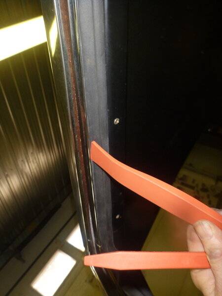

Some cheap trim removal tools work good for pushing the seal into the channel to lock it in place.
New seals into place and the door windows now seal nicely.
