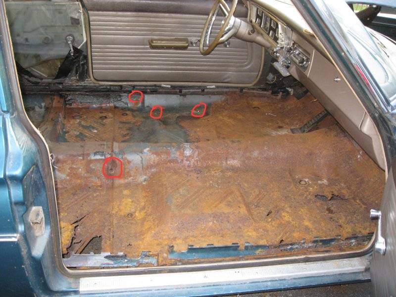

Best I can do is a ‘65. I would feel around for the hole, maybe with a screwdriver until you feel a soft spot and then use an awl to see of you can poke thru. Then a hot rod/soldering iron to make the hole.
BigFlo,
Thanks for the photograph!
On the drive shaft hump, do the threaded holes go all the way through the sheet metal or are they closed? HOLE GOES THRU.
Based on the photo, i will give your suggestions a try.
When I am successful, I will re-post.
Ok SUCCESS. From under the car, managed to fish a SS wire thru the bolt hole.
Thanks all for the help!!
Bob

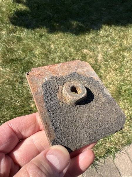

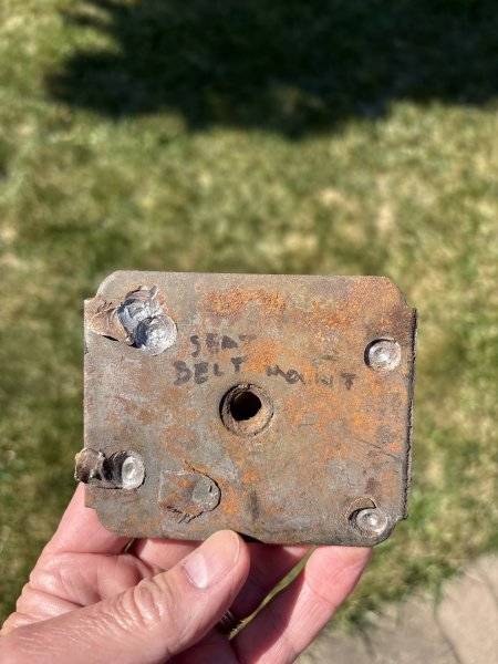

The holes go thru the sheet metal. There is a reinforced metal plate that is welded on the underside of the floor pan, with a nut welded to that plate.
^^^That plate is in the tunnel area. One on each side
Those plates come with an AMD replacement floor. Maybe they sell them separately, as well.
