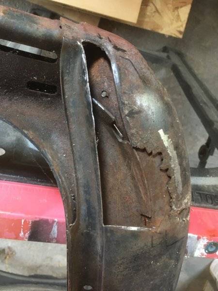

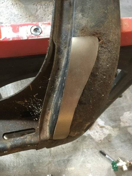

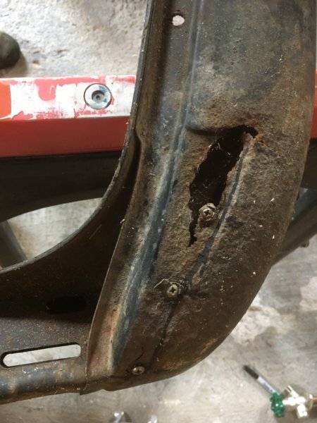

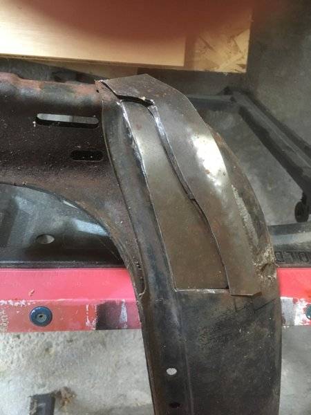

Here is my nightmare.
92108896-07BF-4BDF-A49C-96AC117E3EB0.jpeg 89D9A2D7-0D57-4FF1-AE35-A067999AC950.jpeg 88E1769B-4A8D-4450-A3F2-58571AD1ED36.jpeg 8BADD6AD-C27D-45B5-96E5-10B37C59CD08.jpeg

Guess I'll type this to one more time... On my 68 Coronet I had the same issue, I re-skinned the whole topside.. I used the leading edge of the roof off a 4 door sedan parts car... I still had to form the pockets for the top pads at either end but the majority of the piece feel into place, the step down for the windshield gasket became the flange that bent around the leading edge of the top frame... Att the back I left the original step on the top frame & overlapped the new metal similar to whats shown above...
Interesting Wild R/T. I'm gonna look close at my parts car and see if it'll work for me. Honestly an idea I hadn't though of.
