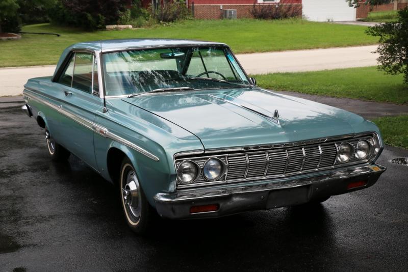

Here is the car, just for reference. I believe it was purchased from long time California owners in 2003, brought to midwest, then down to Arkansas. I bought it from the owner in Arkansas.
Arvid Svendsen
From what I can tell, the car had one repaint that is a closer to the turquoise color. I believe the engine compartment was not painted, so yes, the fender tag is far from pristine. Glad to confirm the car as a 383 4 bbl car. I was told that the car should have "383" on the hood ornament, but I'm hoping that is incorrect since my car has no engine size on the hood ornament.

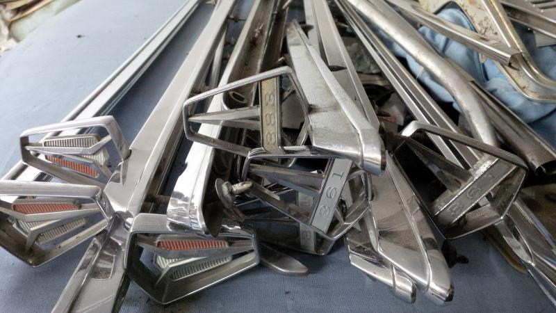

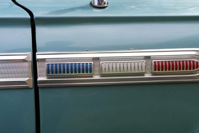

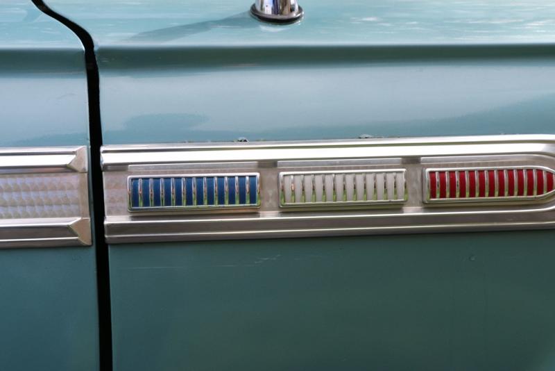

Goldencommando, your picture has no engine callouts on the red white and blue ornaments that I can see. I believe those red white and blue ornaments are Sport Fury only, to match the red white and blue Sport Fury side molding, correct?
But I take it that you are saying the red white and blue ornaments were on a non big block Sport Fury? a non big block Fury/Belvedere? The ornaments with engine callouts, are they Fury or Belvedere only, or are they also on a Sport Fury?
Thanks again for the help!
Arvid Svendsen
Any big block 64 no matter if it was a Savoy or a Sport Fury would have had the callout ornament. The plain red white and blue were used on anything from a Savoy, Belvedere, etc. that was not big block equipped.
