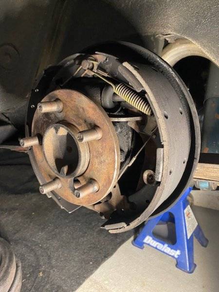

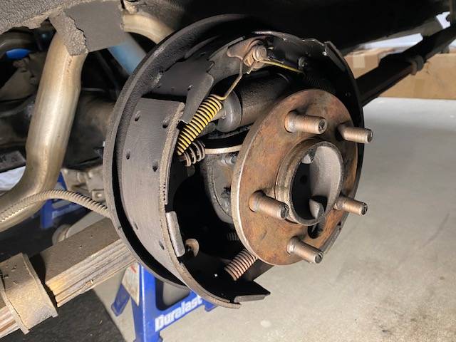

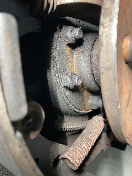

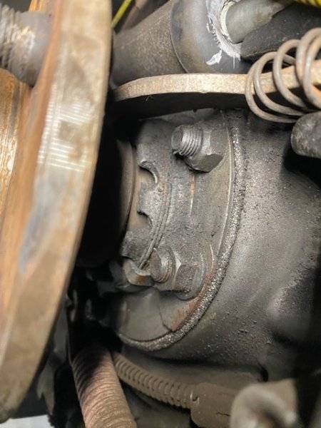

Update: the drums, pads and wheel cylinders on both rear wheels look perfect. The emergency brake deploys and releases on both wheels and both wheels stop equally with the car on jack-stands. The drums also come off with ease. What I did notice is that the wheel bearing retainer is different on either side. (See pics) The pic of the wheel that overheats is IMG_1932. Any thoughts? Thanks!
Normal. Only one adjuster.
No problem with the bearing retainer plates - that is stock. The different look is the rear axle bearing adjuster system.
Check the rear axle end-play.

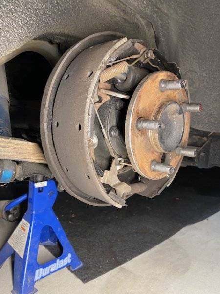

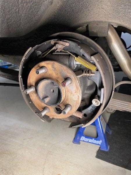

Post a picture of both sides showing the shoes.
Driver is the wheel that gets so hot after a 30 minute drive that I can't even touch the drum (even though no smoke and no noise). The 3 other wheels are only warm at best. Both drums were cut and look smooth and have meat left on them. Thanks!

Looking at the pics, it doesn't appear the brakes are dragging to create the overheating. That leaves the bearings, and axles. I know bearing adjustment has been mentioned, so again check that. But you also said No Drag when rotating. I would think, with the overheating, you would start to see some seal leakage, as those would be showing signs of excessive heat cycling. This may be a dumb question, but do you have the proper level of diff fluid in the case ? Could the heat be transferring through the axle, to the drum ? Just throwing this out there to eliminate that possibility...
