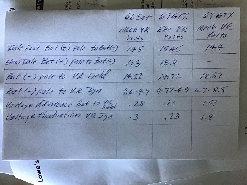

I’ve been playing around with mechanical and electrical voltage regulators on my 67 since my last post and consulting with Halifaxhops some and we’re stumped. The car (67 GTX) behaves fine with an electrical voltage regulator - it just charges at 15.3 to 15.5 volts - to high IMO. I’ve tried a couple different mechanical regulators on it that work fine on my 66. Here is what I’ve done:
- verified the amp gauge connections are tight
- pulled the bulkhead plugs, cleaned with De-Ox and treated with No-Ox conductive grease - contacts were cleaned up years ago and continue to look brand new.
- checked water levels in battery cells - all good - none needed
- pulled ignition switch from plug, cleaned both with De-Ox - put back together.
- checked field connection at alternator and verified tight.
Afterwards tried one of the tried and true mech VRs I used on my 66 and still have a dancing amp gauge. Here are my voltage checks. The thing that seems off is the low voltage on the field side of the voltage regulator and the voltage fluctuations from neg battery to Ign side of the VR. It’s a rebuilt alternator, maybe 5 or 6 years ago. Sort of suspecting it has some weakness ( maybe diode?) that an electronic VR masks but which mech VR doesn’t play well with (?). Both cars running points. The 66 has all new wiring. The 67 has all original wiring, very few repairs and everything works.
Anyone have any thoughts on this. I would really like to get rid of these high voltage, voltage regulators. I have 3 of them and they all put out over 15 volts.
BTT - got the name of a good, local alternator rebuilder so planning to pull it out and let him look it over.
If anyone has any other thoughts on wiring/connections checks, please let me know. The Bat (-) pole to VR field terminal voltage reading (12.87) seems really low compared to battery voltage (14.4) with the mechanical VR. Even with the solid state VR it’s low compared to my 66 Sat.

You may be right but I tried a mechanical VR from my 66 that was dead smooth on it (amp gauge needle steady) but when I put it on the 67 the the gauge needle jumps all over the place and the lights are flickering. That, and my already somewhat higher voltage loss from the battery to the VR field gets even worse. Yet, somehow - except for a little too much voltage loss - with the electronic VR installed on the 66, the amp gauge is steady as are the lights. Both cars are pretty stock with standard single field alternators and points distributors.
My thinking has changed now, and I think I need to follow the FSM test for trying to find the source of the voltage loss on the battery to VR circuit. The starter is the main item I haven’t inspected and cleaned connections on so I need to get under there and do so. Hope to do that today. If that doesn’t fix the issue then I’ll have the alternator checked. Really like to get away from the electronic voltage regulator since I have 3 of them and all are putting out between 15.3 and 15.5 volts.

The physical attributes of the two systems are slightly different creating differences and it affects/performance. A voltage drop test is always a good idea although a few tenths of a voltage may difficult to pinpoint. The difference MAY BE due to brush connections, rotor resistance, slight difference in diode conduction, stator impedance, etc. and of course the difference between "identical" systems and mechanical voltage regulator manufacturers tolerances....just my opinion.....

On this particular car, Halifaxhops helped me identify in mid-Jan that although an alternator rebuilder tested my alternator and pronounced it good by test, it was non-the-less probably producing a bad DC signal to the VR. I looked around for a source of another rebuilt alternator that I felt I could rely on and got it installed today. It has fixed my jumping alternator gage issue i was having with a mechanical voltage regulator.
So now I’ve successfully converted both my 66 and 67 from 15.2-15.5 volt output electrical voltage regulators, to mechanical voltage regulators adjusted to put out around 14.1-14.2 volts warmed up. Finally.
