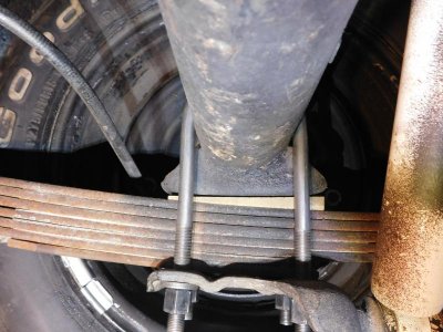

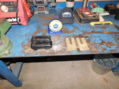

I need opinions before cut of my leaf spring perches to relocate the pinion angle. I have had a hard vibration for awhile and I want to get it fixed. I checked the angles of the rotating assembly and found the motor and tranny
to be 2 degrees facing down on the tranny tail end, the drive shaft at zero, and pinion angle facing up almost 2 degrees. I put in a #4 brass shim and most of the vibration is gone. The rear axle housing is a 489 case not sure what car it came out of but, Im sure not the original to this car. Question is I thought they were all pretty much set up the same from the factory 5 to 7 degrees facing down. New hemi leaf springs installed few years ago. DSCN0226.jpgDSCN0235.jpgDSCN0238.jpgDSCN0236.jpg

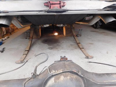

For some reason I can't add anymore information with photo's on this thread my computer freezes. well anyway with the perches level on the jack stands the pinion angle is 2.5 degrees facing up. When I turn it down to 7 degrees the perches look way off. I am kind of holding of relocating the perches until I get a clear understanding of what is going on here. 489 case in a 1965 satellite with new motor and tranny mounts, drive shaft newly balanced. tires and rims spun balanced should not be vibrating. Any Ideas?
Spring perches are mounted on the housing parallel with the centerline of the gear case. Is that how you have it? But, both front and rear spring hangers, and the springs themselves affect the resting angle of the axle housing, once all mounted up.
Just things to consider. Engine/trans mounted sets that angle, at the front of the driveshaft. Should be slightly higher than the rear axle...that's what sets the driveshaft angles front and rear that's needed to knock out vibration. Just saying look at the whole picture. Good luck on it!
