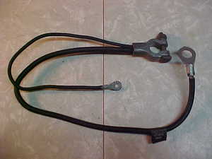

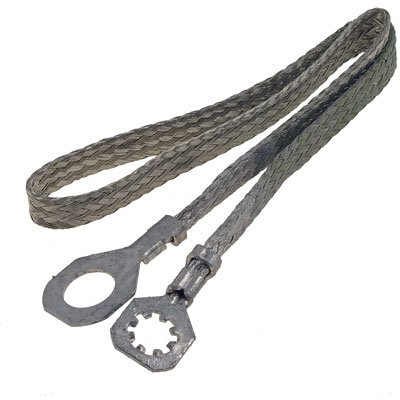

Your major ground points will be the negative battery cable, which should go to the engine block, and the inner fender. There should also be a braided ground cable at the rear of the engine that goes to the firewall.
Got the battery cable from the block but, I do not understand the (to the inner fenderwell) comment. I do not have the braided cable from the block to the firewall, also, stupid question but being on jackstands should not bother? Do you know about where the braided cable should go from/to on the firewall? Thanks.
ground strap.jpgnegative cablw.jpg here are examples of the braided ground strap that attach to the back of the right side head and attaches to fire wall, and the negative battery cable has the thicker wire that goes to the front of the left head, and the smaller wire that goes to the inner fender. or somewhere to the body.
