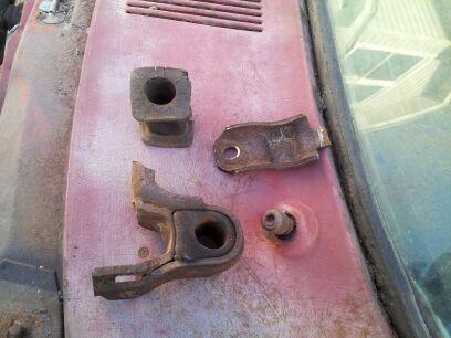

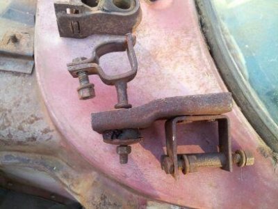

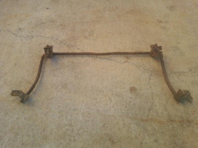

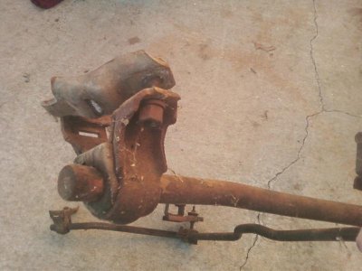

Here are the actual brackets that came off the car. If that helps...
you can make the later sway bar work, but you have to change lower control arms.
I have heard that you can get end link adapters that bolt on with the lower shock bolt.
And yes, you have an early production car with 65 K-frame.....there are new rubbers out there, but hard to find.....Try PST and go from there
