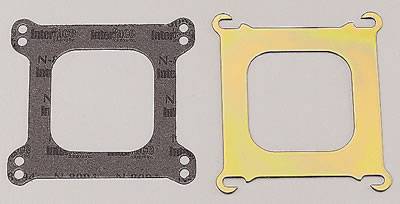

One question. I want to put a spacer in. I need to use this vacuum adapter for use with my 2186 intake. Do I still need this with a square bore spacer? If I do, would it be: gasket - adapter - gasket - spacer - gasket - carburetor? Or no?
