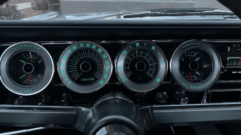

This might solve my issue with the tach, it's just stuck at 3,000 rpm, no movement at all. That's basically the only issue with the car, is this circuit board the likely fix?
my guess is no but it is just a guess
The needle is stuck at 3000
that's in the gauge
if it was on zero and not reading then you could suspect the sender
