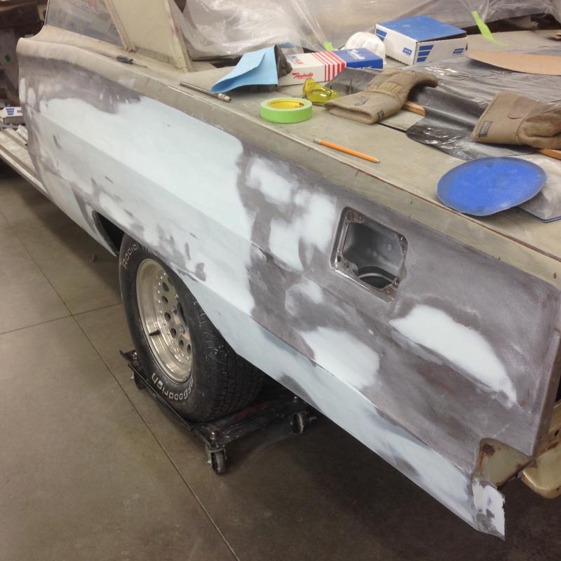

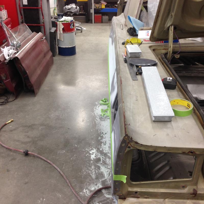

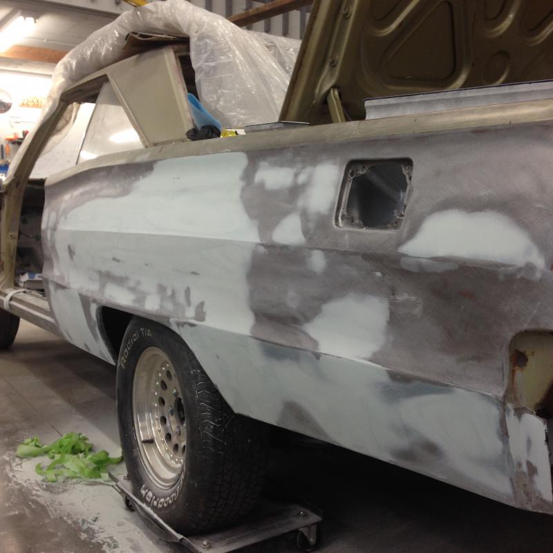

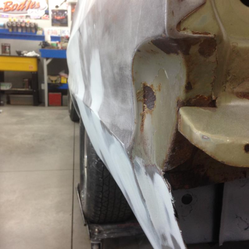

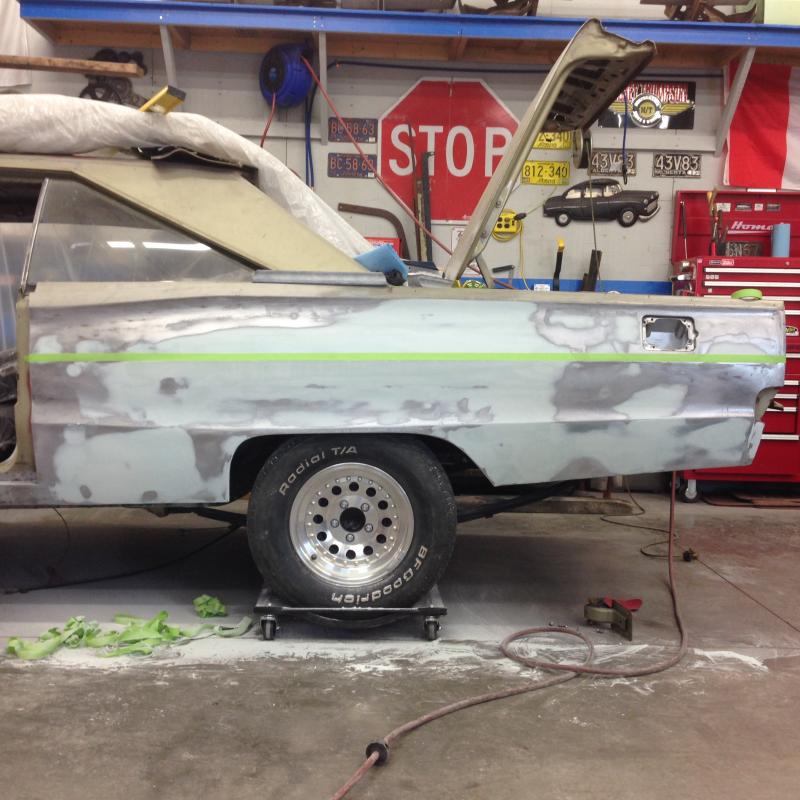

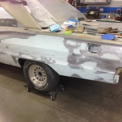

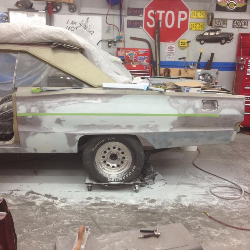

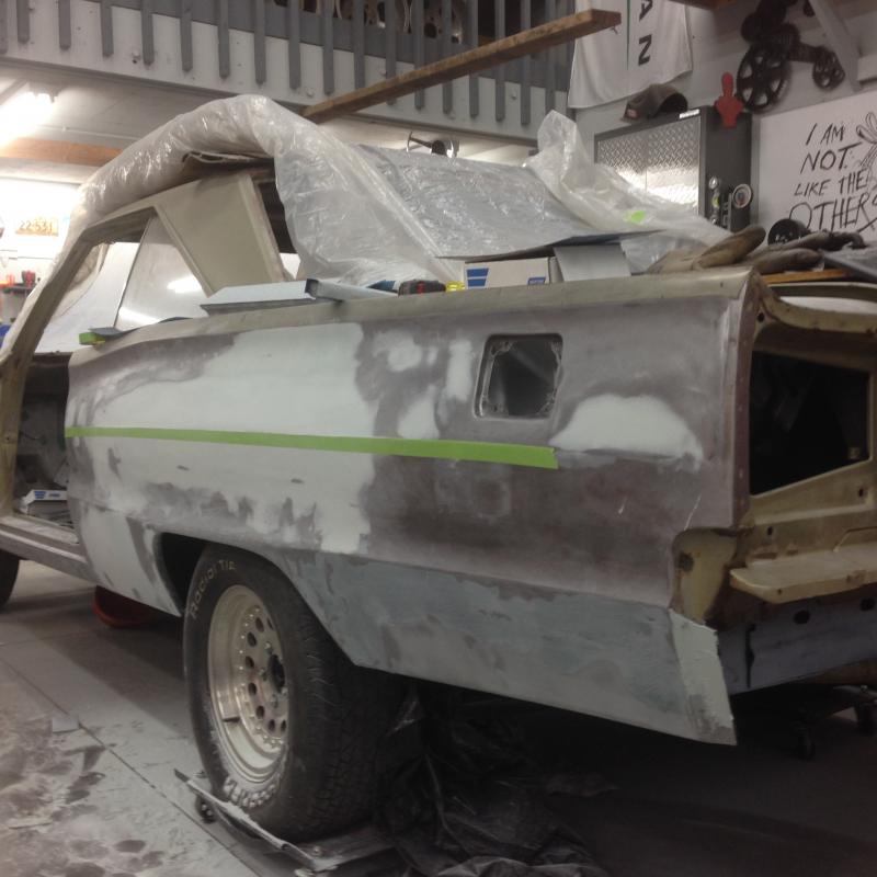

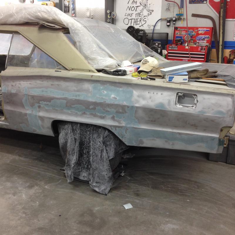

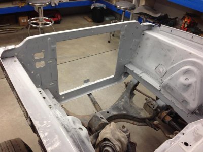

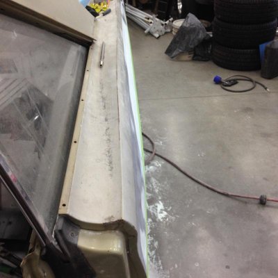

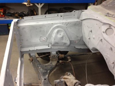

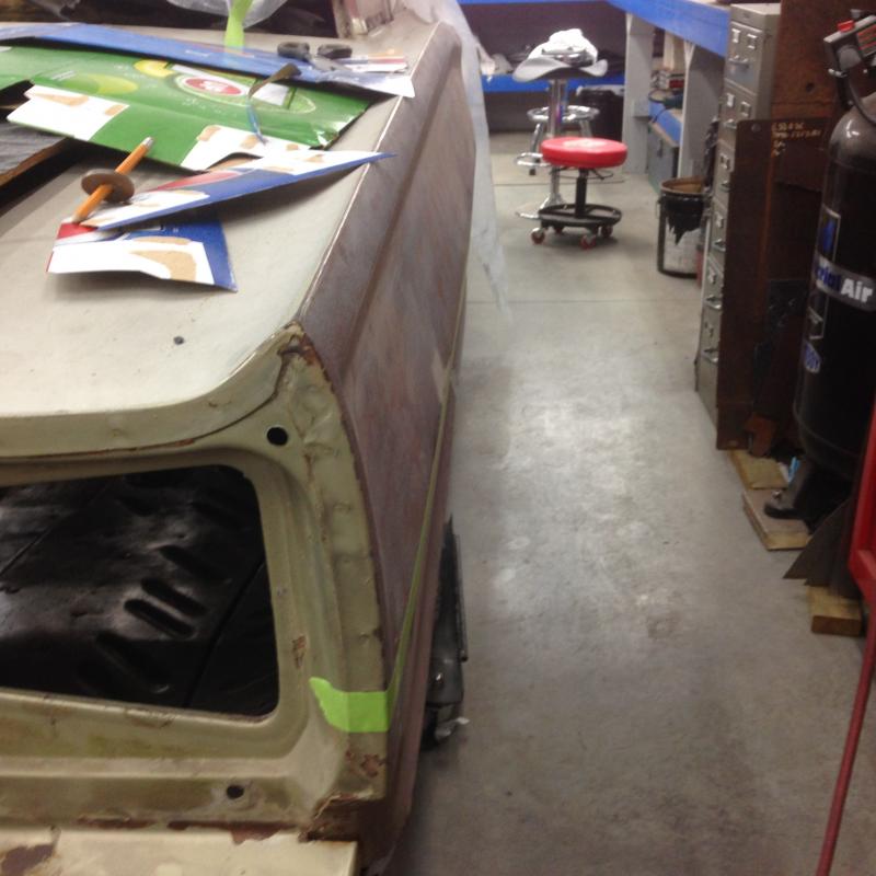

Today I got ambitious. I still can't decide on color so I figured I would start the putty process. I'm torn between silver, grey, stone white (like my Challenger) or a burnt orange metallic. I've seen more "goldish" cars lately and I am really starting to like them. Oh well, lots of time for that. Anyway, I got the first coat of Rage short fiber over my welds. Roughed them down with 80 grit and cleaned it up. Tomorrow I will likely lay some putty on. This will be the hardest side due to my screw up of cutting the panel out for the patch. I figured out too late only to use the minimum amount of a patch panel that is required! Lesson learned.
