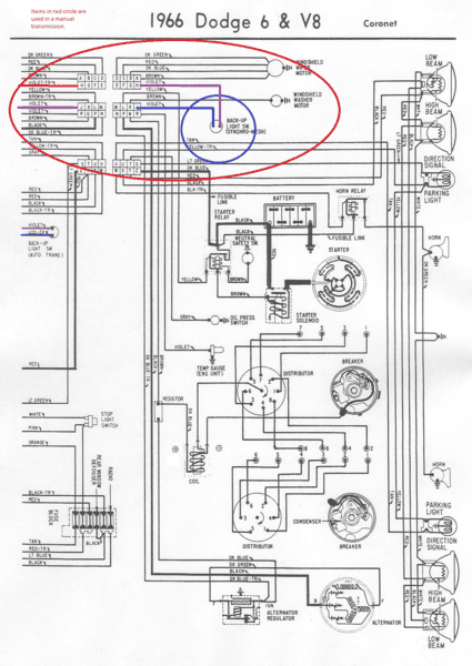

Im seeing them as console wiring.
If you have a manual transmission the violet striped wire is used as a reverse light and goes to a switch on the manual gear box. Which wouldnt be used in an automatic car. This is why its a dotted line in the schematic.
Since you have an automatic the wire colors are violet and violet/tracer and should be in hooked up to the neutral safety switch on the transmission. Look at the schematic on the left side you will see the " backup light switch".
Follow those 2 wires and you will see one goes to the wiper switch. The other goes to terminal 4 on the rear lighting harness. Follow it further and it goes to the back up lights.
The pink wire goes to the dome light. These are the 3 wires you are looking for. But the 3 wires are in a console connector which would feed the 2 console lights as well as the dome light.
The pink wire also goes to the brake light switch.
The items in the right side page circled in red are only used if you have a manual transmission. Left page shows the routing. And followed by the right page the back up switch wiring. left side middle of the page.

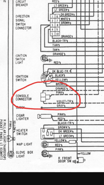

Thanks for the reply. A previous owner has removed the neutral safety switch so the violet and violet white tracer were tied back. The reverse lights too are now gone in place a direction indicators so the back up switch doesn't need to be wired in.
So that leaves just the one violet white tracer that goes to the console selector in my attached image below. Is this needed or can it be removed? I assume the pink and orange work as a circuit and the violet white tracer isn't needed?
This will then leave nothing on terminal B of the wiper switch. Can you see any problem with this?
