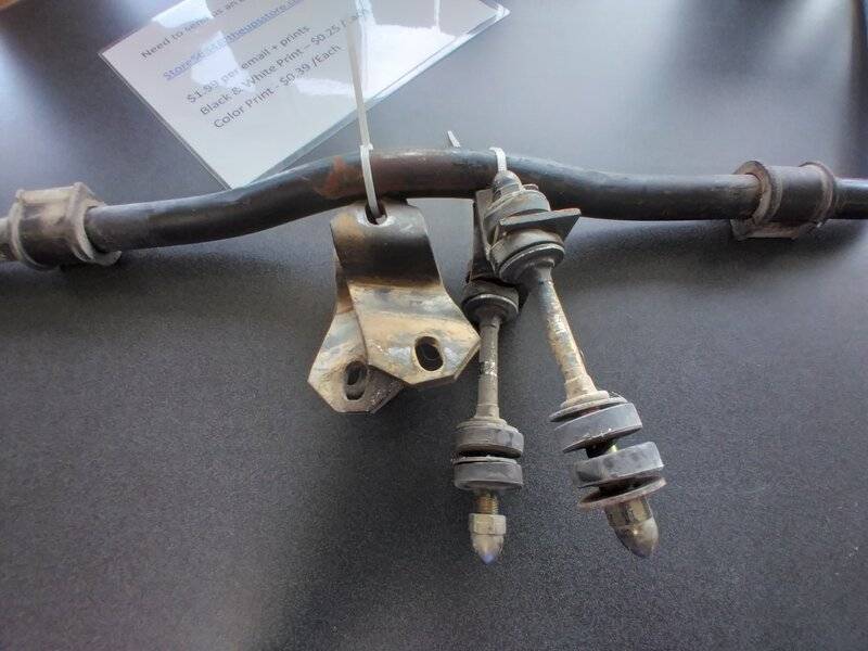

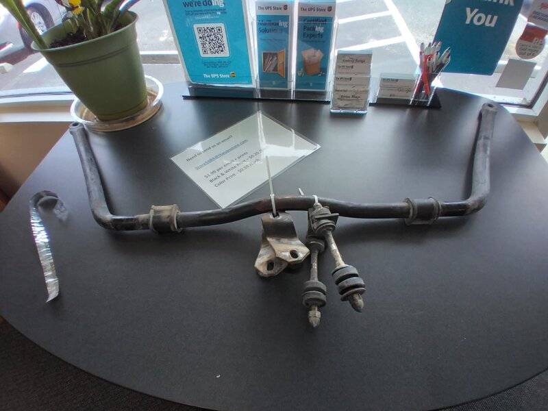

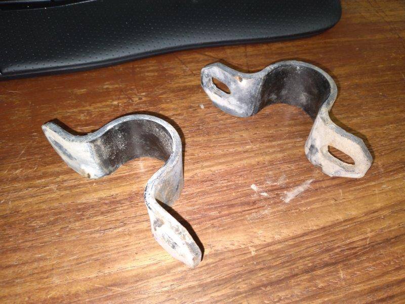

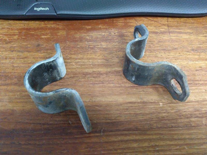

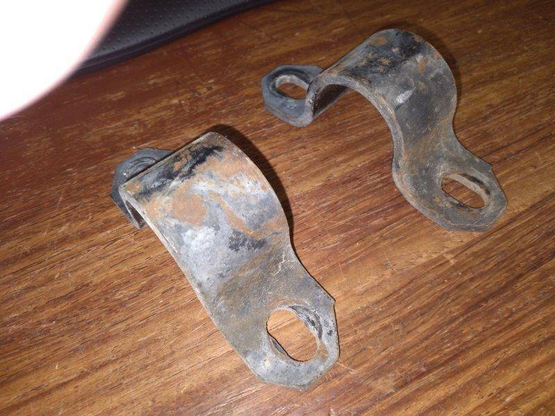

Front sway bar bracket pics?

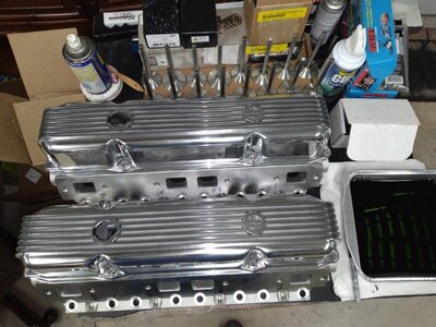

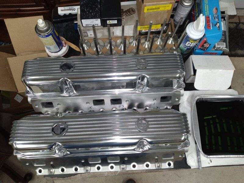

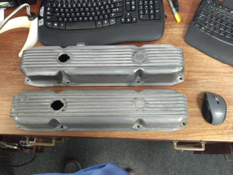

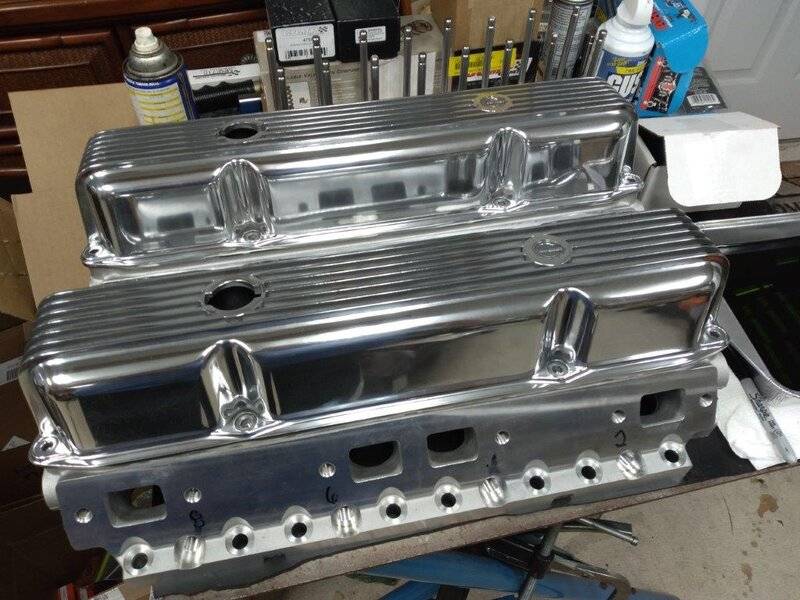

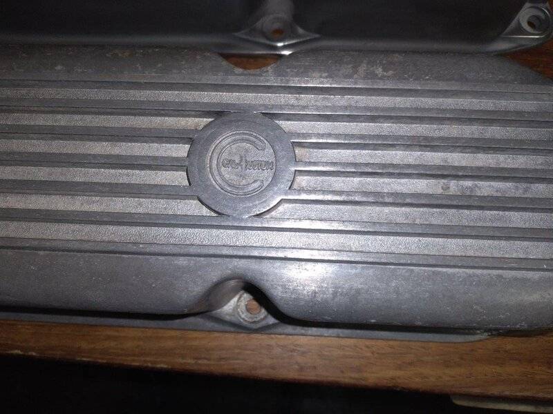

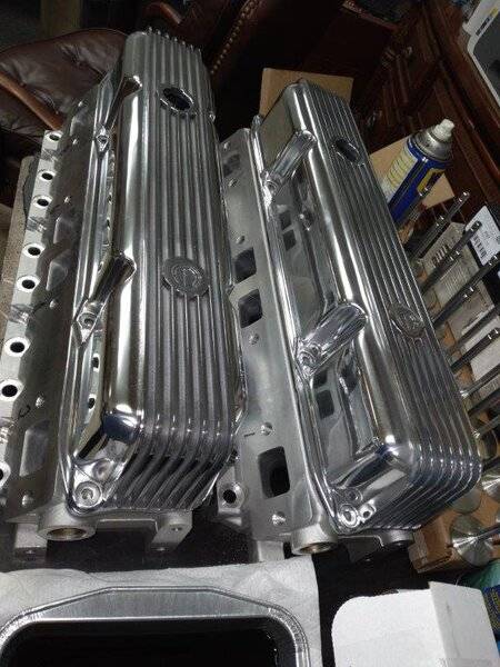

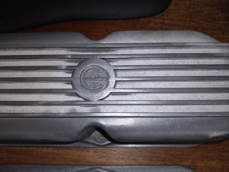

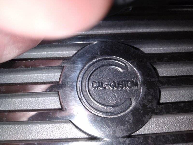

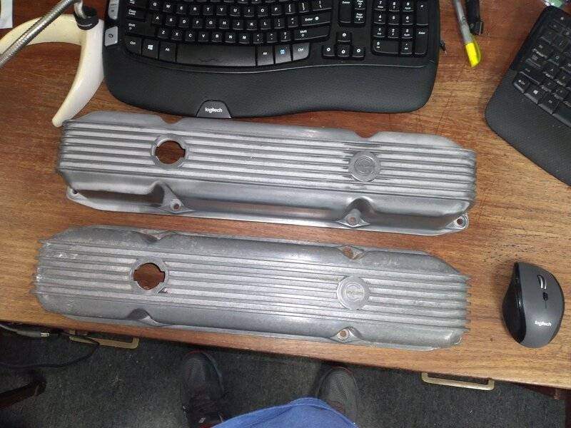

Picked up a ratty old pair of Cal-Custom valve covers. I tried polishing them but I suck at that stuff. Bit the bullet and used All Metal Polishing of the Palm beaches and the transformation is shocking, see pics
Before pics first and after pics in the next thread
Chuck
20210831_132939.jpg 20210831_132950.jpg 20210831_132957.jpg 20210831_133003.jpg 20210914_191323.jpg
He's good! Text him @ 561-723-8039, tell him Chuck Emery sent you. About two weeks from drop off to pick up for my set - they were bad, pitted. They will look great with the Day 2 I'm doing on the Coronet.

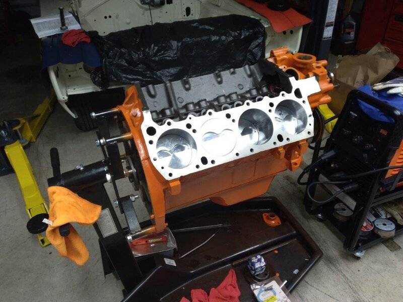

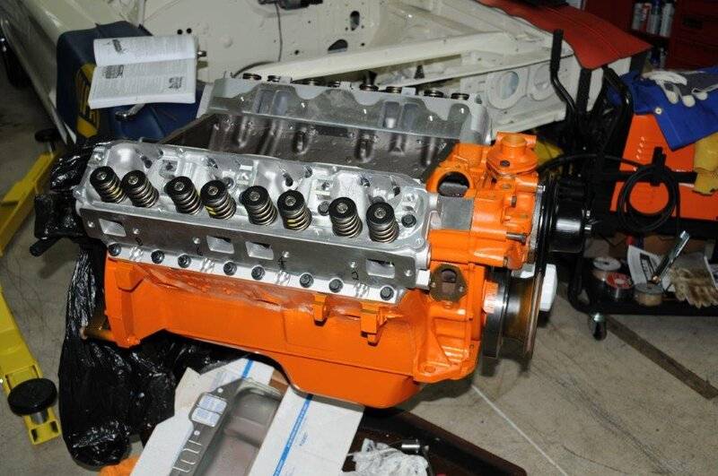

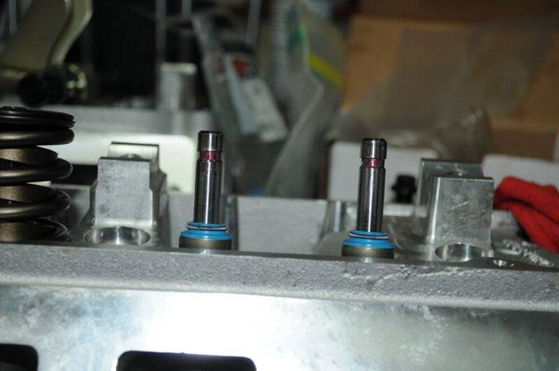

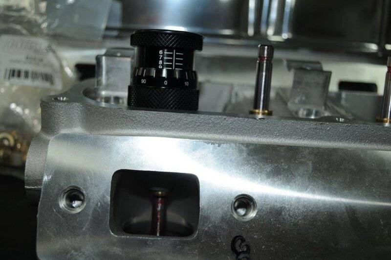

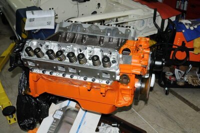

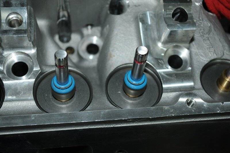

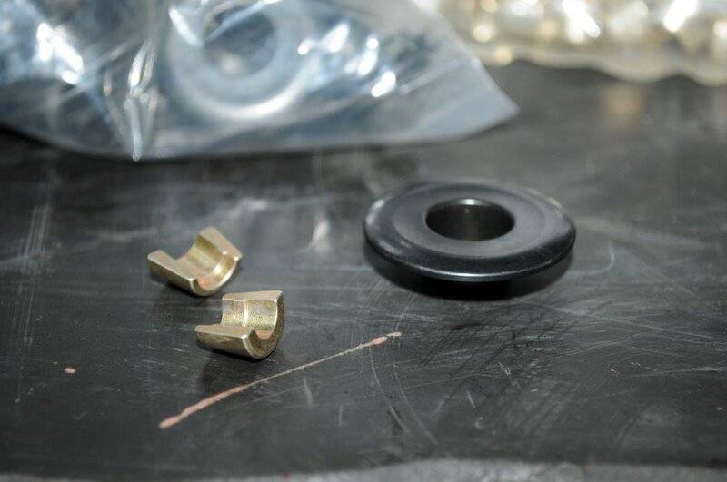

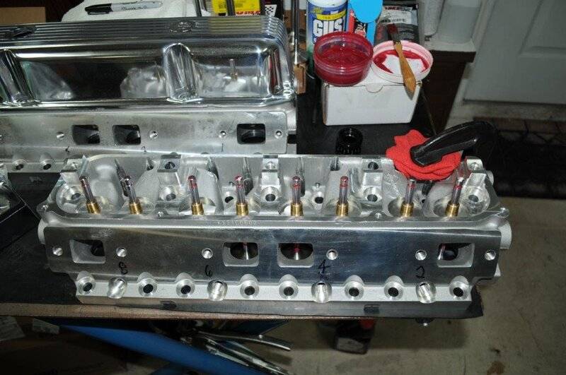

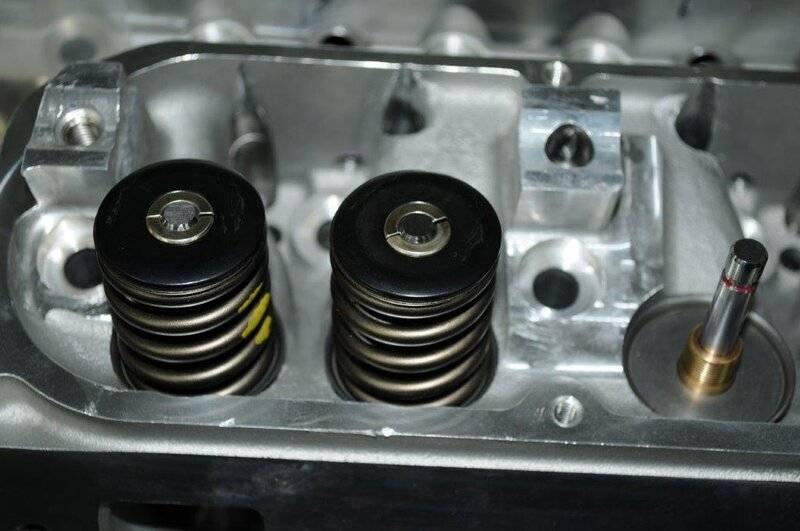

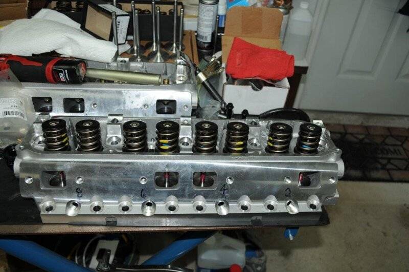

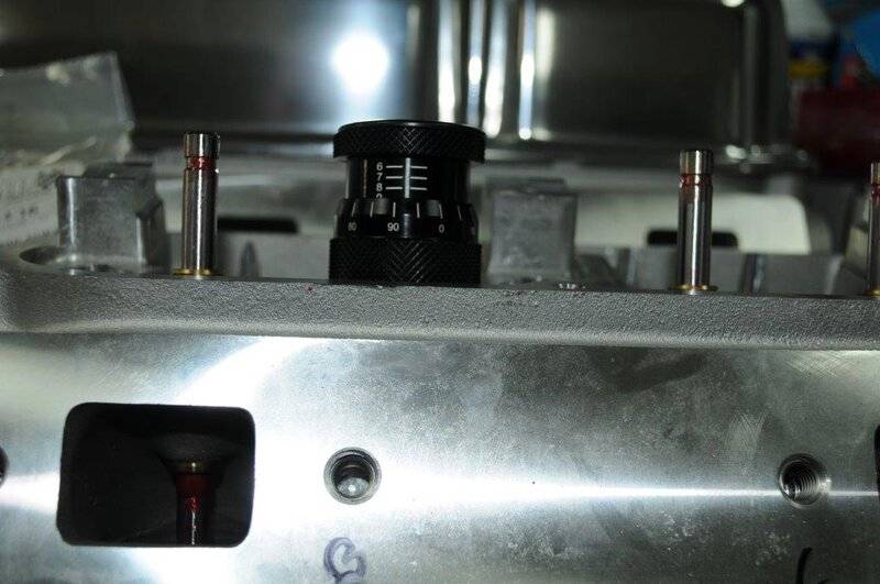

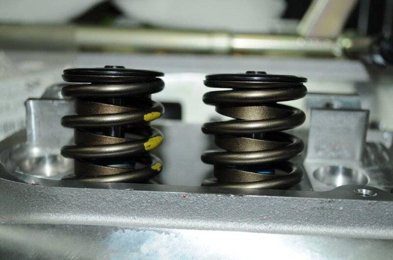

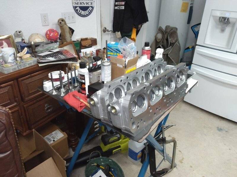

Setup the springs on the heads tonight. These are Stealth heads with comp 924-16 double springs (outers installed for break-in, I will install the inners when it's broke in on a dyno). The install height is 1.9" +/-0.020 (1.880" - 1.920") - installed heights were coming way too short, averaging 1.850" - 1.865". I elected to go with Comp 614-16 +0.050" keepers, installed height after installing the +0.050", were right in the money, from 1.895" - 1.910" across the board, most of them on the money at 1.9, I had to shim two springs though.
The valve seals are Comp Viton units, retainers are Comp 10* as well as the locks (+0.050").
You can see from the pics that I'm using the Comp spring height micrometer - made this a breeze and knocked it out in no time, I highly recommend getting one or borrowing one, it will make your life easier and take out some of the guesswork. Very easy to use, anyway see the pics.
Chuck

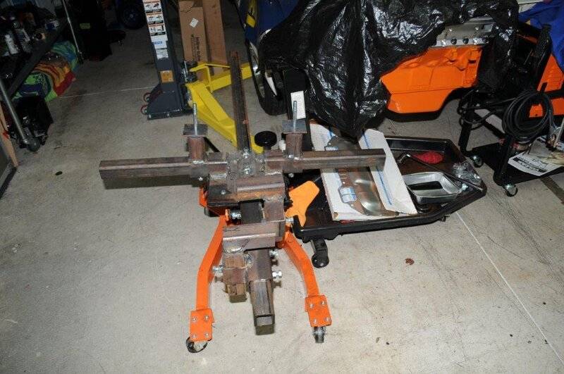

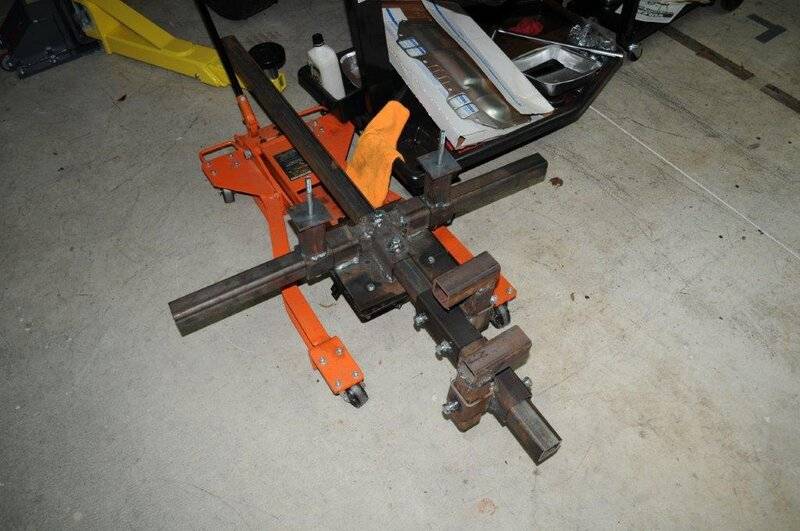

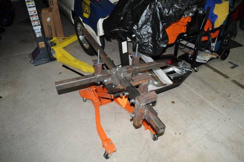

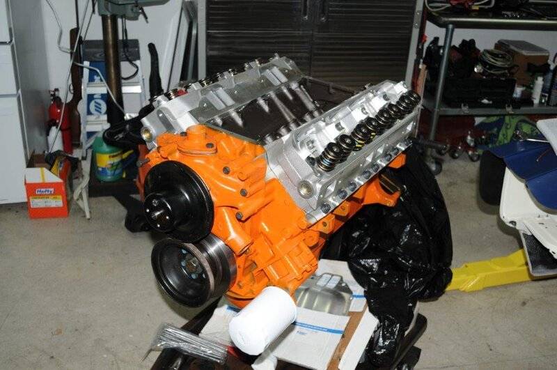

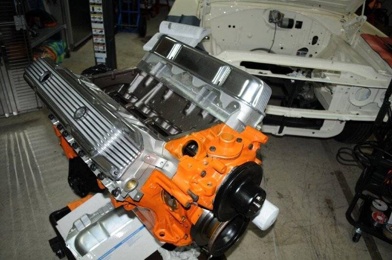

Coming together, should be ready for motor/trans installation in the next few weeks and then break in. I built this K-member fixture that bolts to a Harbor Freight trans jack that I had laying around - it's rated for 2000 lbs., see pics. My welds suck I know that but they are gorilla welds and will hold.

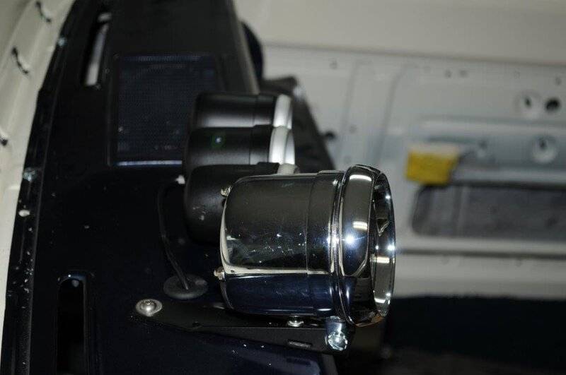

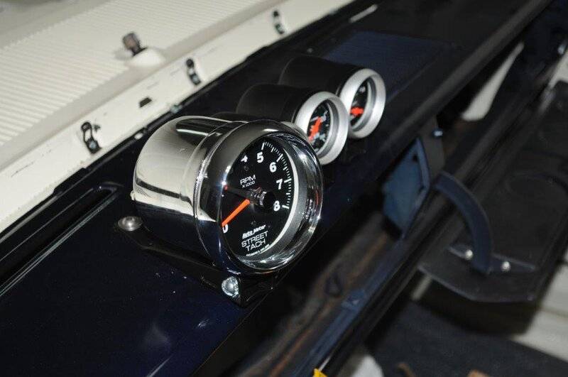

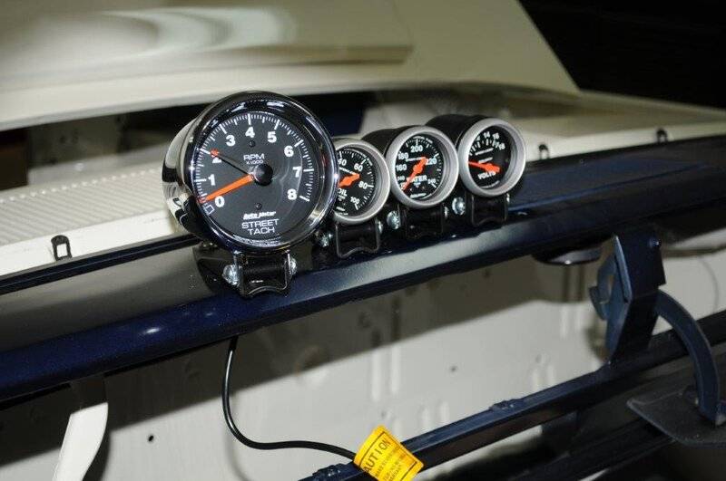

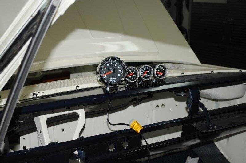

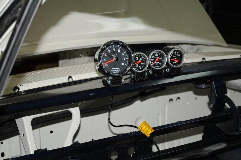

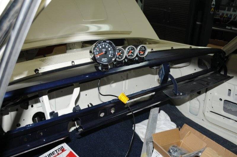

Mounted the gages. Most purists won't like it but considering it's an original slant six car and I'm a racer at heart and the 66-67 B-bodies don't lend themselves to optimal gage mounting, I chose this route. See pics, still need wiring run but should look OK and be functional for what I need them for.
