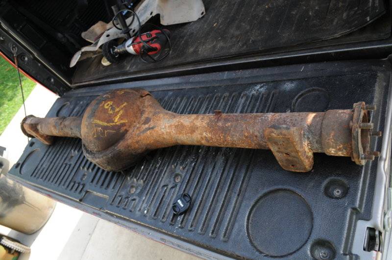

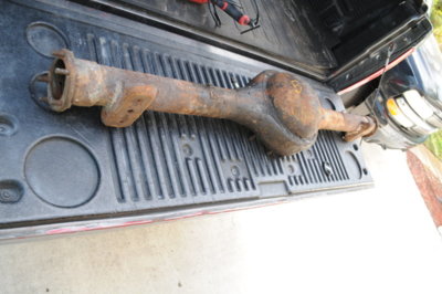

Hit a snag yesterday when I started putting the rear end together. I share part of the blame with goober on this one, as I didn't measure the rear before I started ordering parts. I pulled my new Dr. Diff axles out and they are 2"+ shorter than what came out of the rear. I thought I got the wrong axles but it turns out that goober swapped in a 71-74 B-Body housing in place of the 66-67 housing - the 71-74 housing f2f is 57.75", while the 66-67 is 54.25". Whoops, I got the right axles for a 66-67 rear which I thought was what I had. Luckily a bud knew where a 66 8-3/4 housing was and I picked it up this AM, so I didn't lose too much time but spent more $$$ but that's OK. I'll start putting the 66 rear together here in a bit, so I get to do the same work over again (painting, cleaning, etc). Considering on the cobbled up state I got the car in, I should have measured and verified everything - there's nothing left to replace now as this makes a complete swap of parts for good ones.

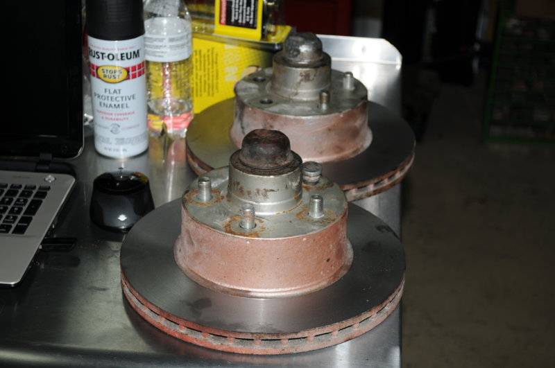

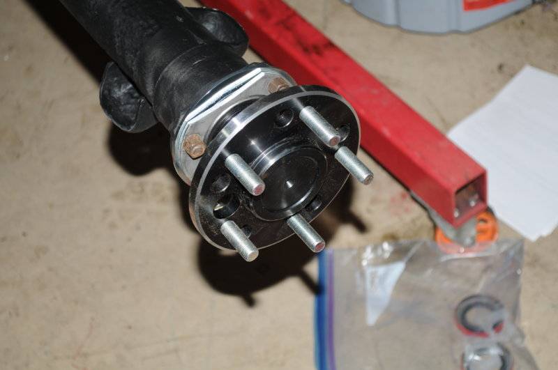

I decided to go with a rear disc brake setup from Pirate Jacks, the only thing I could salvage from the original rear drum setup was the backing plates and e-brake cables. The Pirate Jack disc setup was $370 complete with free shipping. Even comes with right length e-brake cables for my 66 B.

I was getting ready to buy the parts for my 489 case (non-suregrip open) when I stumbled on a good deal for a new complete 489 punkin with a powerlok suregrip, Richmond 3.91:1 gears for $400, so that saved me a bunch as the powerlok alone was $400+.

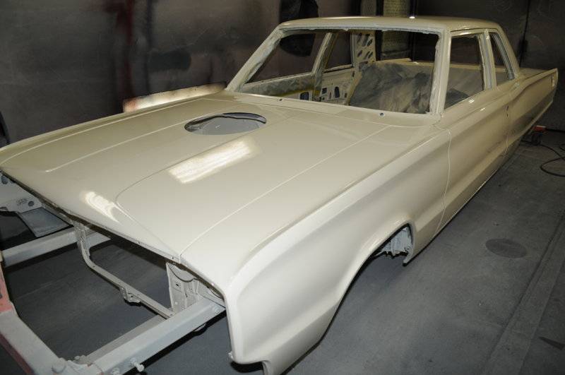

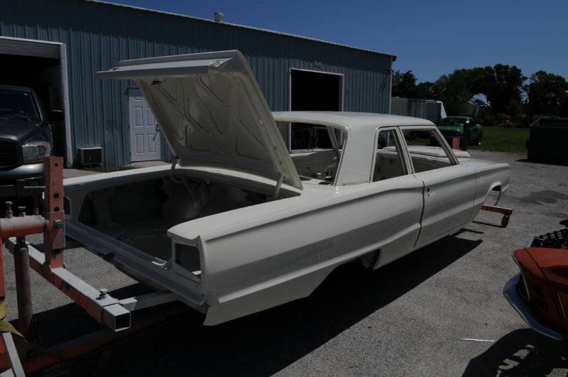

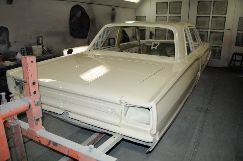

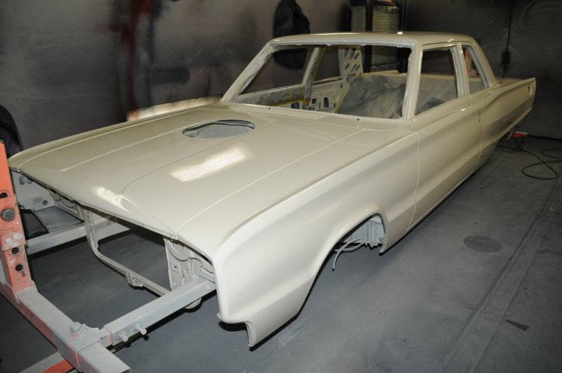

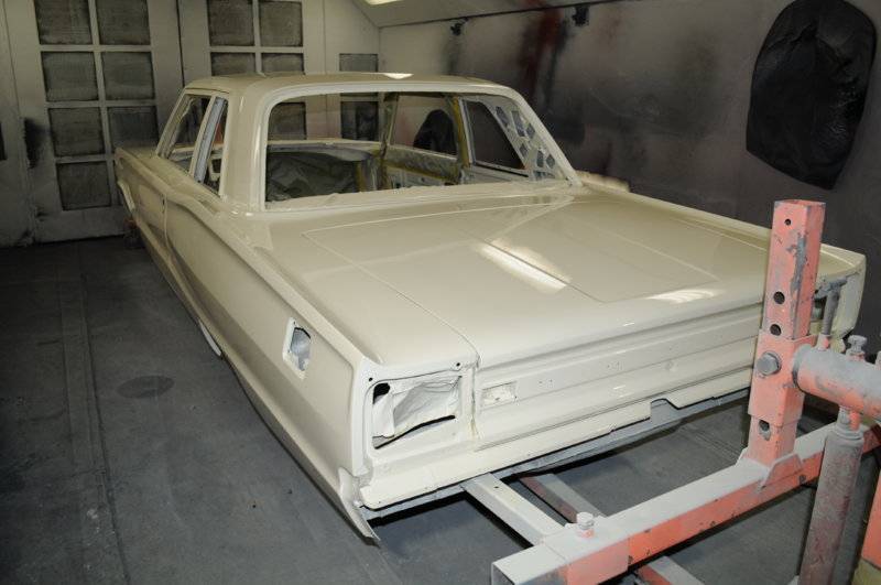

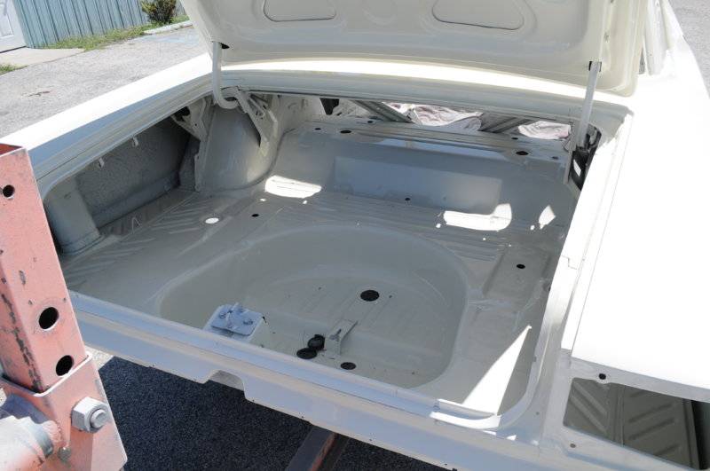

Car was out of paint a few hours ago, those guys did a hell of a job. That WW1 single stage laid down real nice almost looks like a B/C paint job. They will finish the bottom this upcoming Monday and mount the S/S scoop and quarter extensions (tail light housings exterior. Here's a few pics.
snook

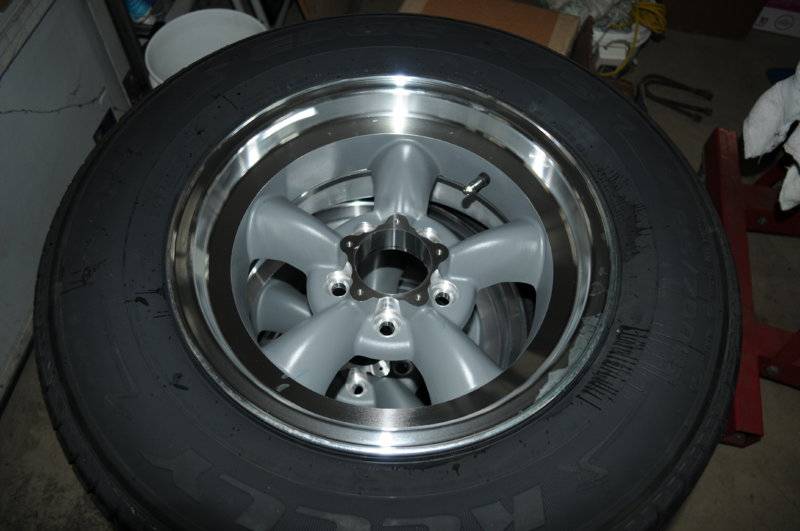

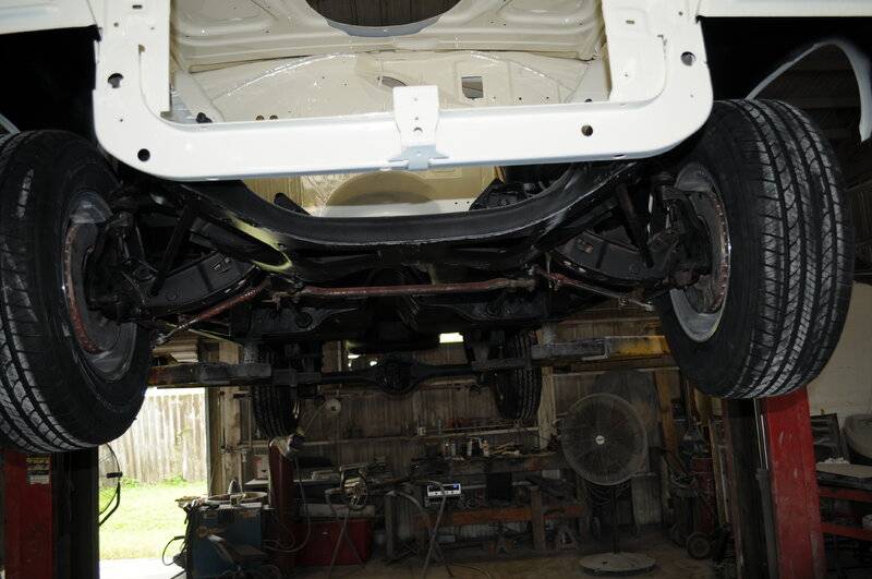

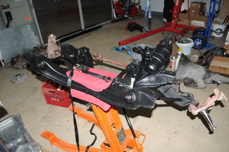

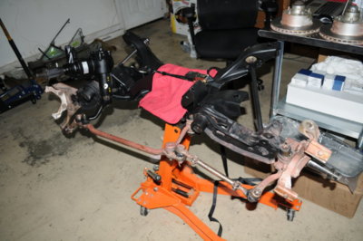

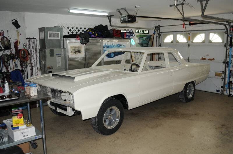

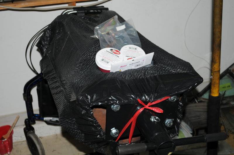

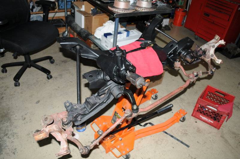

Some pics of the mocked up front end, wheels & tires going on and engine pic (covered up for now – work in progress though).
snook
DSC_8270.JPG DSC_8271.JPG DSC_8274.JPG DSC_8275.JPG DSC_8277.JPG DSC_8278.JPG

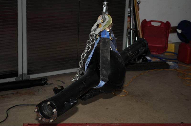

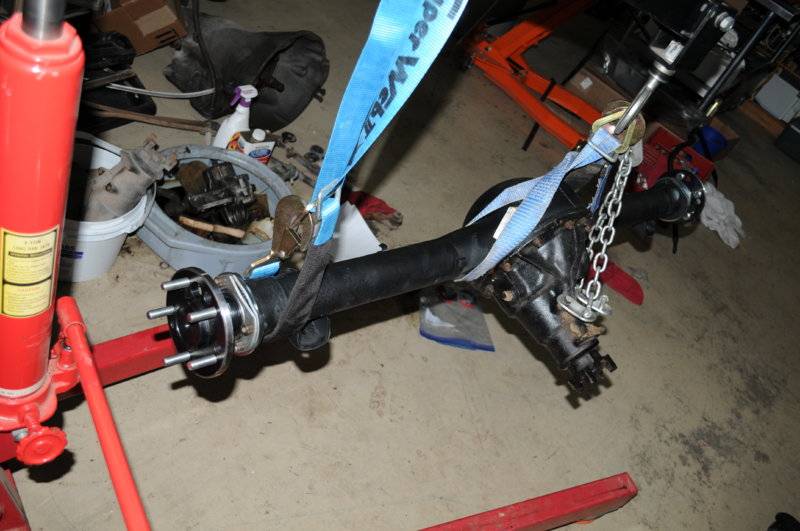

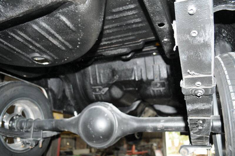

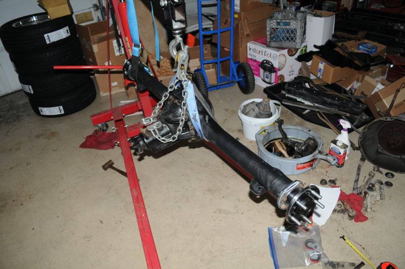

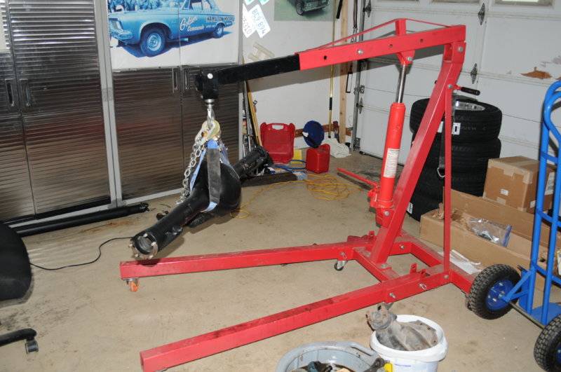

Mocked up front end is complete; correct 8-3/4 66-67 housing is done. These will be installed over the next week and it will be a roller and headed home for the long task of completion.
snook

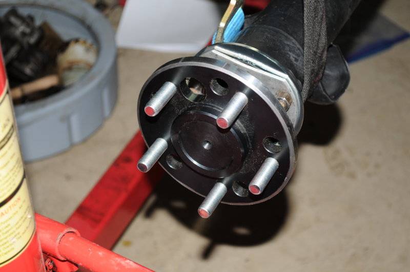

DSC_8261.JPG DSC_8262.JPG DSC_8279.JPG DSC_8280.JPG DSC_8283.JPG DSC_8284.JPG DSC_8286.JPG DSC_8287.JPG
3.91's with a powerlok suregrip and Dr. Diff axles with 2" screw in studs.

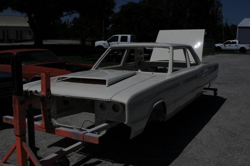

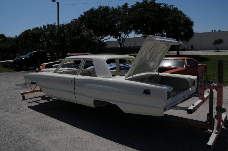

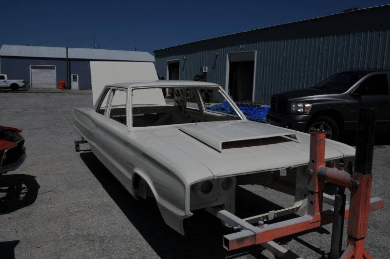

Took the front end, rear end and wheels/tires down to the shop today - 3 trips. They had the Coronet outside baking in the sun, will be there through tomorrow and then it's hammer time. Here's some pics of the car sunbathing on the rotor:
snook

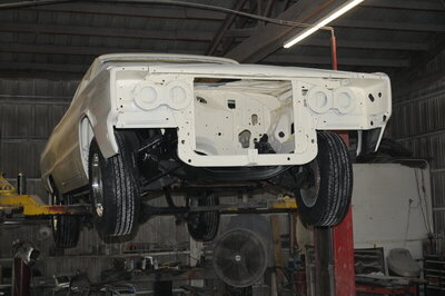

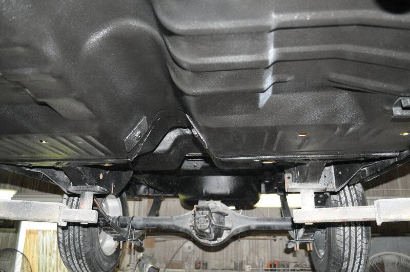

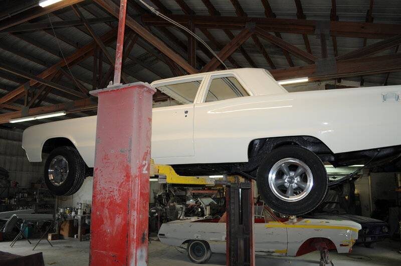

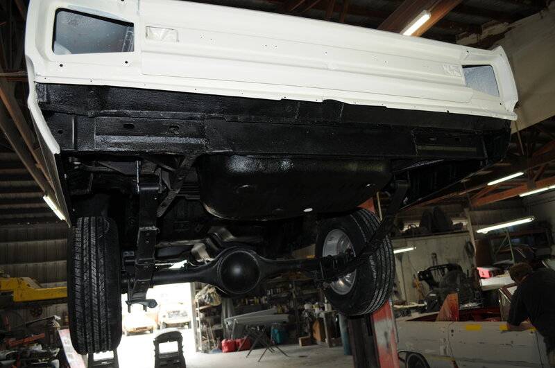

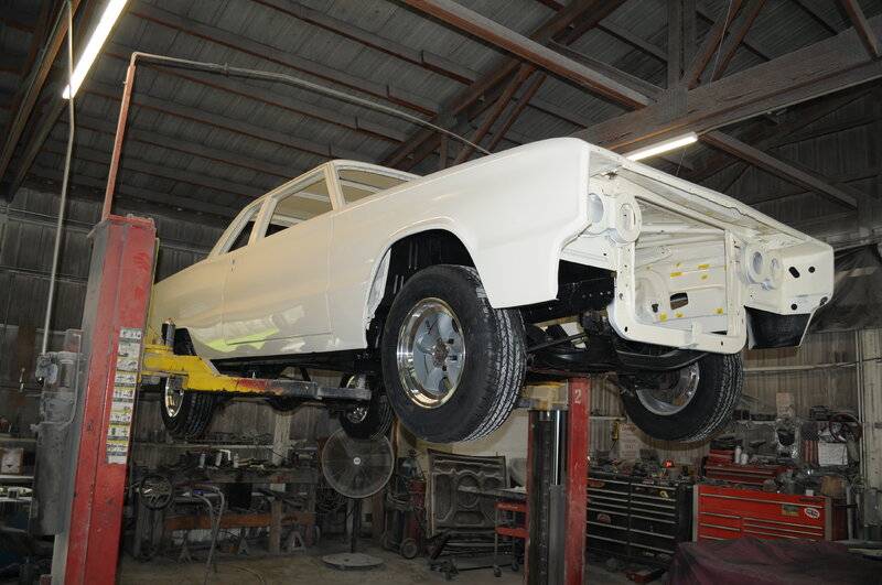

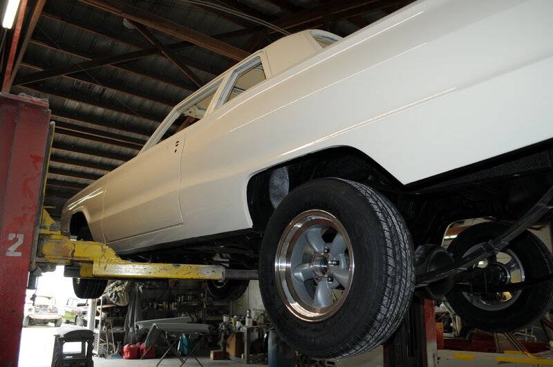

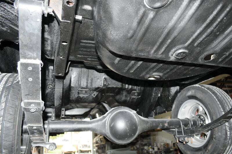

Car is moving right along, the guys are doing a great job. Front and rear ends are in and the wheels/tires are on the car. Some pics...
snook

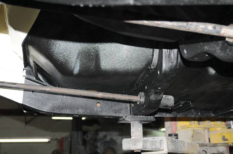

Oh yeah, undercoating is done too. Car should be good for a LONG time now...
