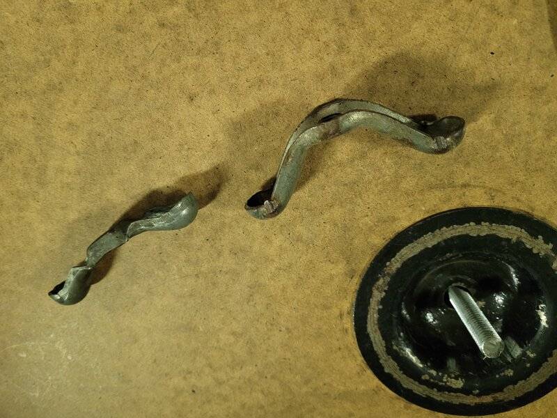

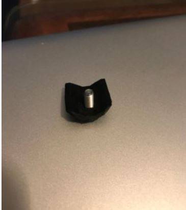

What the OEM clips look like after 40 years of Kansas sun. Maybe this gives you an idea of how to recreate one.
View attachment 1275604 View attachment 1275605
Those are certainly different than what I just ordered as '66 Sat upper door trim clips... in case I pull and break some.

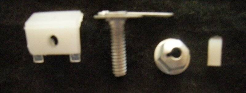

This is a blurry picture but these are what I used. Matched what was on the car. Two little tabs go on bottom side. The metal bolt and sheet metal nut are for the end positions but I’m not sure how true to originals they are.

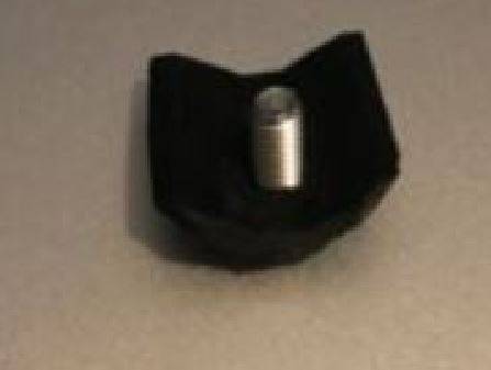

Russ Ty Plymouth's black trim mounts are correct. I you fitted those metal clips to the inside of the trim should work. Turn the tips down to pull trim tight. picture was posted here a couple of years ago by another member, he was looking for some.
Are those just the end clips Fran or do you believe they were used for all the clips, full length? I didn’t find any like that and some of mine had been painted over before. But they may have all been replaced in an earlier life.
Those are for ends but there maybe one piece that uses only one. The opposite side trim doesn't use one either. 10 of them per car, I could be wrong maybe 12.Tried to order them 1980ish none available.

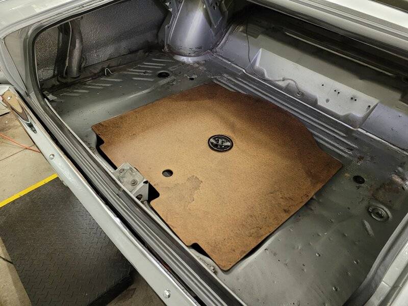

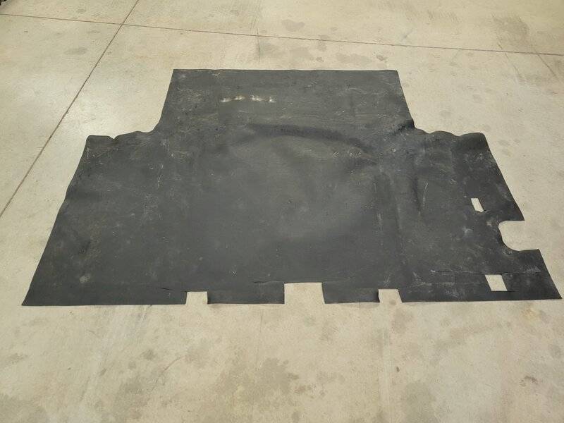

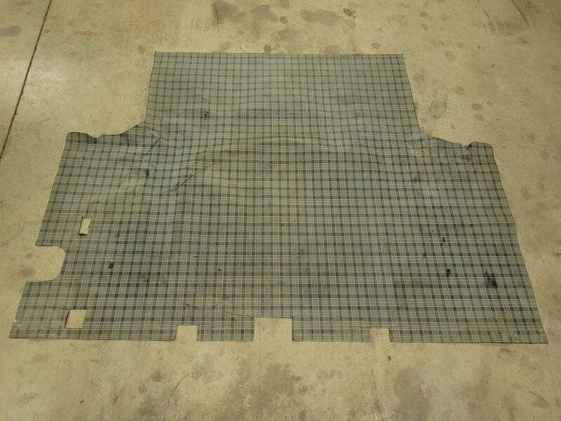

Trunk mat out and considering it's probably original it's in damn good shape with a few tears off the cut outs.
Cover board in nice shape, wing nut incorrect and a homemade threaded rod

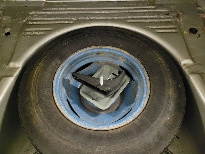

Hook and base are there!

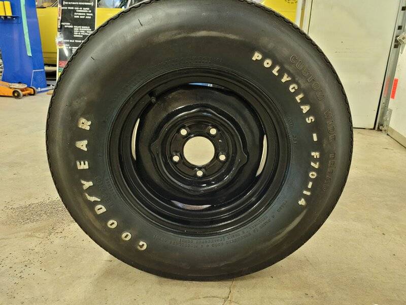

Amazing find. Incorrect tire to be original to the car, but a never used, still nice pliable rubber, Polyglas F70-14 Goodyear.
Date code is 10th week of either '75, '85 or '95. Who knows, but they weren't introduced until 1967.

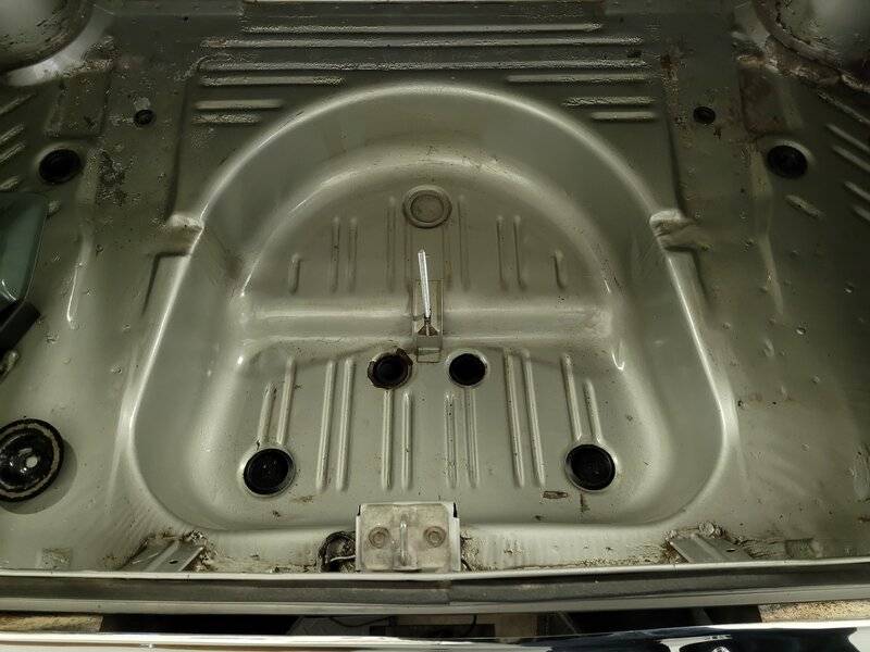

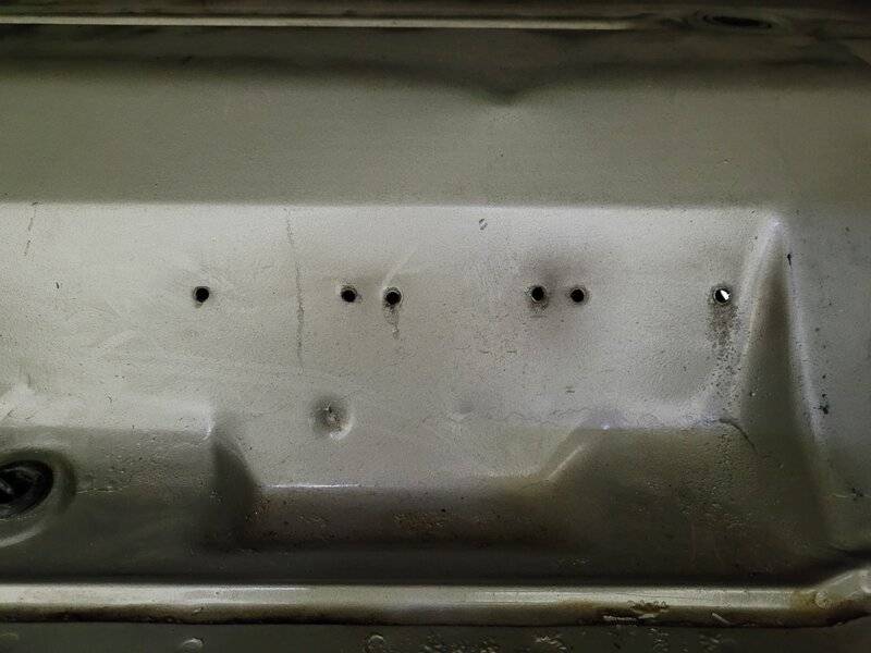

That trunk pan is 100% original. I don't know a shop with a spot welder that will reach or make them perfect welds.

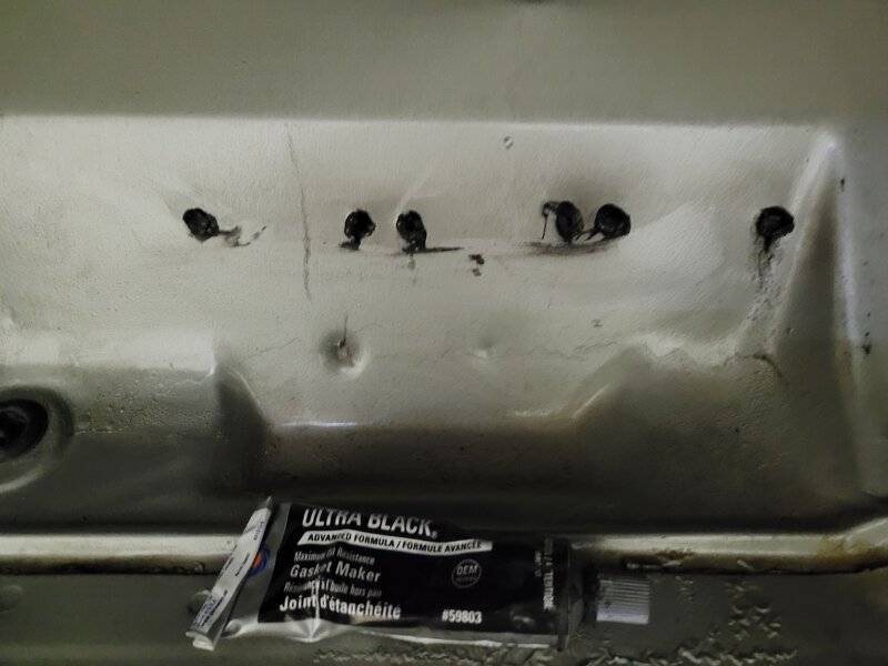

Quick solution to plug them up.

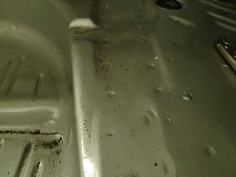

How's that for clean and rust free. It's obviously been painted in there, but on the original clean metal.

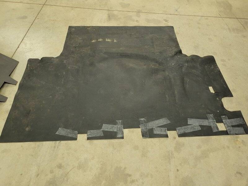

Some heavy duty clear tarp tape on the mat cracks.

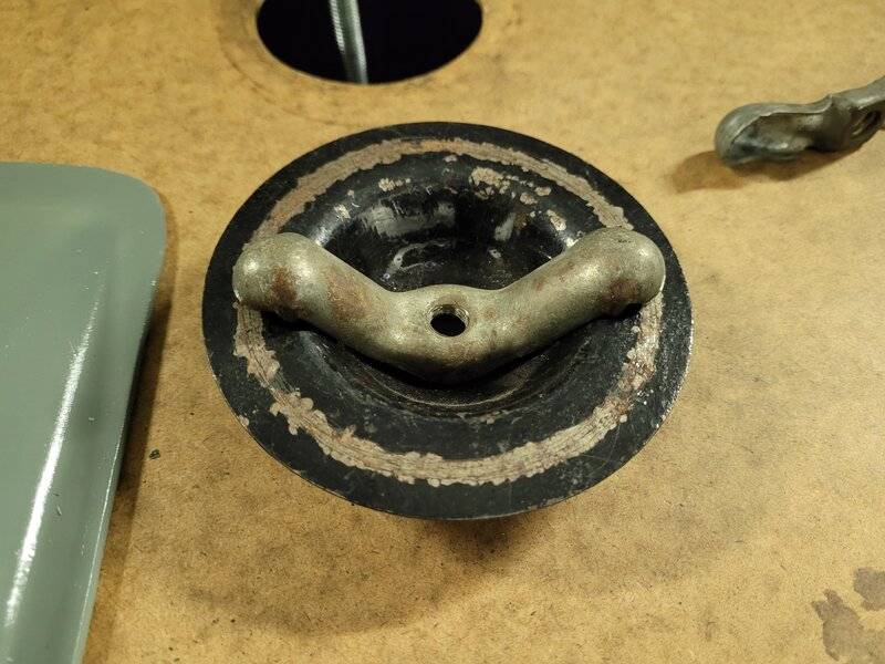

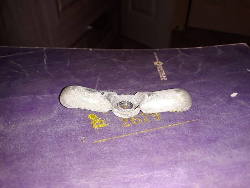

Hook and base are correct for the jack, but the wing nut is wrong.

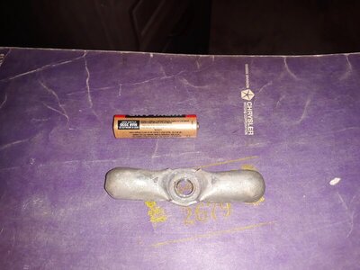

Not sure where I got it, but amazingly I have a correct OE wing nut in my spares. EDIT: I'm thinking that this is wrong. Maybe the flatter one is supposed to be used to hold the jack pieces and tire down, then the hardboard and cup on top, then a small wing nut that fits the confines of the cup.
Now is that's the way it's supposed to fit??? Now I can cut down that homemade retainer rod until I can source the correct one. Or was the flat nut correct to hold everything, then the hardboard cover, cup and a small wing nut??

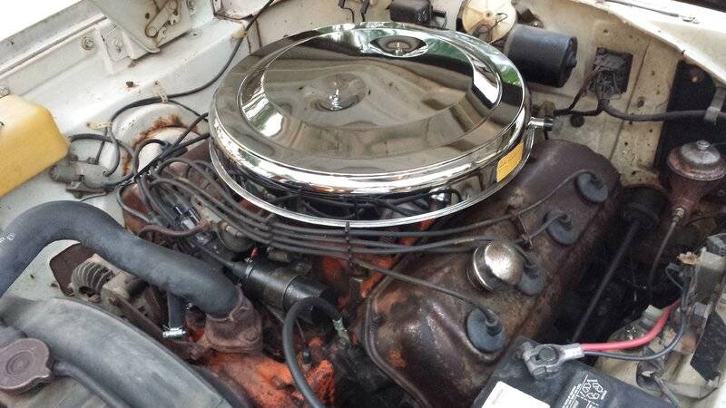

Most 66 Hemi cars Ive seen have the small round chrome breather cap with no nipple. BUT Ive seen a few that just have the small round black breather.
It so then the nipple on the air cleaner has a plastic cap on it
UNLESS
they are CA emissions cars. then they get the hose from the cap to the breather
My nipple is showing in this pic. :D
