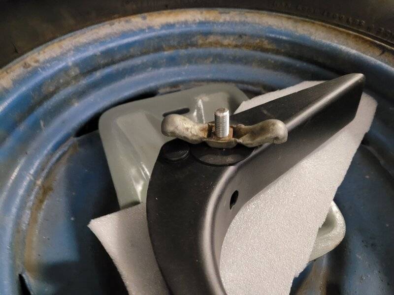

Tire inflated and jack parts back in with some foam to stop the rattles. Turns out the flat wing nut is correct and goes on now!
Then the hardboard and the cup. Then a small wing nut similar to this one. Thought I had it licked, but this aircraft hardware wing nut is fine thread.
The other big wing nut will do for now. I'll come back to the trunk in the Fall and correct all the stuff that's incorrect, paint the cup, etc.

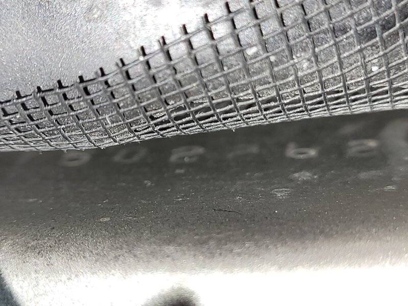

Original trunk mat back in.

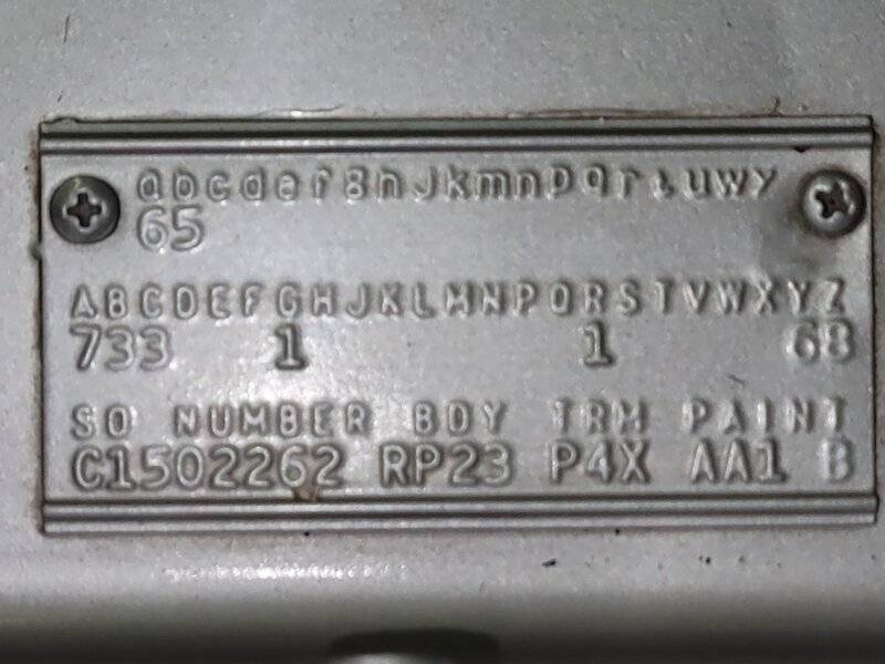

Was a bugger to see and get a shot of, but thought I'd better at least make sure that I didn't buy a re-bodied car and find the hidden stamps! Matching SO Number on the radiator support. 1502262. Looks like I need to remove the rear bumper to find the one back there... and that's not gonna happen.
Fender tag with same SO Number. AB73 = 426 Hemi C3=4 speed Z8- Buffed Paint
I think its AB73 is Hemi
C3 is 4 speed
At least I think thats how its read / coded
Is the back of the original mat smooth vinyl or does it have some sort of flocking on it?

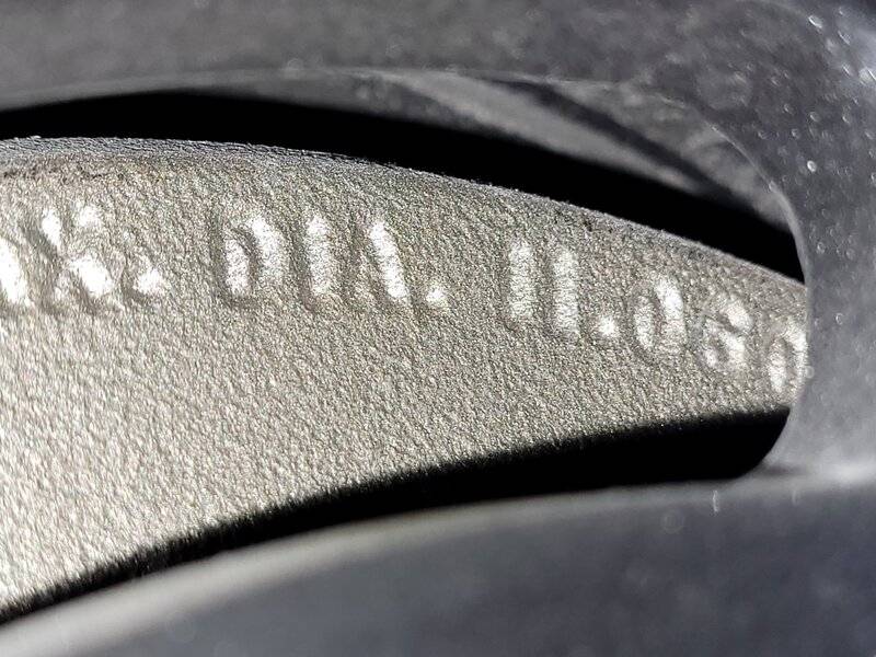

Looking at the photos there are 10x21/2" drums on the front and 11x21/2 on the rear axle?
Also the springs look like stock Hemi/440 with the 2 half plies added for torque bias.
Mopar was always economical (cheap) the thermostat housing the same used on 318 Poly motors.
I have a breather and PCV valve off a 426 wedge car, both are chrome, same for the early Hemis.
I thought my car had 10” brakes on the front from underneath but when I pulled a wheel they were 11-3. My rear drums are the finned type so it was hard to compare up on a lift. Hard to judge by a photo or even just looking at them directly sometimes.

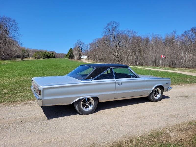

Went to town first thing this morning and noted when coming back that the road was well packed and dust free. Time to get the "new" Satellite out for a shake down cruise... only to go out the gate and find that the grader just chewed up the road.. ffs! Ran the car through it's paces, great oil pressure, temperature doesn't waver off the thermostat (albeit 3*C outside) and she launches straight and stops straight! What more could you ask?! Dropped by my buddy Bruce's place in the Harbour and put 33 miles on the car. Getting closer to rolling that odometer over the 10,000 mile mark!

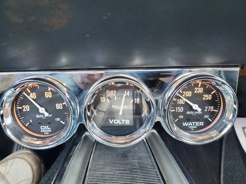

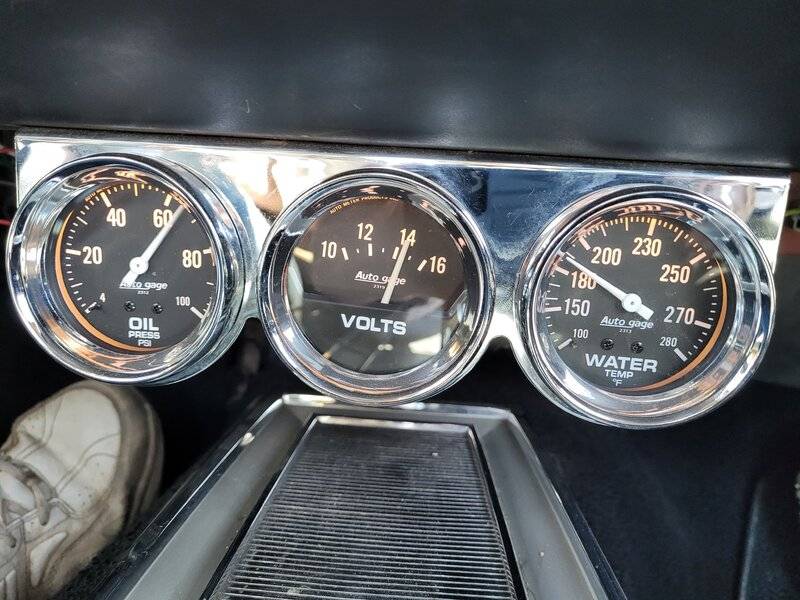

20 minutes in... 65 psi oil and 187F water temperature.

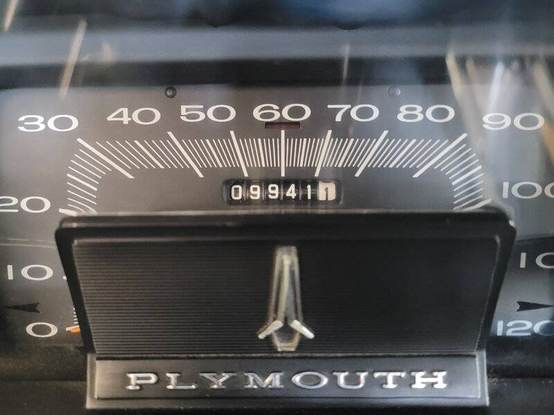

Put 33 miles on her, next cruise she'll be rolling 10,000 original miles
