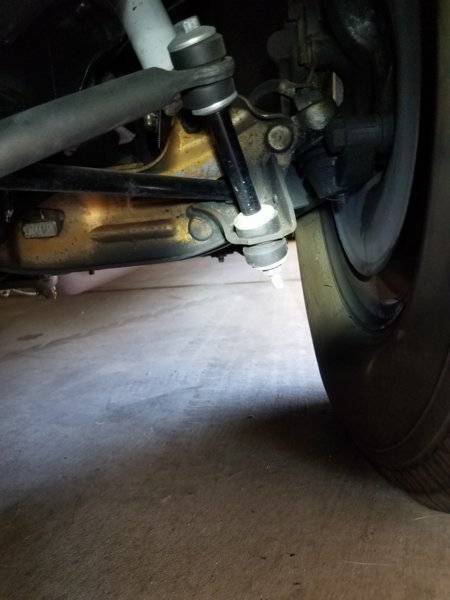

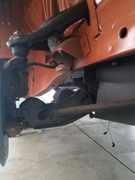

The car did not come with a front or rear sway bars. Like to install, but have no idea on the front sway bar where to connect. I do have one on my 1968 Barracuda and have it mounted to the lower control arm. No mounts on the Satellite control arm or even its that's the mount area.
Picture of the Barracuda and Satellite.
Find a stock B body sway bar 66-69. The K frame is already drilled for the stock mounts. The sway bar tabs for the lower control arms can be bought on Amazon, they weld on to your existing LCA's. The sway bar links can still be bought at a good parts store. PST and others have sway bar kits, but I have found it less expensive to do it this way. While you have your LCA'S out to weld on the tabs is a good time to replace the LCA bushings if they need it.
The front has already been redone before I got the car. Good advise. thx
