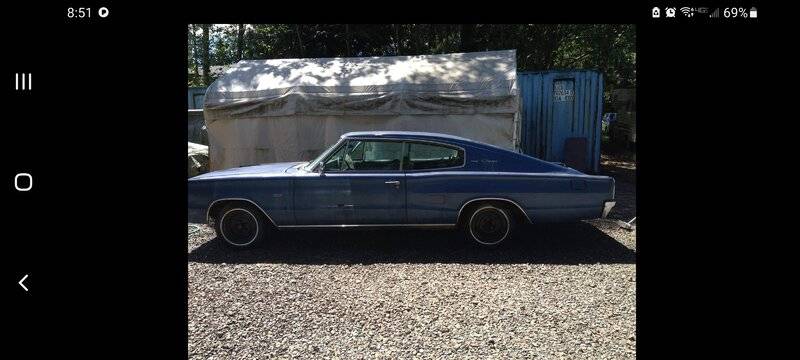

Finally decided to dive into the car after it's been sitting for quite sometime.
I want to stay true to the 383, but the factory block would be going on its 3rd rebuild and I would like something less tired.
I've looked for 383 Mopar crates but have found nothing.
Any recommendations? I would like to keep the cost down
