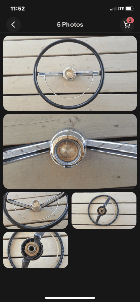

I have a 1966 Dodge Charger and found a nice 1967 Chrysler New Yorker steering wheel and was wondering if anyone knows if it will fit on my 66. Both holes are 3/4

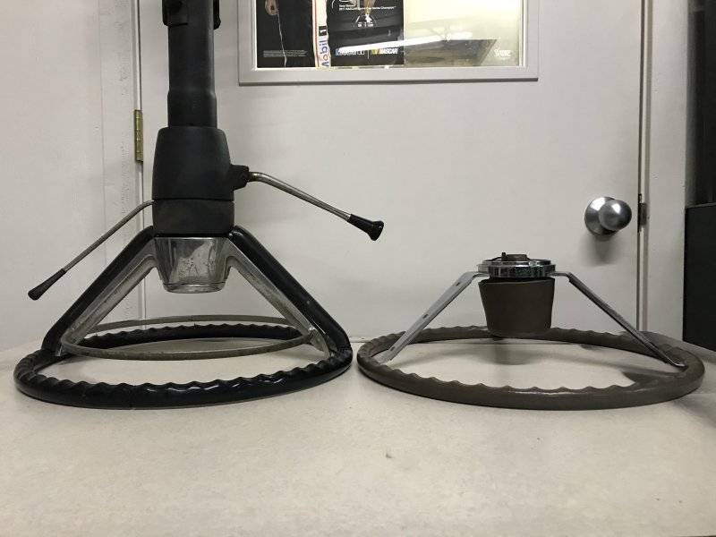

It's possible the splines are the same and it might bolt on, but the dish in the Chrysler wheel is one and a half inches deeper and the diameter at the base near the column is 1/4" bigger that the Charger wheel. IMO it would look and feel out of place.
67 Chrysler wheel on the left, 66 Charger wheel on the right.
