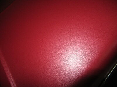

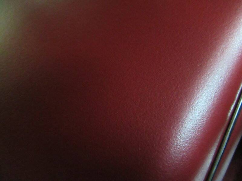

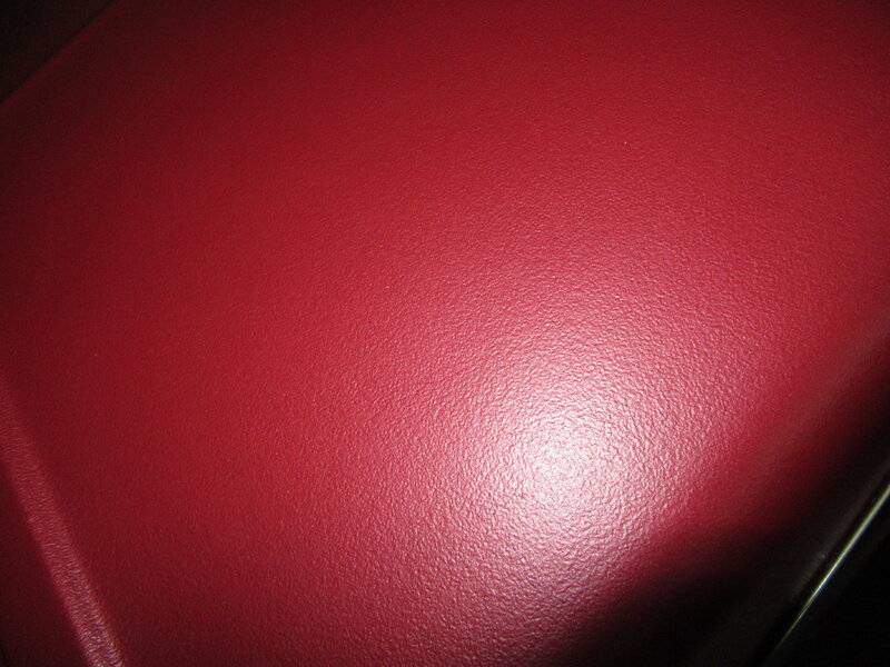

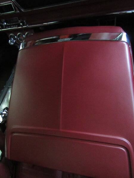

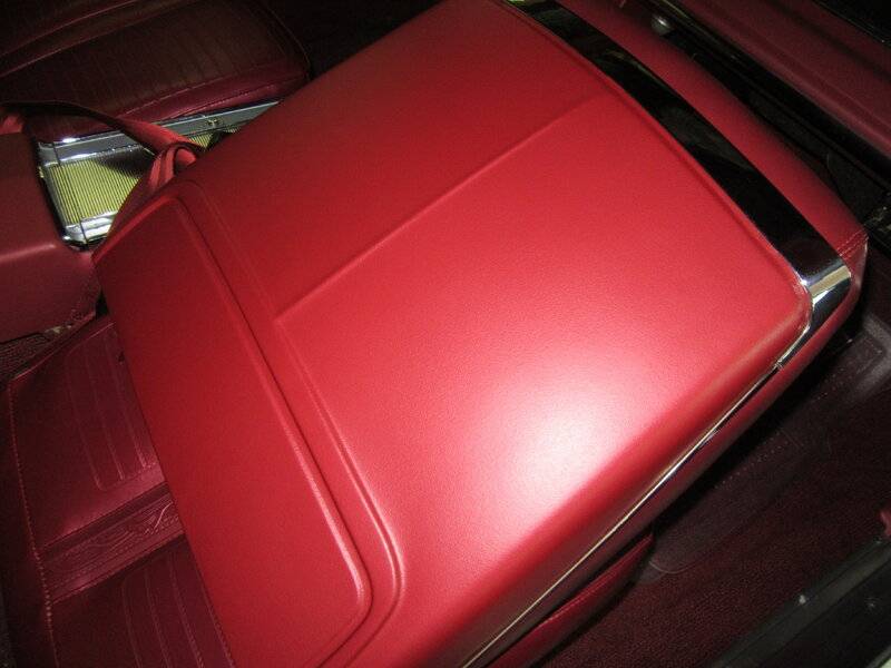

I used a SEM product that is intended to restore a vinyl texture appearance to hard parts. I used it to recondition the seat backs and console in my GTX.
SEM Paints 39853 Texture Coating | JB Tools
You can moderate the size of the pattern texture by the distance you hold the can while applying it. It's best to practice on something first. After I textured I used a small block with some fine sandpaper to lightly go over the top to flatten and level the texture surface slightly which makes it look more OEM. It worked very well although under close examination you will see that the grain texture size is not nearly as uniform as the original molded part. Then I dyed with PPG vinyl paint but if your interior is basic black then SEM vinyl paint is just as good. I put a coat of SEM Clear semi-gloss over it too for additional scuff protection.
I'll take a few pictures and post after bit.

Pictures:
Forgot to add - any deep scrapes or cuts need to be filled and leveled with something first. I think I used JB Weld so it could be sanded and blended.

I can’t provide that as it was custom mixed to match by the PPG dealer and it was literally a little of this and a little of that. I forget what I gave them for a color guide and to dab tests on to check the match - probably a kick panel. I’ve used their flexible interior dye (vinyl paint) on a couple of cars and like it. I spray it with a detail gun usually. It comes ready to spray. Using the semi-flat clear SEM over-coat was kind of a personal thing as I like muted gloss on interior parts. Some might like the normal semi-gloss finish of the vinyl paint better. SEM has a pretty extensive color line of their interior paints but you may need to ask the dealer to see their copy of the color chart. They may have a metallic red or deeper red that is pretty close - not sure.
A paint store may be able to load the vinyl paint in spray cans if you don’t want to mess with a compressor and spray gun.
good luck
