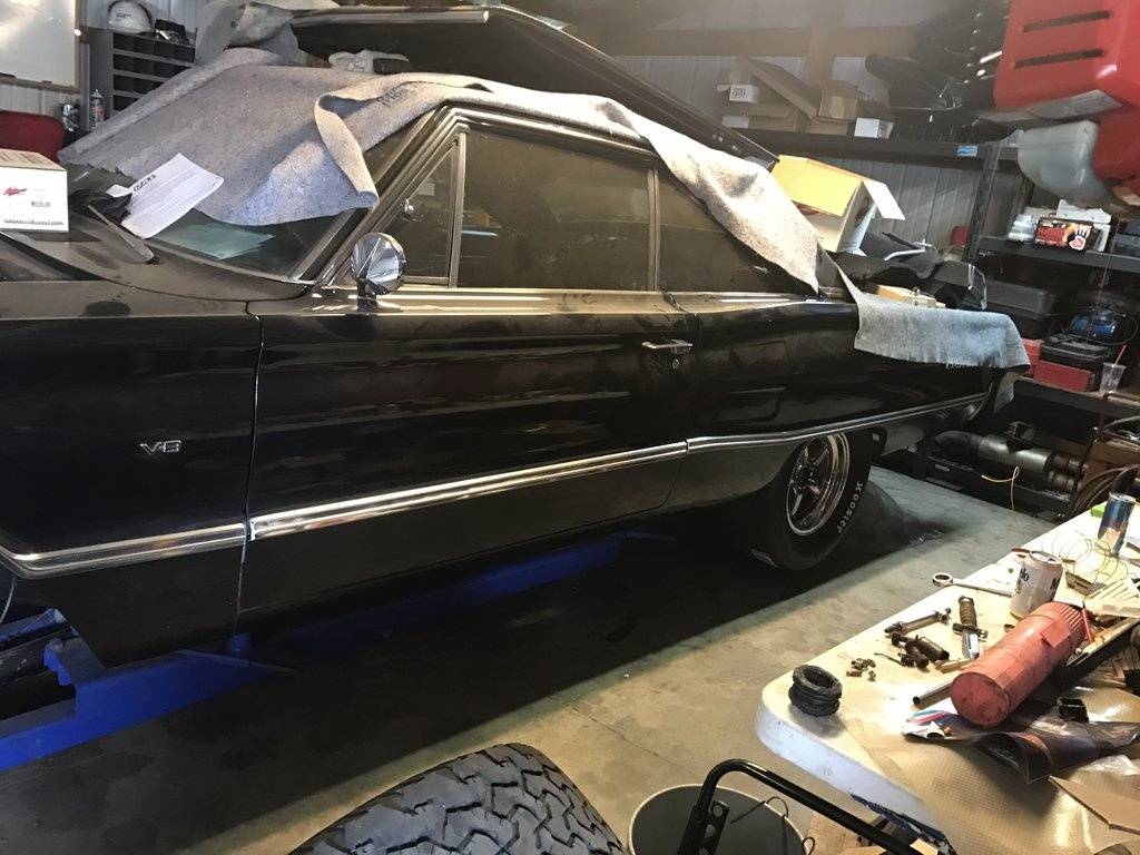

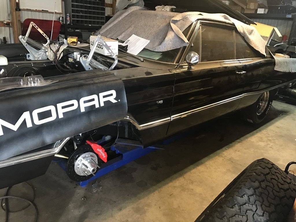

1967 coronet restomod/pro touring build
Here you go @moparnation74
I need to roll it out and wash it and degrease under the k frame but I got this damn k2500 here right now I'm doing a steering gear box and tune up on, been a plow truck it's whole life so every bolt is rusty and giving me problems!

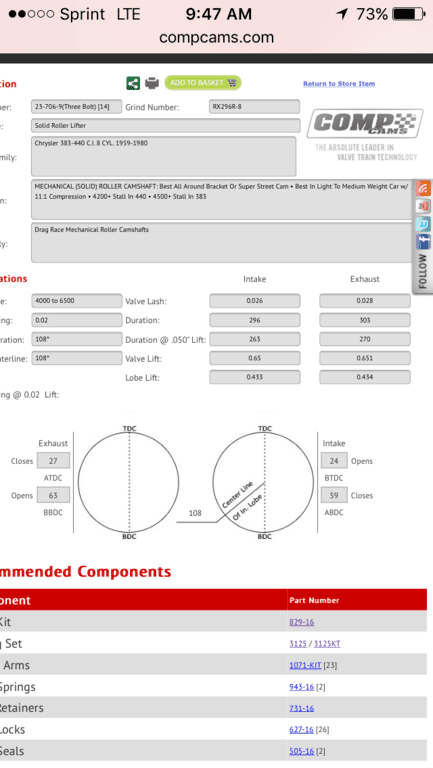

Got the last piece for the motor, fitech 1200 unit. I wanted to use the Holley sniper but the 8 injector version is still a ways out. Don't know if I ever mentioned which cam I'll be using with the victor max wedge headed 505, it's the comp RX296R-8 with the 1.6 t&d rockers, cam specs listed in photo.

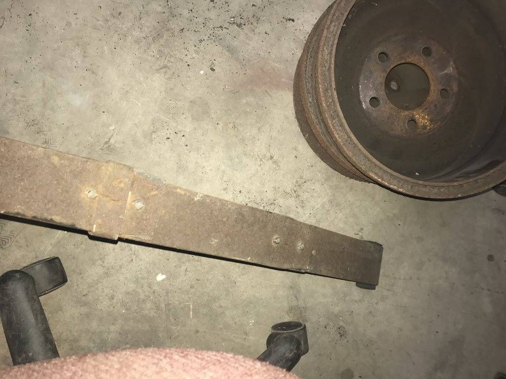

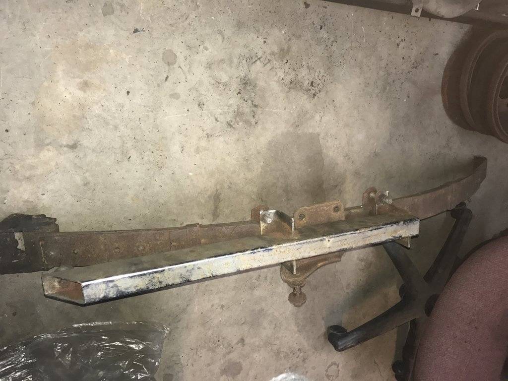

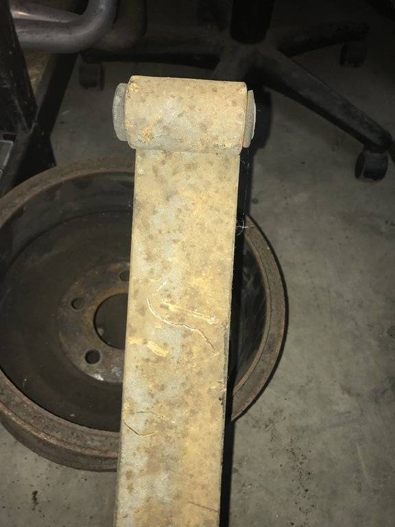

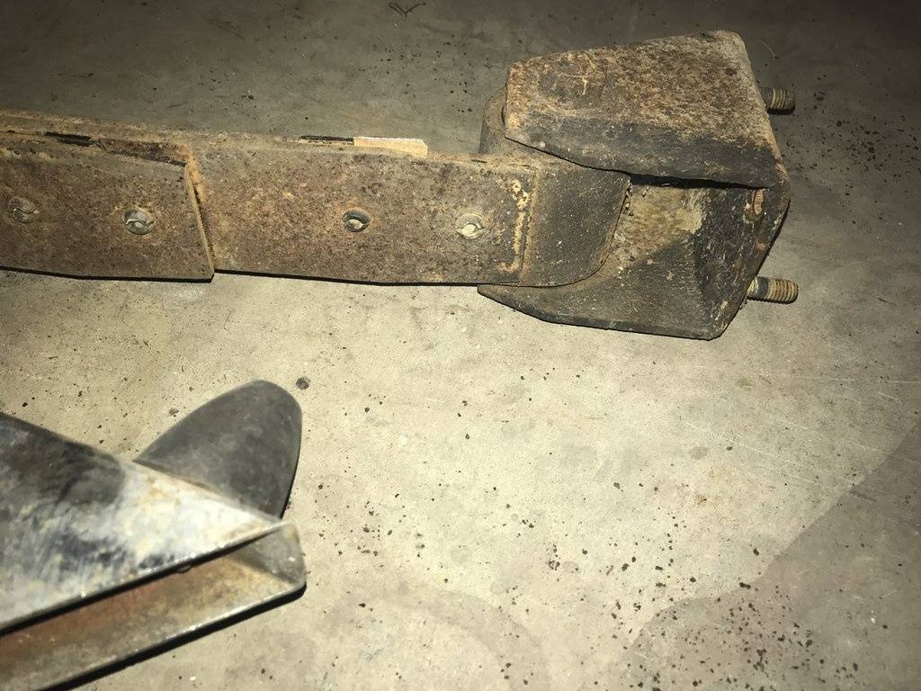

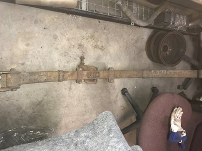

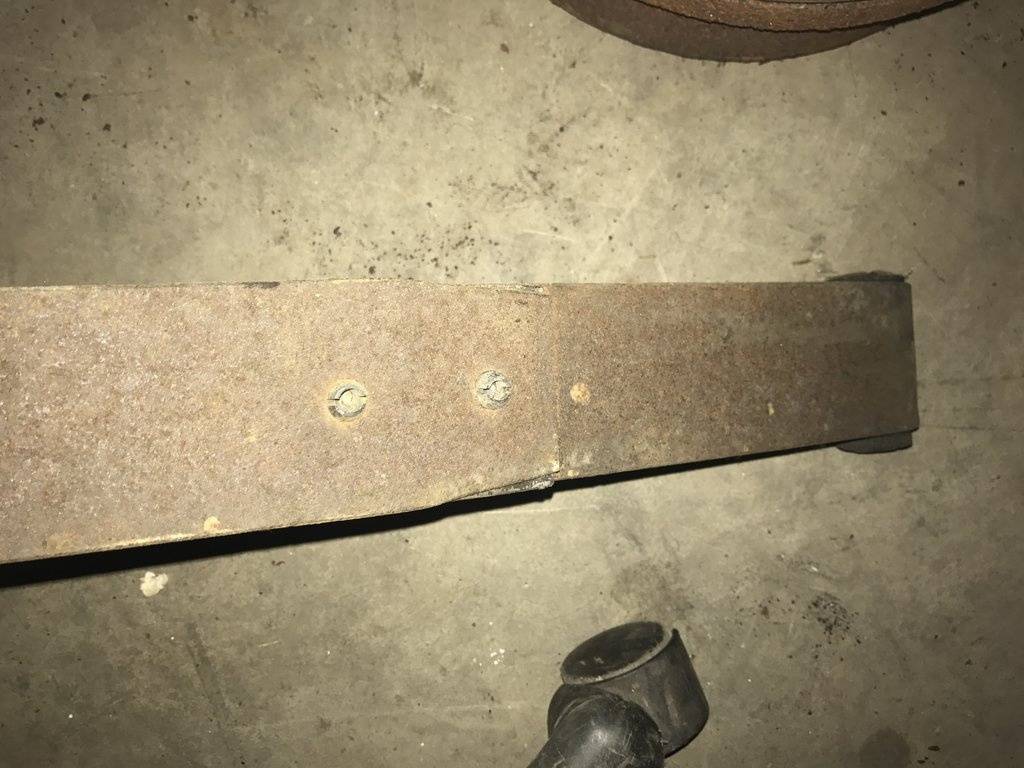

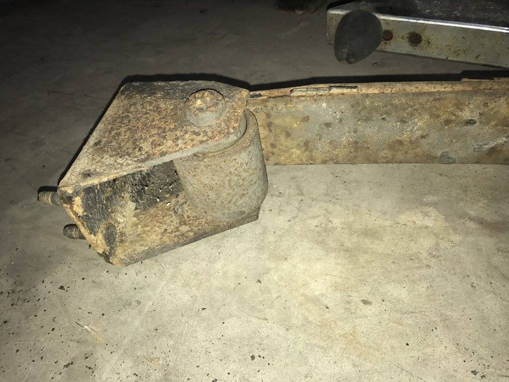

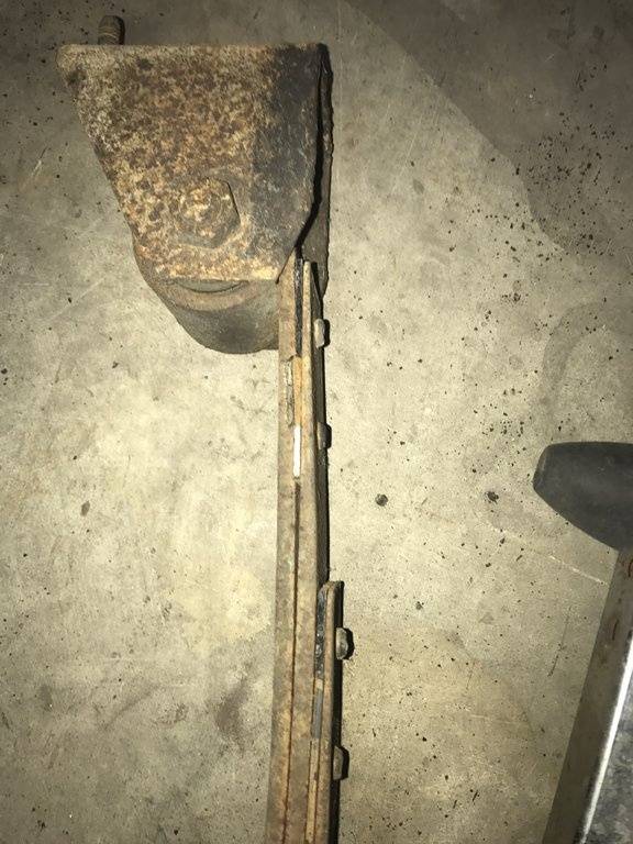

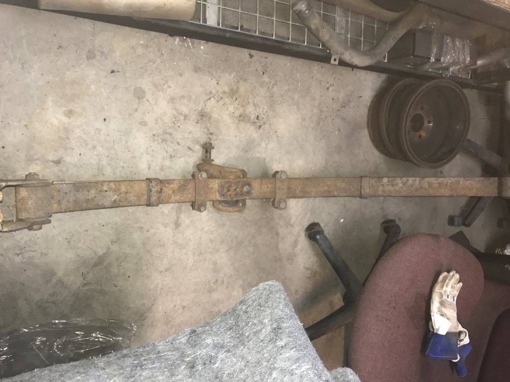

Hey 67, do you know which leafs go where, and which end goes where on the leaf springs? Forgot to take good pics of that before disassembly..lol.:rolleyes:
Not off the top of my head, I can send you some pictures later if that helps
that would be great. The leafs have different shapes on each end and I want to get them stacked correctly.

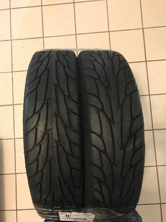

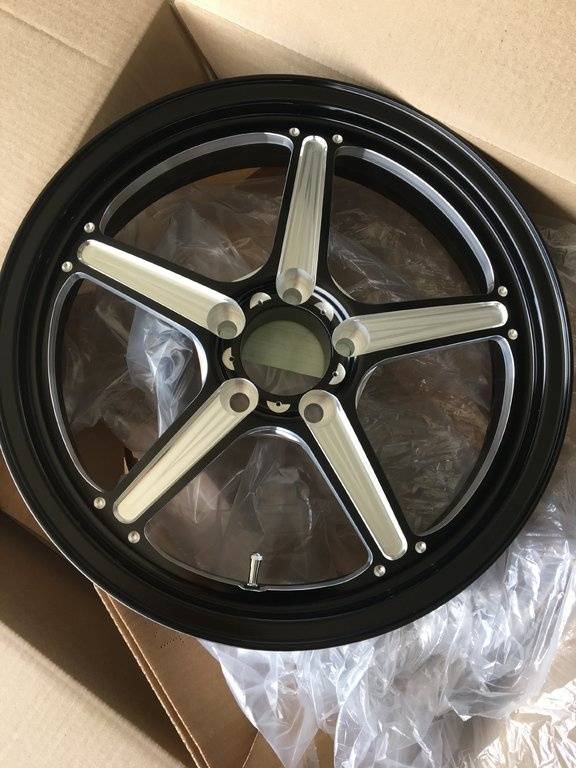

Decided to go with a 17" front wheel so I didn't have to use the spacer, anyone interested in the set of 15's I have them listed for sale $200 under retail.

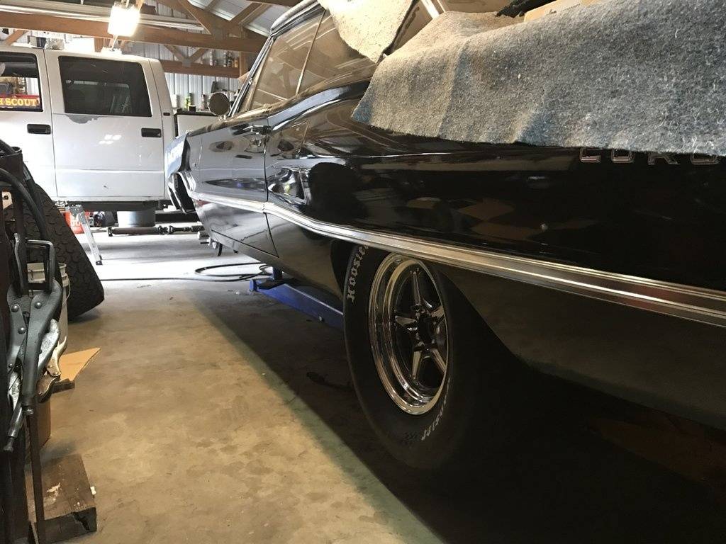

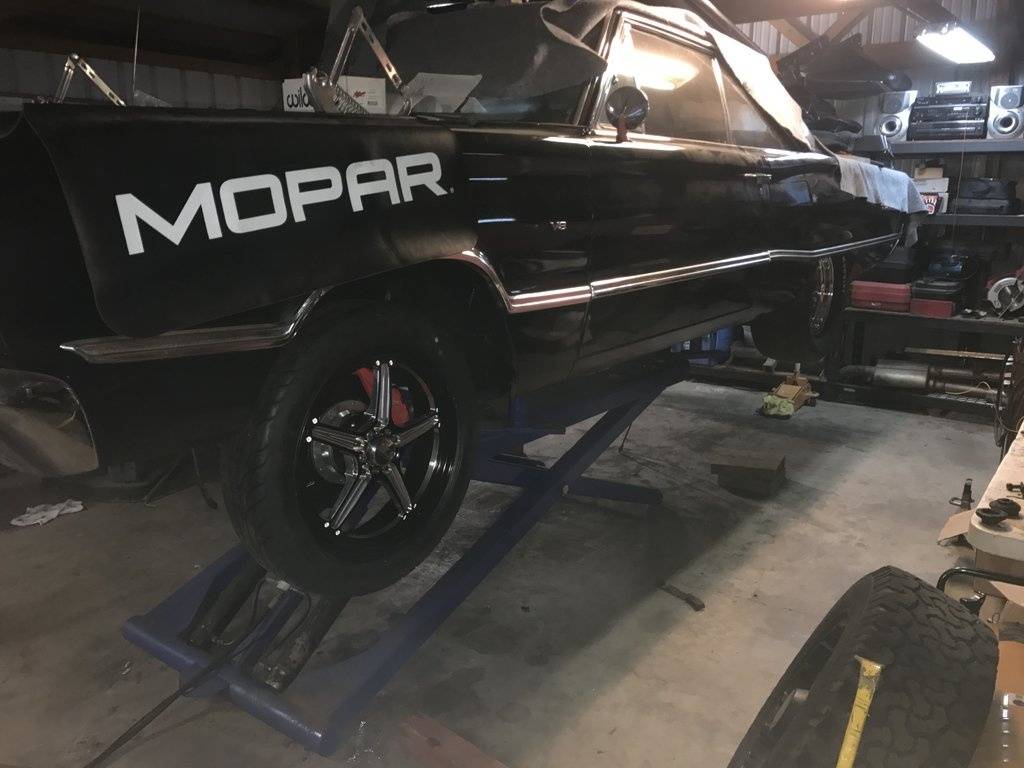

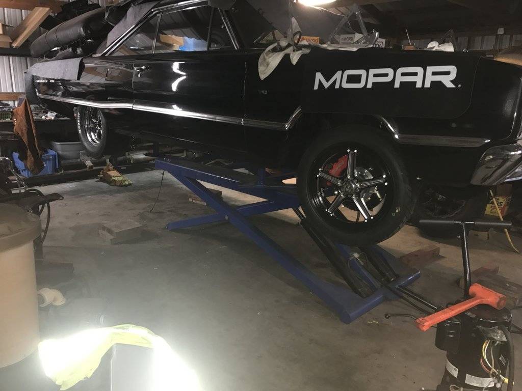

Got a set of 17x4.5 and some 26-6.0-17 Mickey Thompson sportsman sr's for it. Going to get them mounted up today.

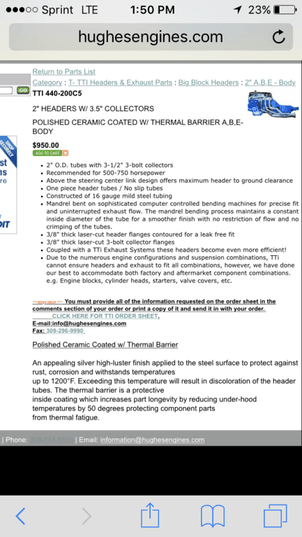

Got the intake back from machining yesterday, ordered my TTI headers from Hughes today, thanks to @malex for the recommendation on the headers for max wedge heads. luckily I already had the money set aside for these or else it would've been sometime before I was able to get them.
