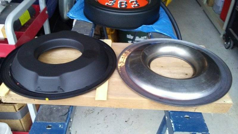

Welll I just figured out I have the wrong base for it. Here you see the base laying inside the cover
Anyone have a base??View attachment 1706830

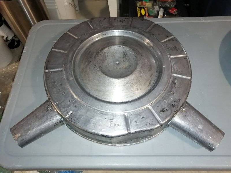

I don't believe that the 68 C Body was identical looking. The C Body lid has a different indentation on the top and would not fit the B Body HP pie tins. The tall one pictured fits the hp pie tin.
In this c bodies post you can see how similar they are. 13 indentations, dual oval snorkels, pie pans, etc. At a glance they look almost identical but they're taller and have a different base plate. I've found a couple of these on my hunt for a real 67 dual snorkel.
The cbodys had a large indent for the hood torsion bars. They're kind of an asshole to get on.

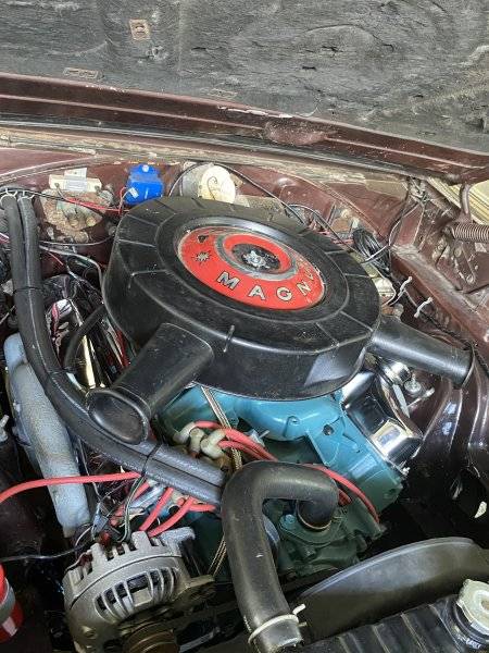

Here’s the one I’m using now. It’s the tall one from your pic in #7 post. Original pie tin to the car, but not the lid.
Thank you!
Looks good. What car are you using it in? I need one for my 67 Coronet but was worried i might not be able to shut the hood due to the extra height.
I have several bases. So the whole thing is a mix and match deal.
Just using the taller lid on the correct base would likely put it into the hood, IMO.

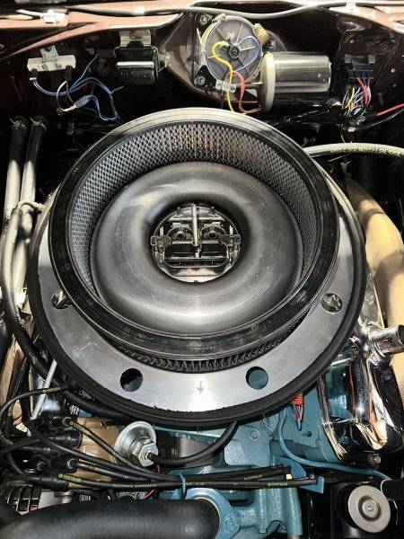

I have the same air cleaner however mine had the trumpets hacked off before I got it. I ditched the factory base as I felt it retained too much heat around the carb. I bought a Mancini drop base, and was able to use a taller filter and still fit under the hood on my Charger.

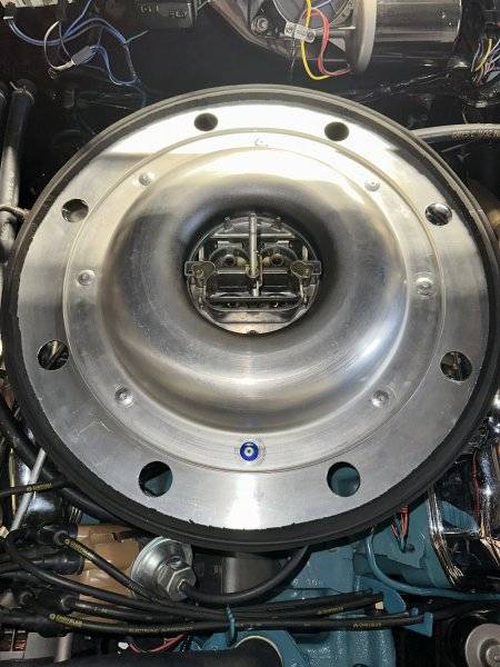

Same. I’m using a similar but different drop base. On mine, the base is a smaller diameter and therefore it does not seal on the lid’s rim.
This is my hybrid silenced, unsilenced drop base. Made by someone in Canada on my car. I added the unsilenced holes. Fits larger neck Edelbrock AVS carbs
