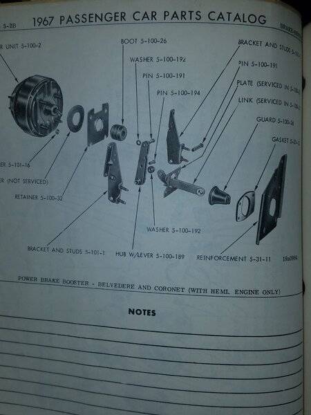

I did a little more research in the parts book and the offset bracket (5-101-1 in the figure) and the 4 spacers that go on the booster studs (5-101-16) are called out as specific to the hemi b-body, but there is only 1 p/n for a power disc brake booster as mentioned in the previous post which makes me wonder whether all of the disc brake cars got the same setup as the hemi. Also makes me wonder what they used on the hemis with power drums, if there was such a thing, since the pwr drum cars used the Midland-Ross style booster which is a larger diameter.Parts book only has 1 listing for b-body disc brake booster, p/n 2881 548 (Bendix dual diaphragm). Indicates its for 8 cyl, but no other distinction. However, the catalog has this graphic for hemi b-body which looks just like the setup on my 383 car.
JusPS the hemi only booster looks similar as non hemi.
BUT, the bolt pattern on the back is different between the 2 and on hemi applications the studs are 3/8? , where as non hemi they were only 5/16"

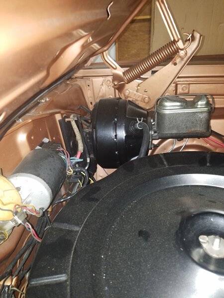

Just went out and measured the bolts on mine. They are 3/8`S. Car was ordered with 440 4 speed and power disc brakes.PS the hemi only booster looks similar as non hemi.

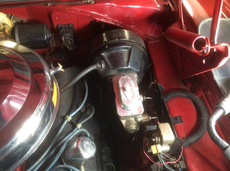

That looks like the correct booster for power discs.
That looks like the booster on my 67 GTX Hemi power disc from the factory. Thanks for the pic.That looks like the correct booster for power discs.
Looks like the one on my Hemi. It came from the factory with power disc.
