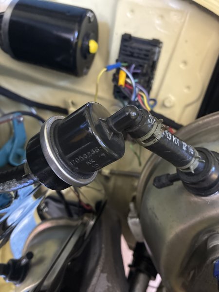

Can anyone tell me what that round canister is coming off my brake booster. And do I need it? Also where does the vacuum line run to. Mine is going to the back of the carb. I believe it should be from the manifold? Can anyone verify? Many thanks as always.
Looks like the GM guys have been under the hood. It's a filter from the chevys. Not needed. Vacuum comes from the manifold

Just needs a manifold vacuum source. It can come from the intake runner or the carb base, won't matter.
Yes a GM type filter. Wont hurt to have it.

From the Corvette forum
It keeps your diaphragm from being damaged by contaminants which may otherwise (somehow) migrate into the booster.
I agree with the Mopar guys here, get that chev junk off your car.
