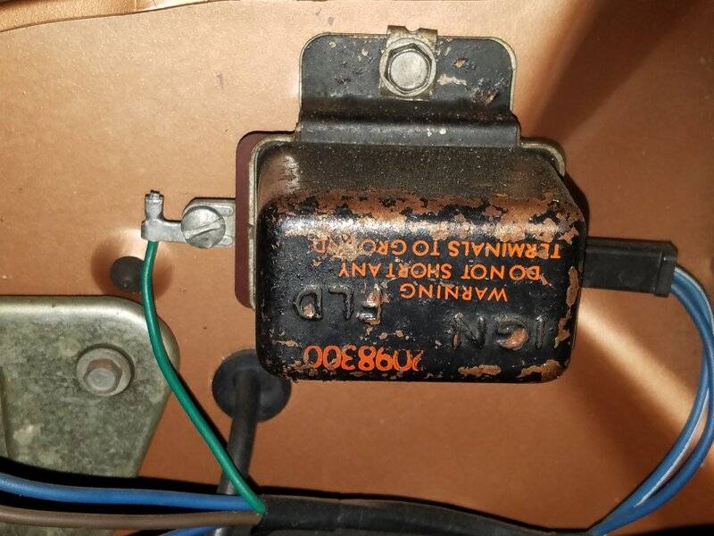

Here’s the one that was on my other 67. Later service replacement. I put the cover on a new VR. Flipped for your viewing pleasure.

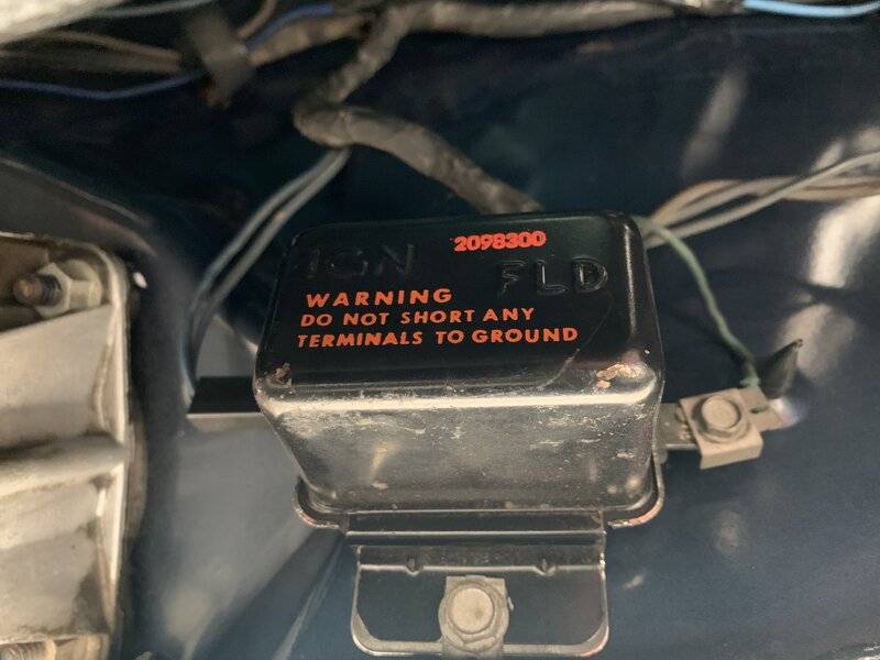

This one was on my 67 Satellite when I bought it 33 yrs ago, and still is. I've tried replacing it with new ones, but the ammeter starts dancing like a drunk gypsy until I put this one back. Hope it never goes bad lol.
so i assume this is when we discuss the correct color ink or paint to use that is closest to factory specs? And while we are all here can you tell me why i see some VR with a date stamp and others without.
The one I posted in #24 would have been a later service replacement. Later replacement ones don’t have dates from what I can tell.

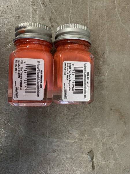

I just picked up two things of Testors paint today. One is orange and the other a slightly darker orange. We’ll compare.

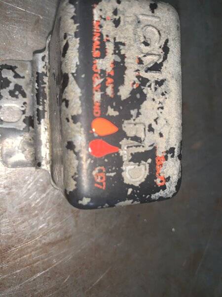

I did more EvapoRust and it took most of the paint away.
I got two colors, gloss orange and flat grapefruit. I I’ll be using the grapefruit, orange is too bright. With and without flash.

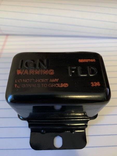

Stamp came today. Talk about fast. They did not add the underscore. The left side turned out okay. I need to work on technique, either that or the stamps originally were very bold font.
My part number and date code font is too small also.
its not bad but i do agree that the date and part number should be a little bigger and the underscore should be there.What are you going to do now?
Update. I called the stamp place and they’re re-doing it. Standby.
It’s better. I’ll post pictures later.
