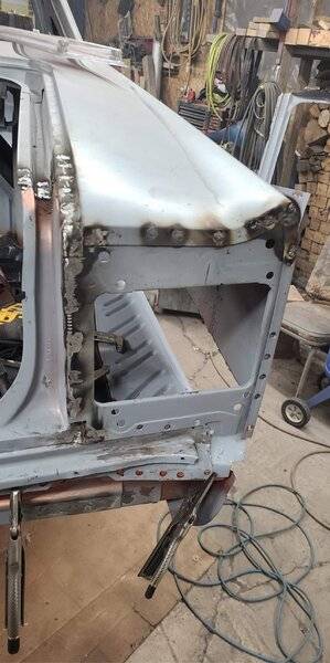

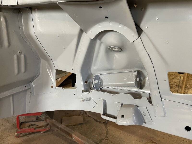

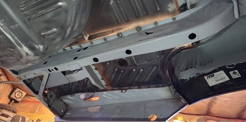

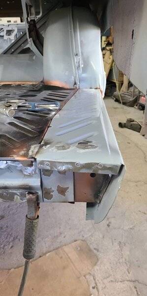

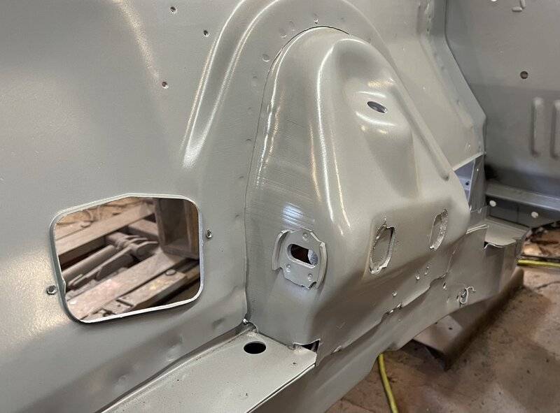

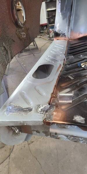

Looking good, be sure the taillight housings are fitted before final welding, they can be a pain.
Top of the extensions are original- sides are from Joe Phillips Restorations
Thank you. How did you get in touch with him?
How did they fit with the 1/4? Are you using AMD 1/4 or his?
I am using his quarters. The drops were close but not perfect dimensions. We had the originals off my car so we sent him the exact measurements and he was going to correct the drops moving forward
Thanks for doing that. Hopefully I can get a set from him. Did you go with full quarters or partials?

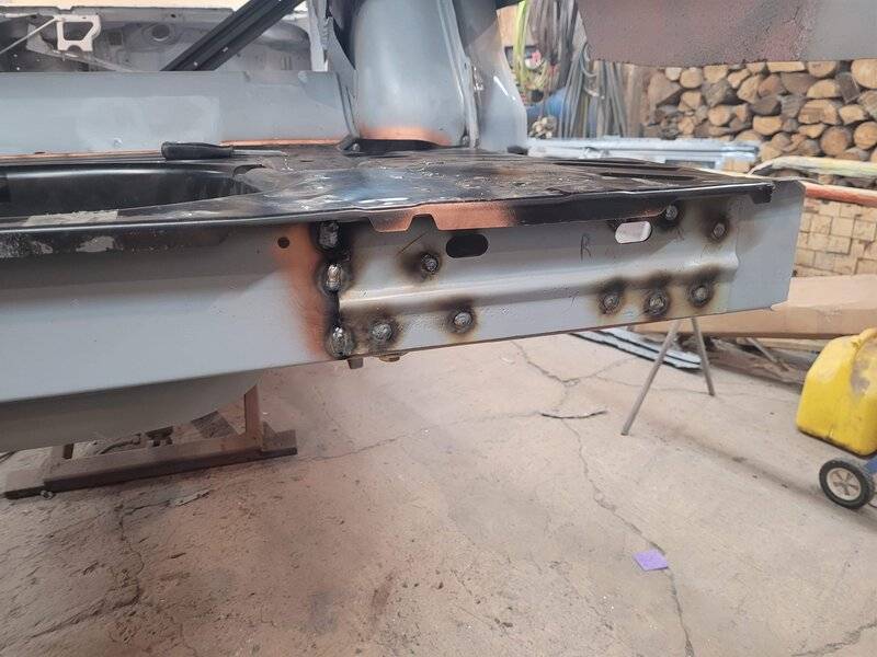

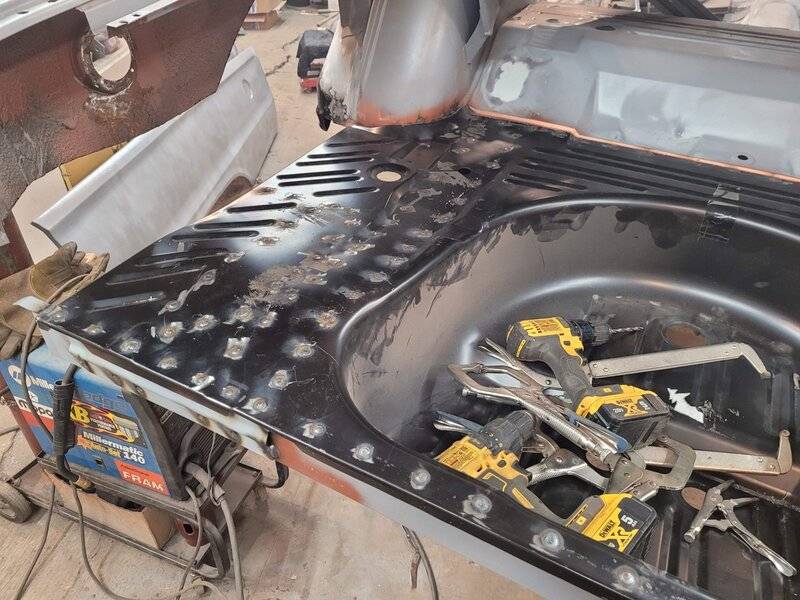

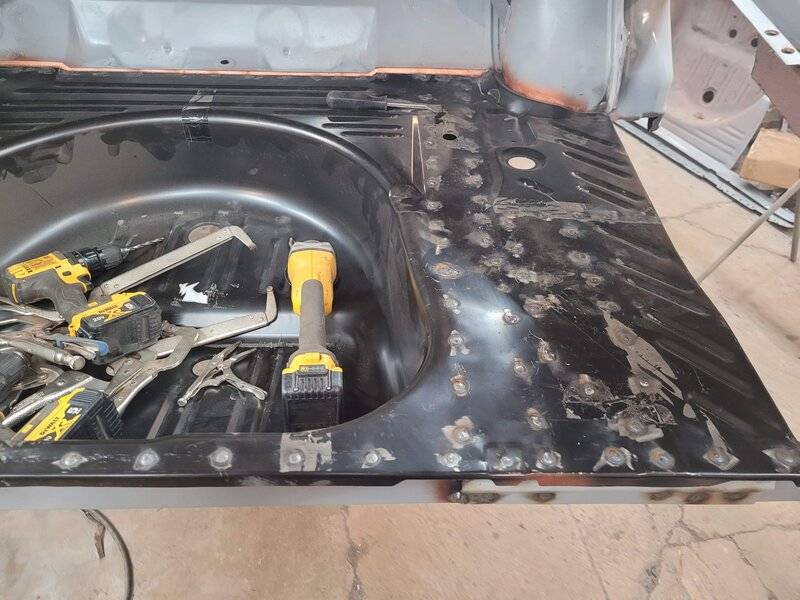

Back end metal work is done. We are going to try and replicate the factory style paint as much as we can- paint the “dip” colour first, the over spray with primer and eventually body colour in the correct spots and pattern. E466ED09-7941-4B88-B007-D256AB43825F.jpeg
