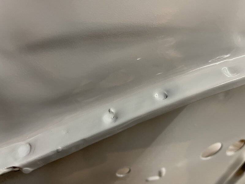

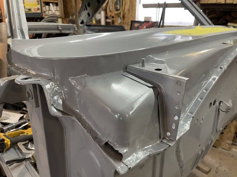

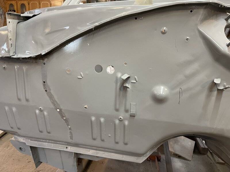

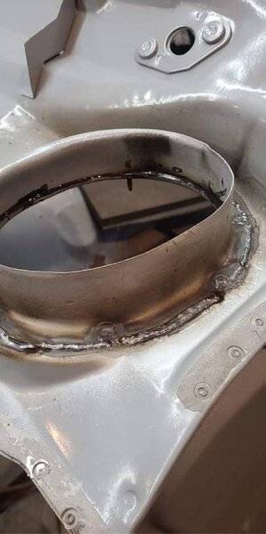

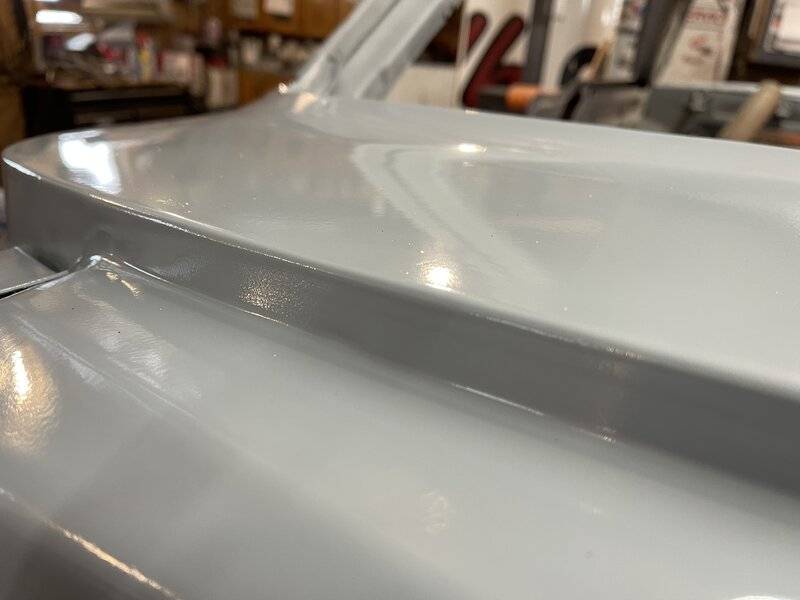

Time to fix the parts cowl top- a few little holes that need to be welded up. Put it on the GTX and cowl top fits like a glove.
hemidart1
9:06 PM
Aug 4, 2011
594
798
Moncton, NB

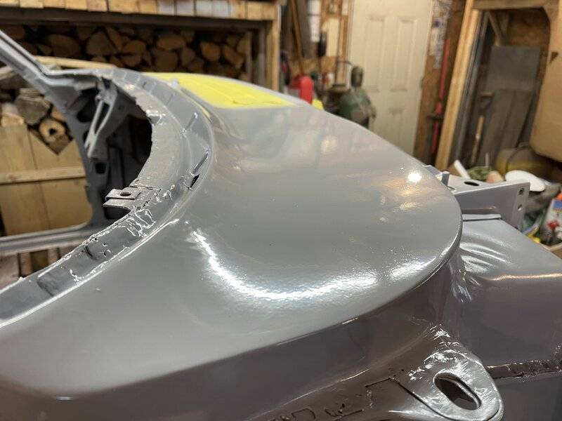

A little paint so when it is finally welded you won’t see any primer through the vents
hemidart1
9:06 PM
Aug 4, 2011
594
798
Moncton, NB
Cowl done. Spot welds back in place. Just needs some sealer on the sides once the inner fenders go back on. Big Dave McGraw (my body guy) is good at what he does.

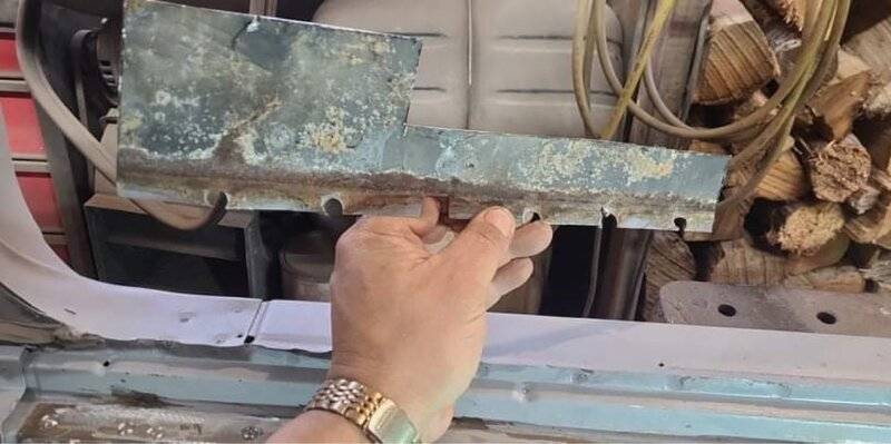

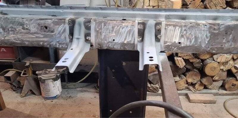

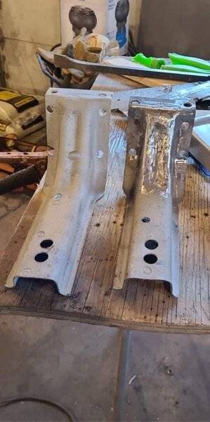

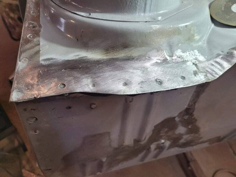

One of the spring perches had scab- so grabbed the rust free one from the parts car. Cut the torque box off the old spring perch mount.
Then cleaned up the torque box and test fitted it and now ready to epoxy and spot weld back in place.
