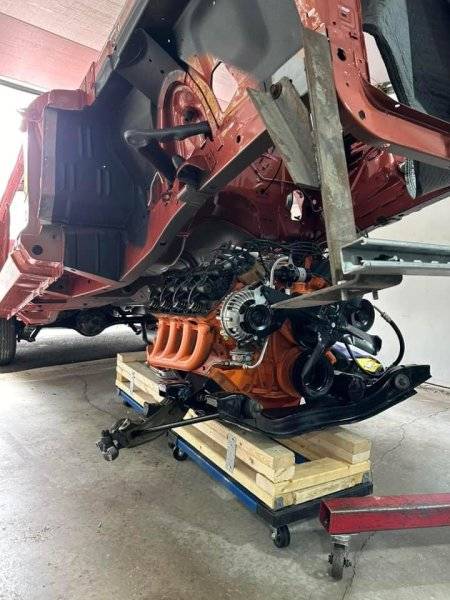

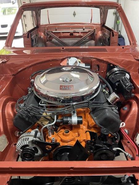

Badass! Looks great sittin in between that turbine bronze. Did you have any issues?
No issues ! The guide rods that we had threaded into the frame helped alot

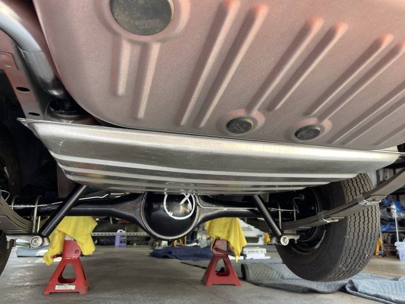

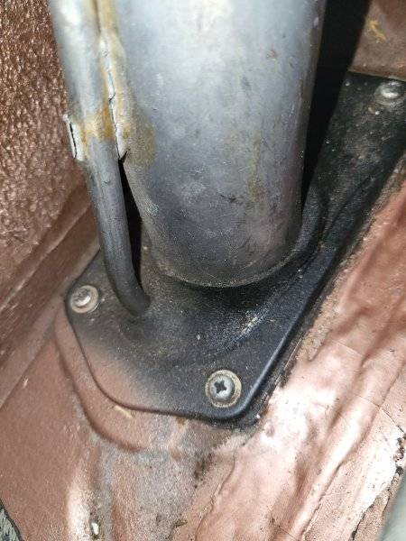

Gas tank in- definitely a two man job. Still need to get the proper screws for the filler neck to trunk floor

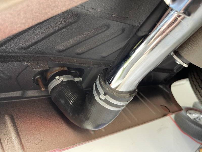

Nice job. I will say that the double straps on the fuel hoses are not factory. From the factory there were only single straps at each location. They were placed carefully after the ridges in the filler pipes and vent tubes. Today the straps are a little narrower so the double straps might be needed.
Appreciate the help! Hoping to have this car done for next summer and hit the road to Carlisle and have some fun

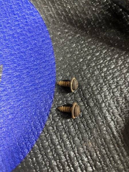

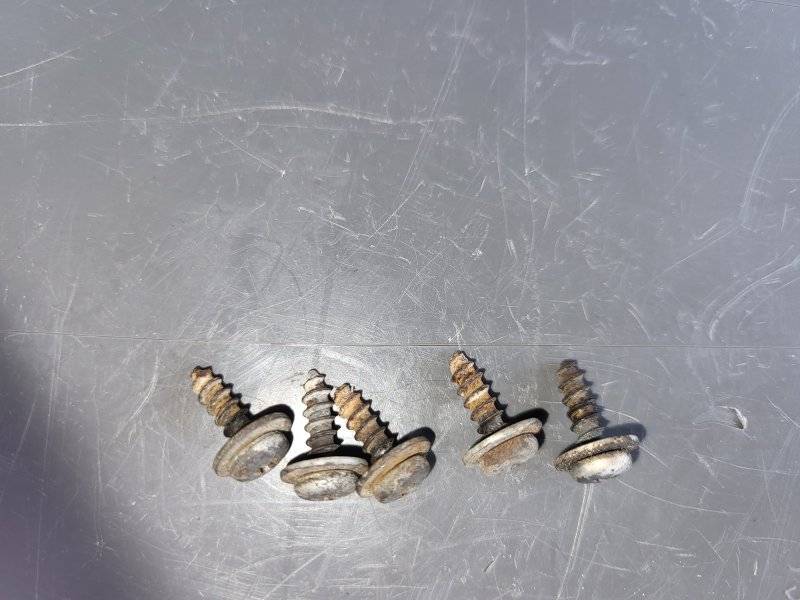

Pretty sure I found the right ones. I pulled the one on the right out of my Satellite to use for comparison. PM your address so I can figure out the best way to send them.

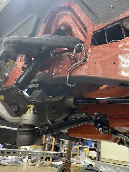

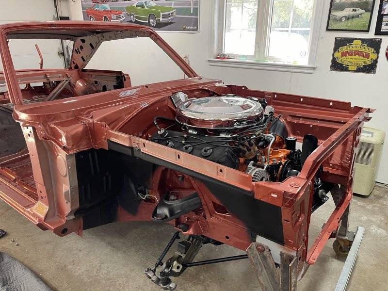

Front suspension in and working to add some details (inspection dabs)
Trying to make this as correct as I can- and I realize some small things may not be right colour or shade of cast etc.
