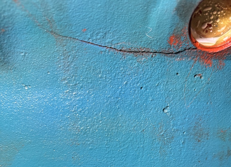

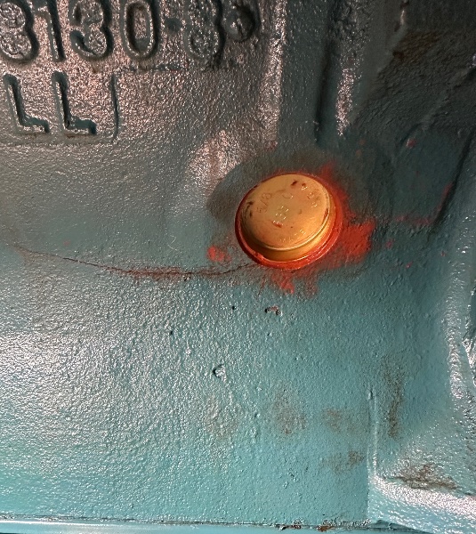

Engine is out and as far as I know there were no previous leaks, but I did not drive it that much before beginning restoration. The engine was rebuilt before I got it and certainly seems to be in good condition otherwise.
Had not noticed this until I replaced freeze plugs, and after the plug was removed evidently it seemed to be obvious, or maybe got worse at that point. Engine had been painted previously so it was not noticeable. Noticed it right after I had installed the new freeze plug.

That is absolutely how to fix it. My metallurgists consider this repair the best cast iron repair hands down. Done properly, can be considered as good as new.
Also looks like you have another small crack at about the 7 o'clock position.
My buddy had a '35 Nash that had a foot ling freeze crack that was repaired 70+ years ago with a brass plate, a homemade gasket and about 30 machines screws tapped into the block... never leaked.
One of the first big trucks I drove with a NH220 Cummins engine had a rod break thru the block. My boss fixed it with fibeglass and Black Magic bondo... ran 3,000 miles per week fir years.
I still have a 440 I rebuilt in the early 80s. I found a similar crack in it. I veed out the crack with a grinder and filled it with JB Weld. I hasn't leaked in decades now.
Mike
Lock and stitch is what I would try. And it's something you could do right in your garage. There are a bunch of videos on it on line.

Get the lock and stitch setup and give it a go. It’s already cracked and it isn’t going to heal on its own. If it works great! If not then go from there.
That’s what I’d do.
Yeah, I missed that. Myself, I’d still get a replacement block and move my parts over. Save the original block and pickle it.
That an easy repair I wouldn't spend the $$$ on another build. Drill it, pin it and weld it. It doesn't even seem to even be leaking right now.

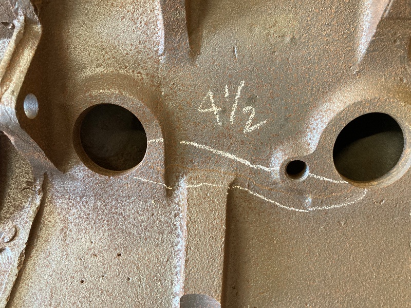

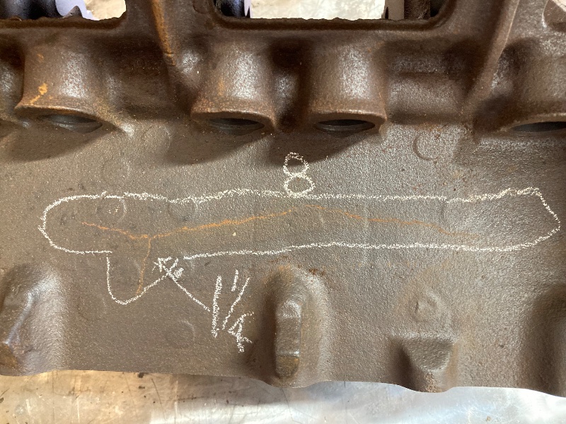

I would pull the intake and check between the lifter valley for checks. I’ve got a 426 street wedge block that had a crack like that and it’s cracked inside also.
Thanks. I’ve had it off and did not notice anything, but was not looking either.
